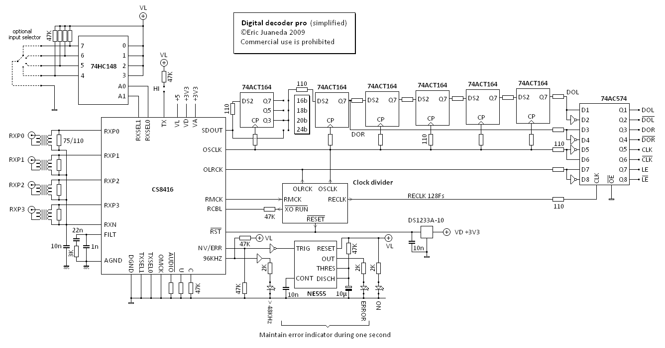

@Tam Lin If we use shift register which propagation delay is longer as hold time in DAC, then everything will be fine? The HCT meets this requirement ... AHCT was also tested and it worked (and it should not because shift’s Tpd < dac’s Th)

Many of the favored NOS DAC chips have setup and hold times of 10ns or more. Many of the favored shift registers have propagation delays of 5ns or less. The two don’t work together because you end up with the input to the DAC chip changing during the DAC’s hold time. In the extreme you have a PCM1702 with a 15ns hold time and an AHCT164 with a typical prop delay of 3.4ns.
You may ask, why use AHCT when HCT will do the job? For most diyAudiophiles faster is always better and there are many applications where HC logic is too slow. It's best to avoid I2S and shift registers, altogether.

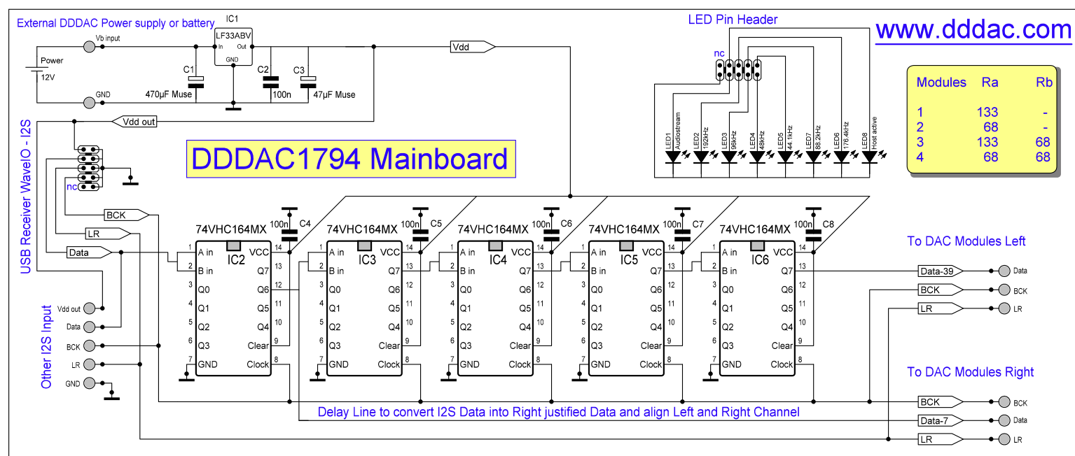

Does the input signal should be time delayed, slowed, before or after the register before inputing the dac chip then ? So few milli second, could it be made by smd coils in a pass band hardware conf?Not true. The shifters will have no effect on the sound provided the circuit is designed correctly. In your case, the circuit is clearly broken. That should have been obvious to any one who saw the schematic and knew how DACs operate. Of course, this is diyAudio where no one looks at a datasheet except to copy the pin-out diagram.
The problem is, at the rising edge of BCK the DAC latches the next data bit and shifts it into the sample register. At the same time, the rising edge of BCK tells the I2C shifter to move the next bit to the input of the DAC chip. Well, which bit is the DAC supposed to use. The bit that was in its input the moment BCK was asserted or the new data bit from the I2S shifter after BCK was asserted. Or maybe a garbled mixture of the two. Simply put, the I2S shifter is updating the sample bit at the very moment the DAC is trying to read it. This error is repeated in nearly every I2S circuit I have seen in this forum! Whether or not it induces audible errors depends on the circuit timing details and the hearing ability of the listener.

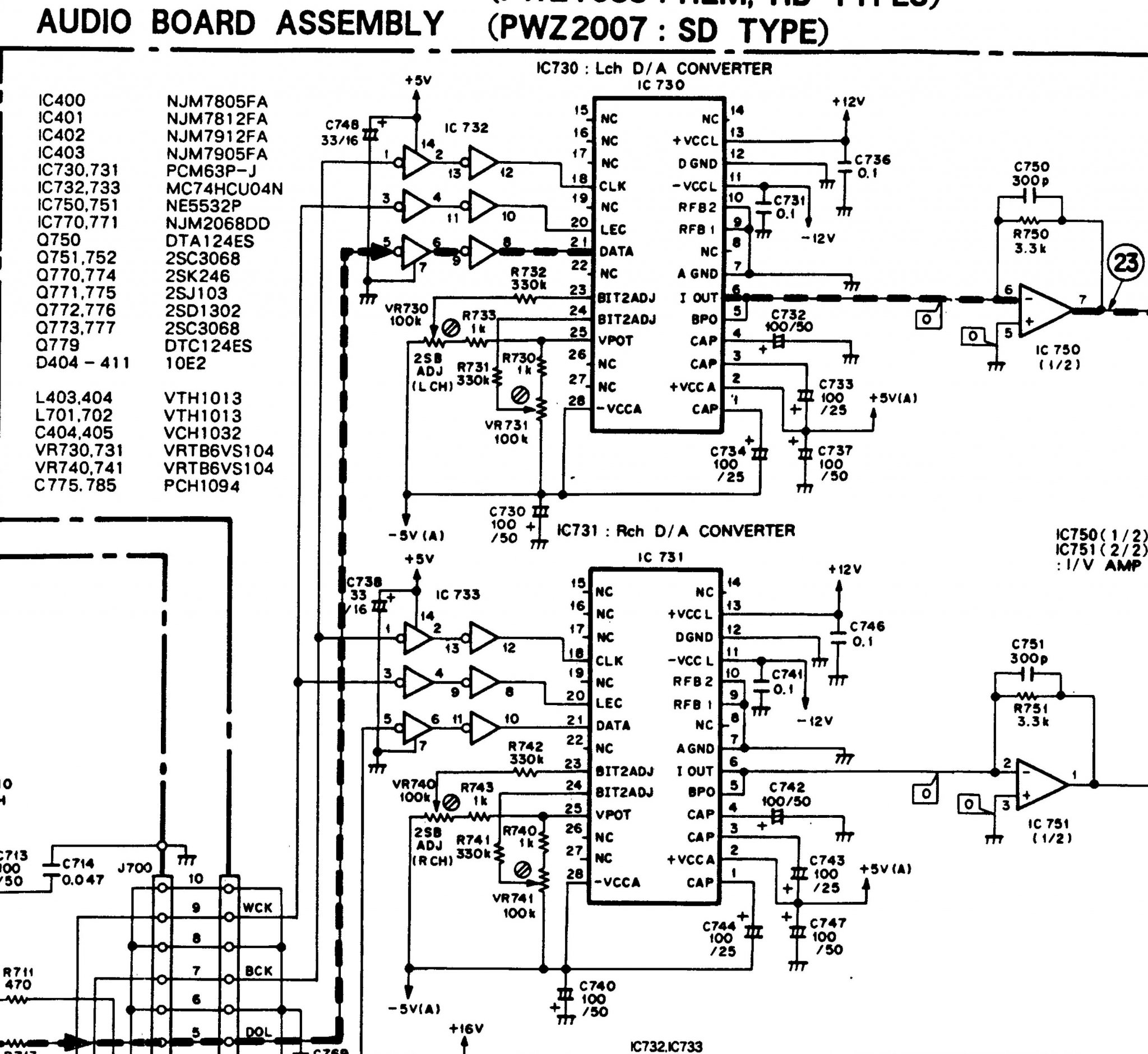

This is Pioneer PD-8500 CD player
According to datashit, IC 732, IC 733 the MC74HCU04N chip can work as an inverter or a signal amplifier. In this case, the signal is inverted 180 degrees on the first input, but the same signal passes through the second gate and rotates another 180 degrees. So we have back to the input in terms of logical states. It can therefore only function as an I2S bus pulse amplifier. The SM5813 filter used in the CD player meets the requirements of PCM63 blocks. So why are these systems used instead shifter registers? On the one hand, they eliminate errors resulting from voltage drops on quite long I2S signal paths, about 30 cm, but on the other hand, they cause some delays due to the imperfection of the MC74HCU04N circuits.If we don't have a filter chip, then there must be shifter registers. And a short wired connection.
Miro, did you look at what Doede Duma did on DDDAC? There is a similar schematic, the same shift registers, I2S input. The DAC IC is PCM1794 also in NOS mode. I'm not expert enough to talk about it, because I'm a mechanical engineer.
I thought the inverter strings are intended to add small delays...?
on 30cm I2S cable ?I thought the inverter strings are intended to add small delays...?
on 30cm I2S cable ?
OK than why 2 inverters instead of one line driver?
To drive long lines a buffer at the source would be the choice (74HCT125). These inverter strings I have seen in circuits of commercial products even if lines are very short: surely they add delay to align timing...
