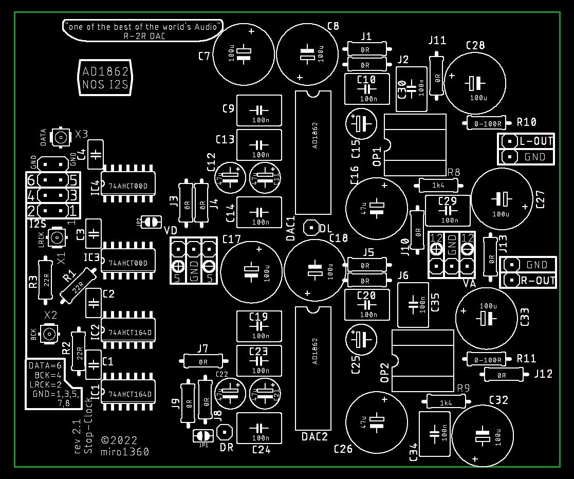

Hi @miro1360, on your last shematic, the crossing 22 ohms across another I2S signal is imho to avoid as well.

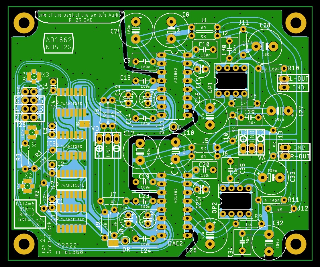

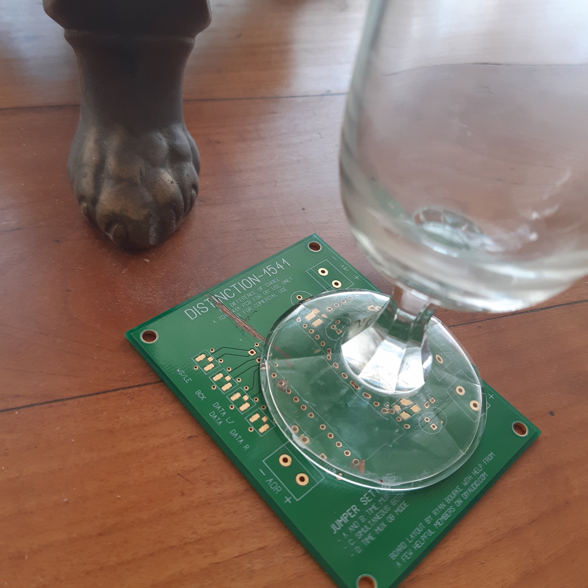

Thank you for the heads up Miro, I will make cup coasters out of these pcb’s.Guys, please don't build this PCB, I already discovered major mistake 😱
Sorry for any inconvenience 🙁
Not the worst use I've ever heard of for trash PCBs!Thank you for the heads up Miro, I will make cup coasters out of these pcb’s.![]()

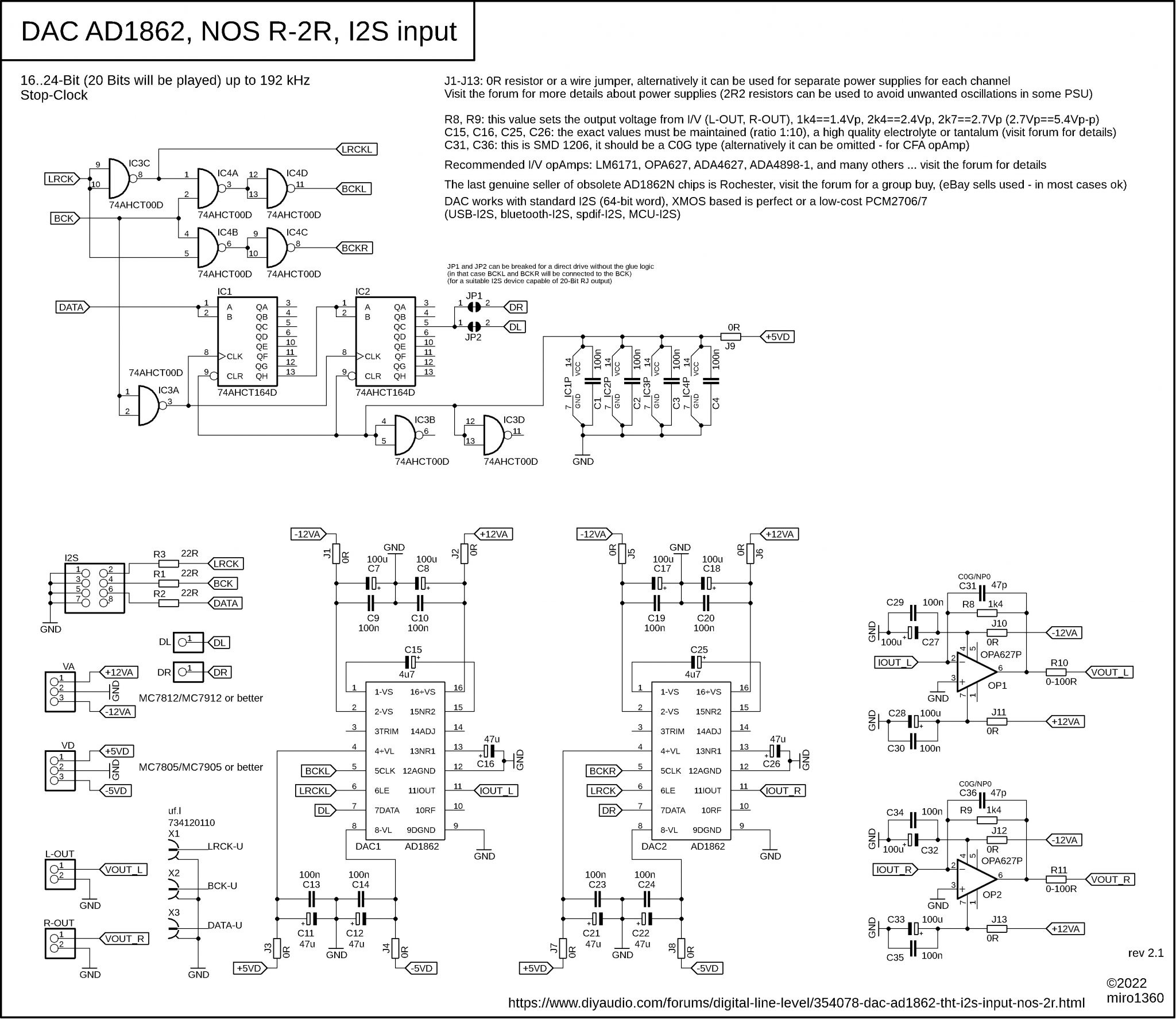

AD1862 Stop-Clock

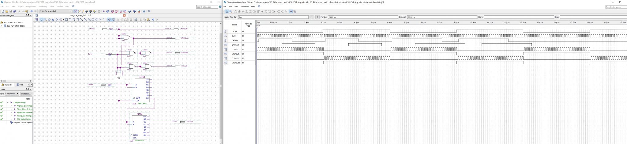

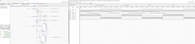

Corrected PCB, hopefully without mistake 🤐 (the mistake was in the LRCK, for the left channel it must be inverted).
It incorporates the Stop-Clock system. What does that mean? Simply: The BCK (clock) is off while no data are present for DAC chip.
Only 4 digital chips are on the PCB. The simplest stop-clock as it gets from my "studio" 🤩 The only drawback from this simplicity may be a channel shift by 10ns (because I left out the 32-bit buffer).
(I shifted channels in audacity by 100ns (10x worse scenario) and I hear no difference, so this shift should not cause any problem.)
Another "major" change is in the ground plane on the PCB. I divided the GND plane for digital and analog with thick cut lines. This helps eliminate potential digital interference and can have another positive impact on the sound 🤩

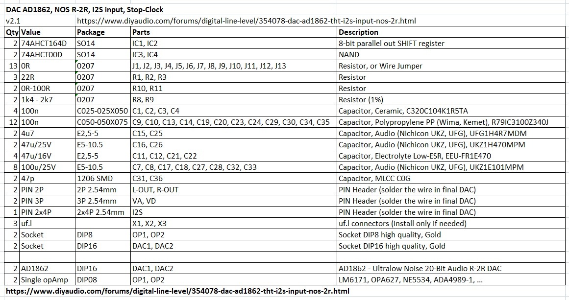

BOM example: https://www.mouser.com/ProjectManager/ProjectDetail.aspx?AccessID=c547c05bf3
note: I/V OpAmp in BOM is LM7171, you can buy another one
The PCB is not tested ... (maybe even more coasters to the collection LOOOL 🤣)

Miro, great work! I am impressed that you could again reduce the amount of ICs - but this circuit is not the one you posted half a year ago... I did test that one for you, see here.
The only drawback from this simplicity may be a channel shift by 10ns (because I left out the 32-bit buffer) 🤣 ... but as I wrote, I tested the channel shift in audacity by 10x worse scenario and I did not hear any difference.

I did 🙂 This system with flip-flops is not "re-clock" but more like "re-align" data. It is not solution for eliminating jitter - in our case the most critical signal for AD1862 - the LRCK. When the source outputs jittered LRCK, it stays jittered also after the flip-flops. If you want true reclock, then the LRCK must be generated from a new clean clock (like 44.1kHz or 48kHz) and this LRCK should synchronize the I2S data (it can be complicated).Miro, would you be please so kind and have a look at #3957...?
... for generating new LRCK from a clean clock a ripple counter can be used (see the 74HC4040) https://pc.watch.impress.co.jp/docs/2004/1005/nidac_ah7.jpg
https://tinyurl.com/2zr7wcff 😎
... better as delayed LRCK can be delay other data and the LRCK left as clean as possible (for the AD1862), ... this can be job for CPLD ... what do you think?
