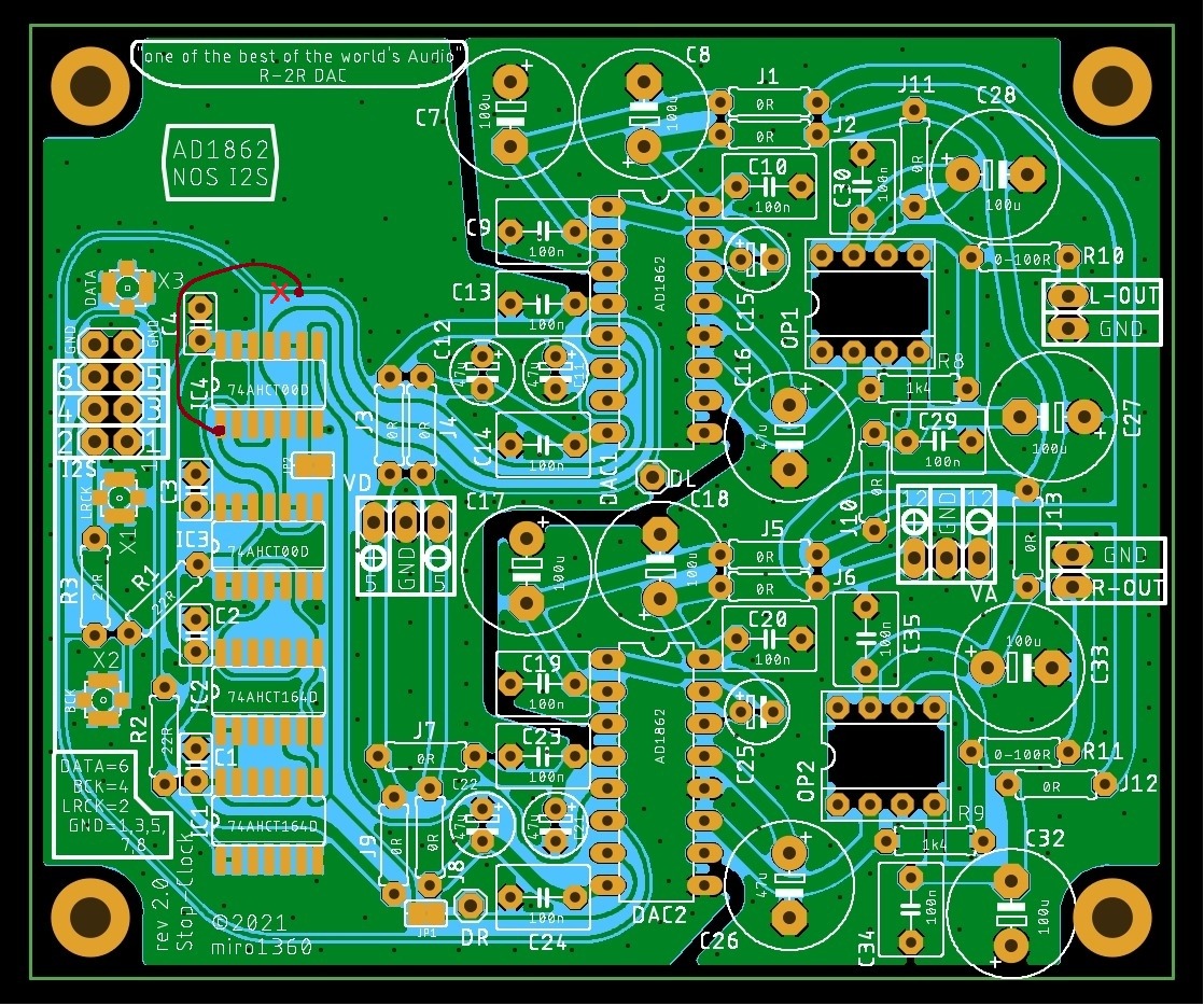

AD1862 Stop-Clock
I did this PCB half year ago and somehow forget to post it here and today found it :ROFLMAO:
It incorporates the Stop-Clock system. What does that mean? Simply: The BCK (clock) is off while no data are present for DAC chip.
I don't know if it has any positive impact on the AD1862 chip, but only 4 digital chips are on the PCB instead of 6 (y)

is this design the same as the stop lock version you had posted here already? This one
Both are marked v. 2.0....
I ask to know if it has the error you detected because It is the version I have and have not yet populated. If not, what are the differences with the very last one you posted yesterday?

@swak Oh, I posted it (v2.0) in the past :ROFLMAO: .... ok, that means it has the error.
You can bypass the error by a wire jumper (you can easily read it from the schematic, it is the LRCKL wire for the left DAC chip (and break the older LRCK trace for left DAC chip on the PCB)) .... or order the corrected PCB, hopefully it is without errors :unsure:

Miro, would it be possible to throw up an image showing what to cut and where to insert a jumper? If the board is salvagable, then we could at least test the stop clock system and compare.....
This is how to break and wire-jumper in the v2.0 PCB ;)
