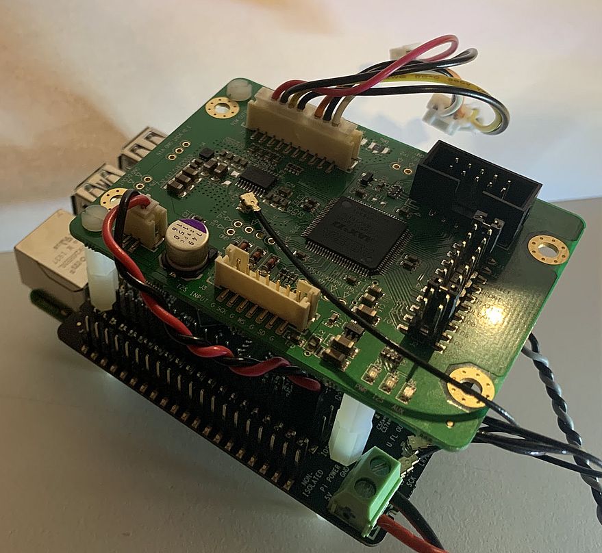

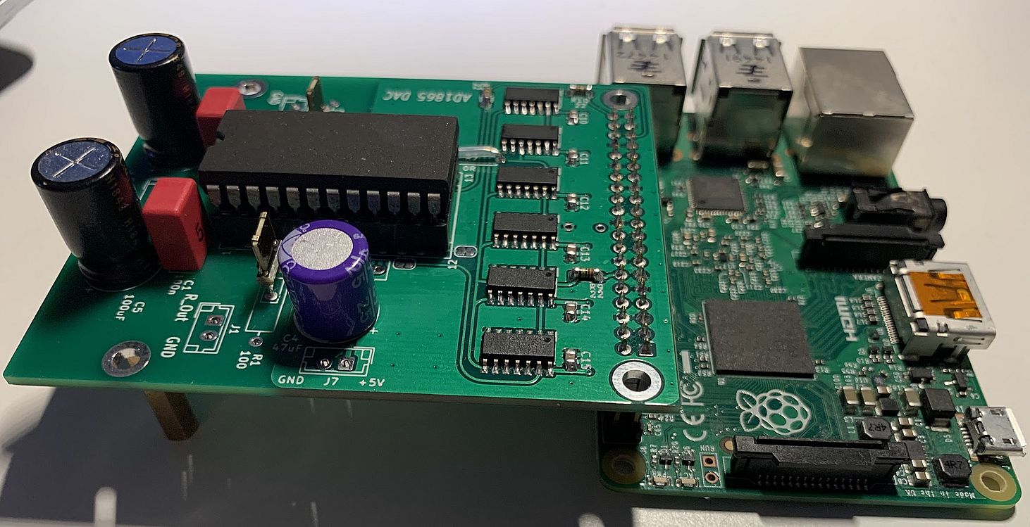

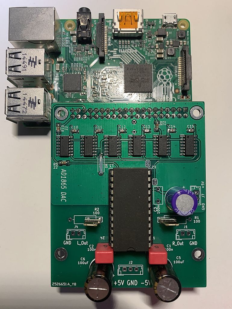

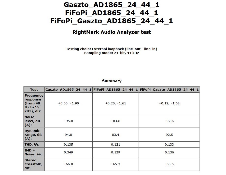

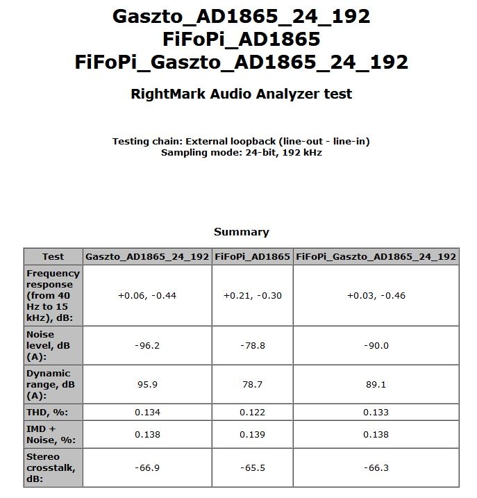

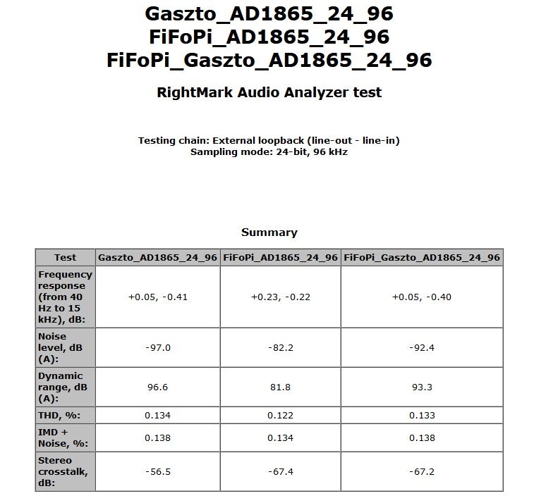

Guys, I've finished the FiFoPi AD1865 DAC.Maybe I can answer a week later. Currently I’m using RPi with JLSounds, but I’ve already bought FiFoPi, and it is on the way. But anyone else has comparison of the two platforms, pleas share experience 😀
My preferences are the folloing:
1. Raspberry Pi4, USB2 port ->JLSounds card ->AD1865 DAC (JLSounds card connected directly to AD1865) [measurement: Gaszto_AD1865_24_xxx]
2. Raspberry Pi4, FiFoPi -> AD1865 DAC with shift registers [measurement: FiFoPi_Gaszto_AD1865_24_xxx]
3. Raspberry Pi4, FiFoPi -> I2sToPcm card -> AD1865 DAC [measurement: FiFoPi_AD1865_24_xxx]
After I put together the FiFoPi with I2sToPcm card, the sound was dull, less stereo image, far away from my first setup.
The second (my pcb with shift registers according to Miro's design) configuration is almost as good as the first. Now I'll start fine tuning the system, changing the stock clock on the FiFoPi etc. I hope at the end I'll have as good DAC as the first configuration, but more compact.
Summarize, If somebody have JLSounds card according to my experiences and measurements, the stock FiFoPi is not an improvement. Ian mentioned for best result recommended to change the stock clock and using LiFePo power supply.
@gaszto I told you guys, R-2Rs are not as sensitive to jitter as delta-sigma are, and the sound experience is not only about very low jitter guaranteed from reclockers From my experience, it is important that the LRCK remains as clean as possible (this does not apply to some chips (PCM1702/4) that latch through BCK) 🤔
Miro,@gaszto I told you guys, R-2Rs are not as sensitive to jitter as delta-sigma are, and the sound experience is not only about very low jitter guaranteed from reclockers From my experience, it is important that the LRCK remains as clean as possible (this does not apply to some chips (PCM1702/4) that latch through BCK) 🤔
I agree with you. It is a special situation, because I’m using RPi as audio player, and RPi is not designed for audio. I2S signal of the GPIO port is not too good. A lots of noises coming from it. A few years ago I designed a DAC HAT with TDA1543 chip, I have used Isolator IC to make “clean” I2S signal.
That is the reason why I bought FiFoPi. The isolated “clean” I2S (LRCK) is necessary as you mentioned. Reclocking is just extra feature in this case.

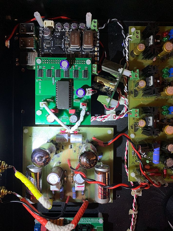

Some photo:
And the "final version"
View attachment 1030597 View attachment 1030598 View attachment 1030599
Can you tell me the product name of the passive I/V resistor? It looks like a Caddock in the picture.
