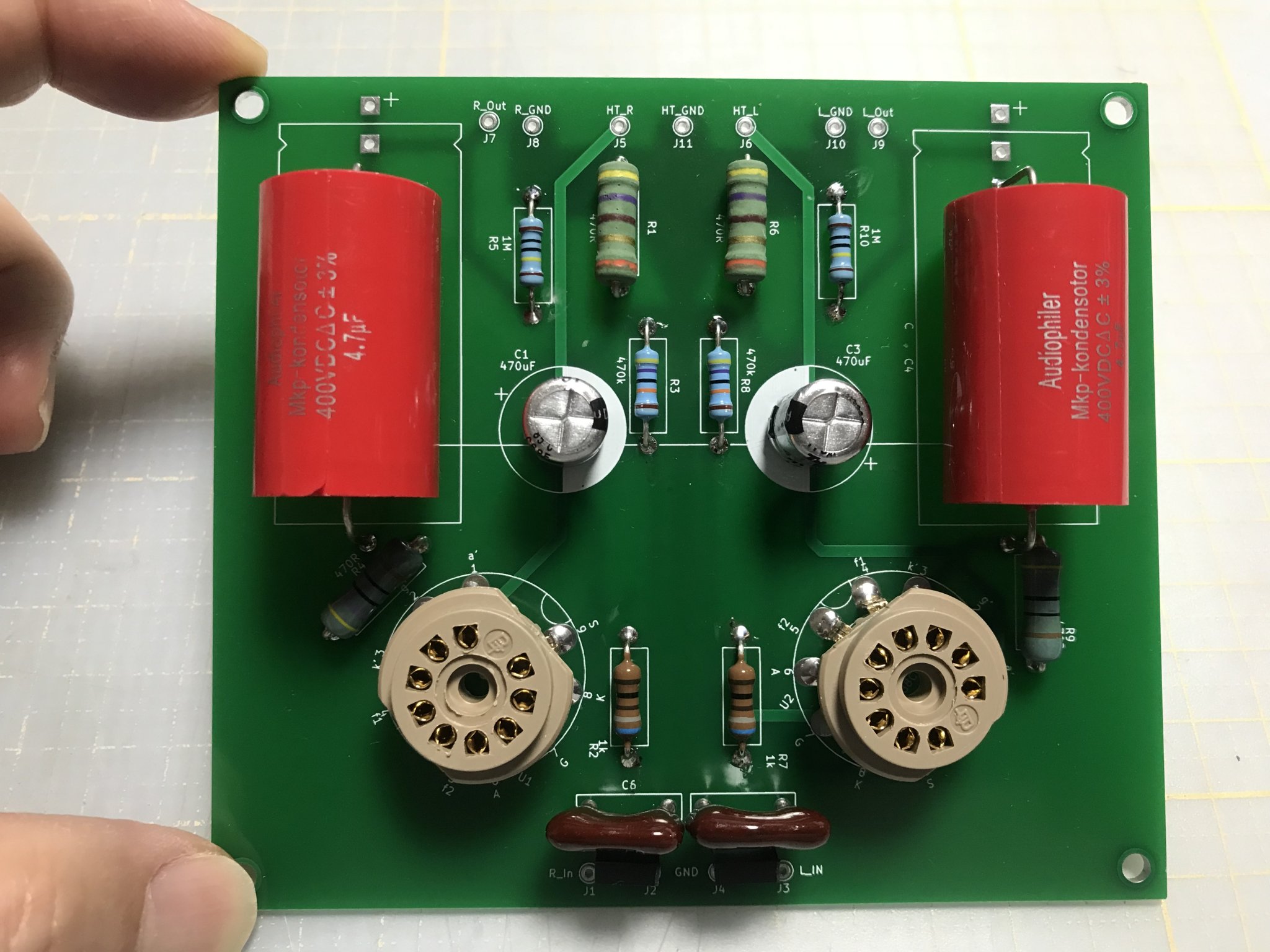

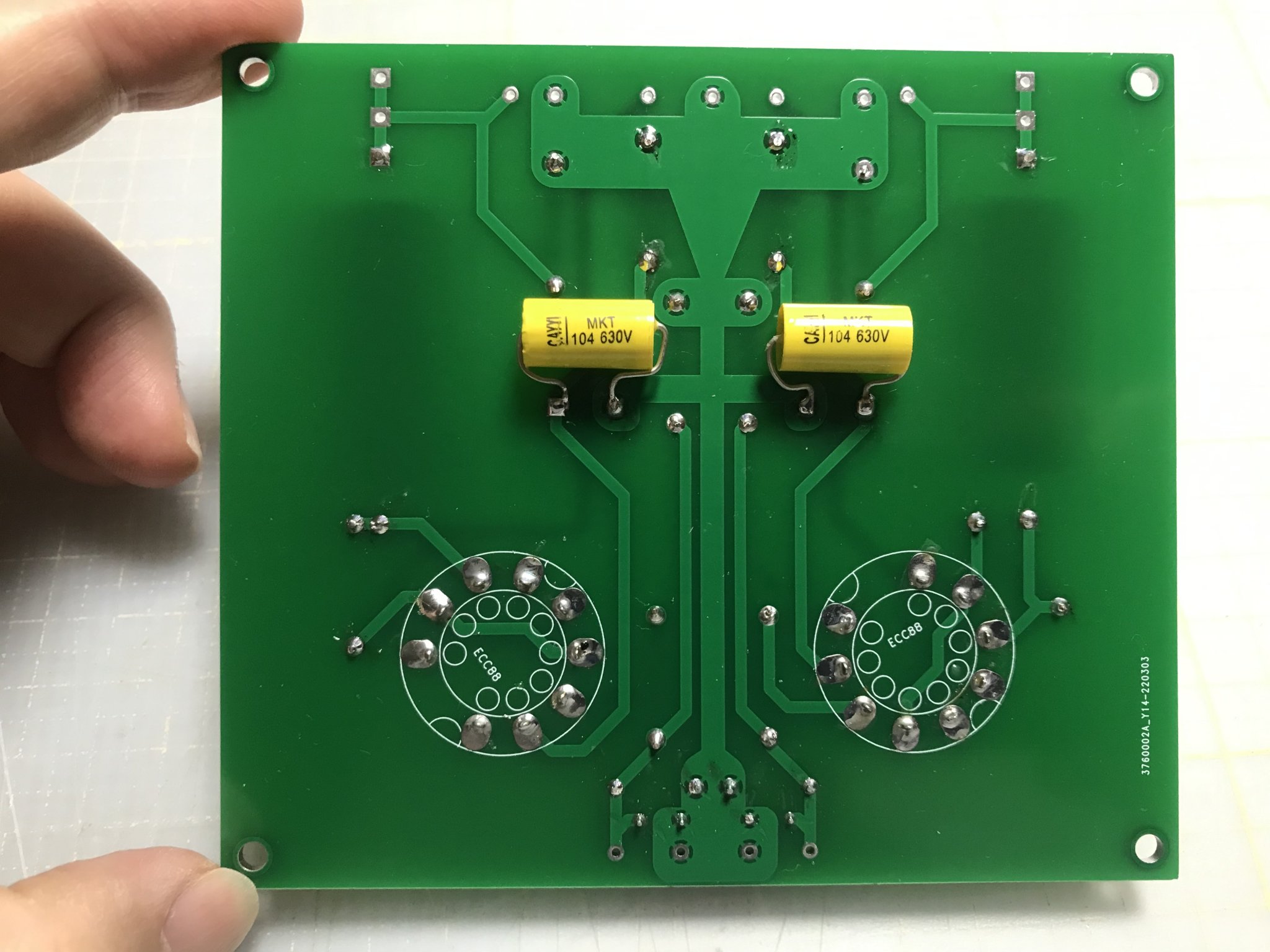

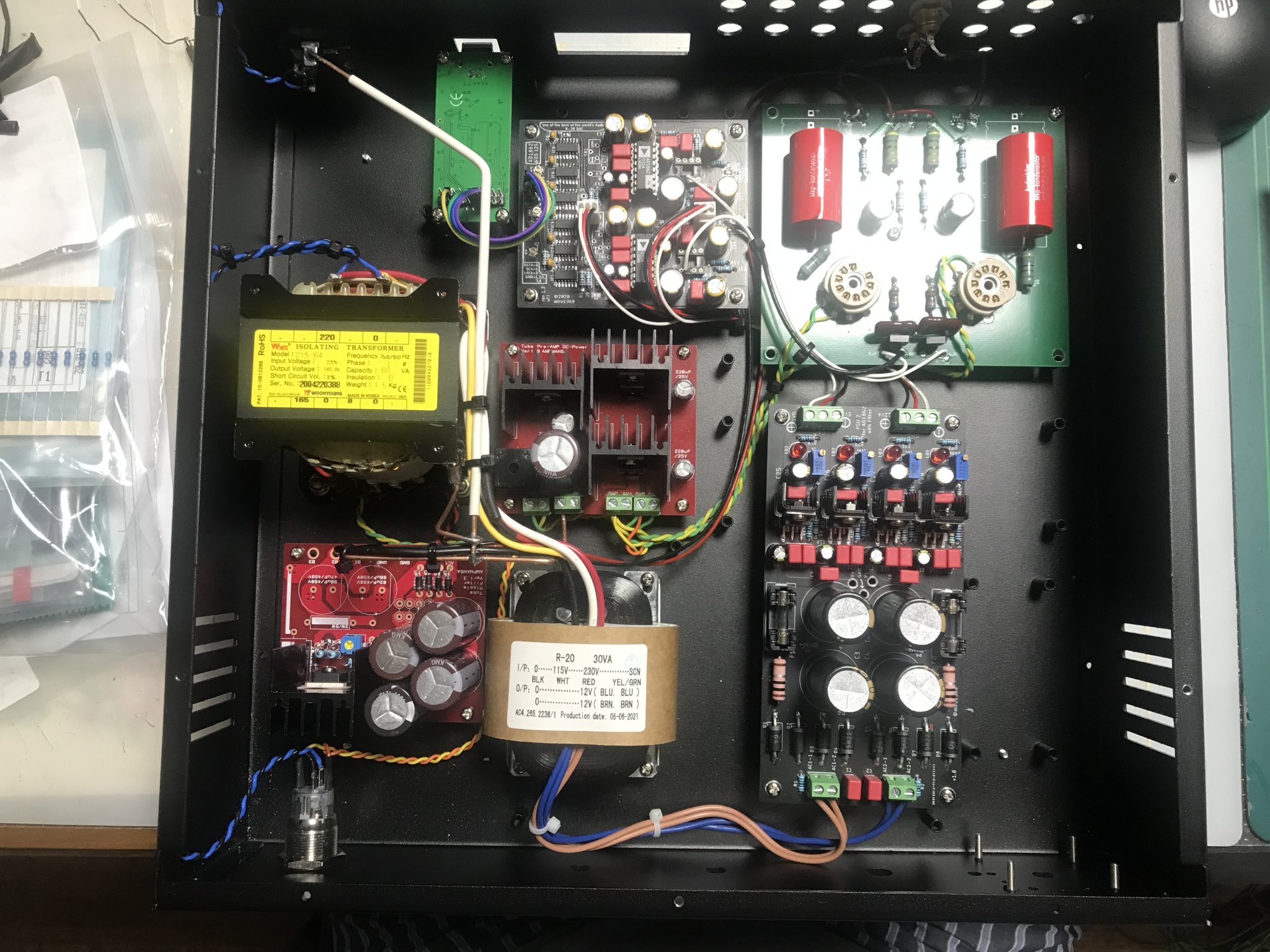

I built your Tube Output Stage today and connected it to the AD1862. I'm happy to hear that I prefer the sound over the OP stage. The mid-range voice are especially attractive to me. Thank you.

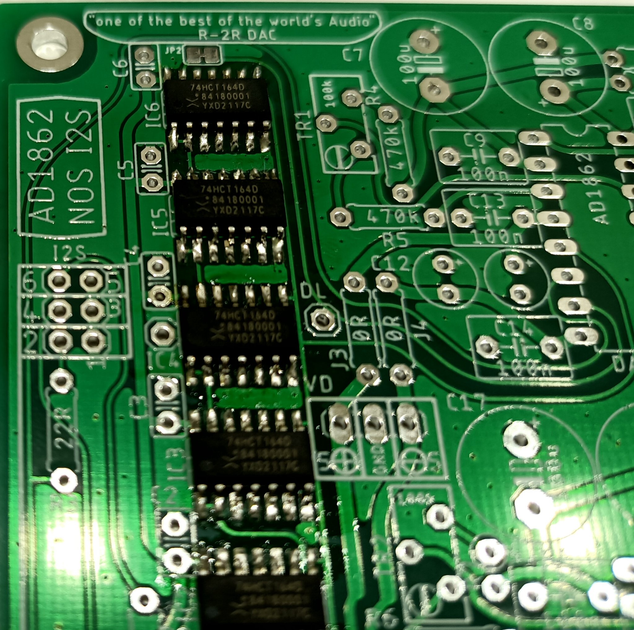

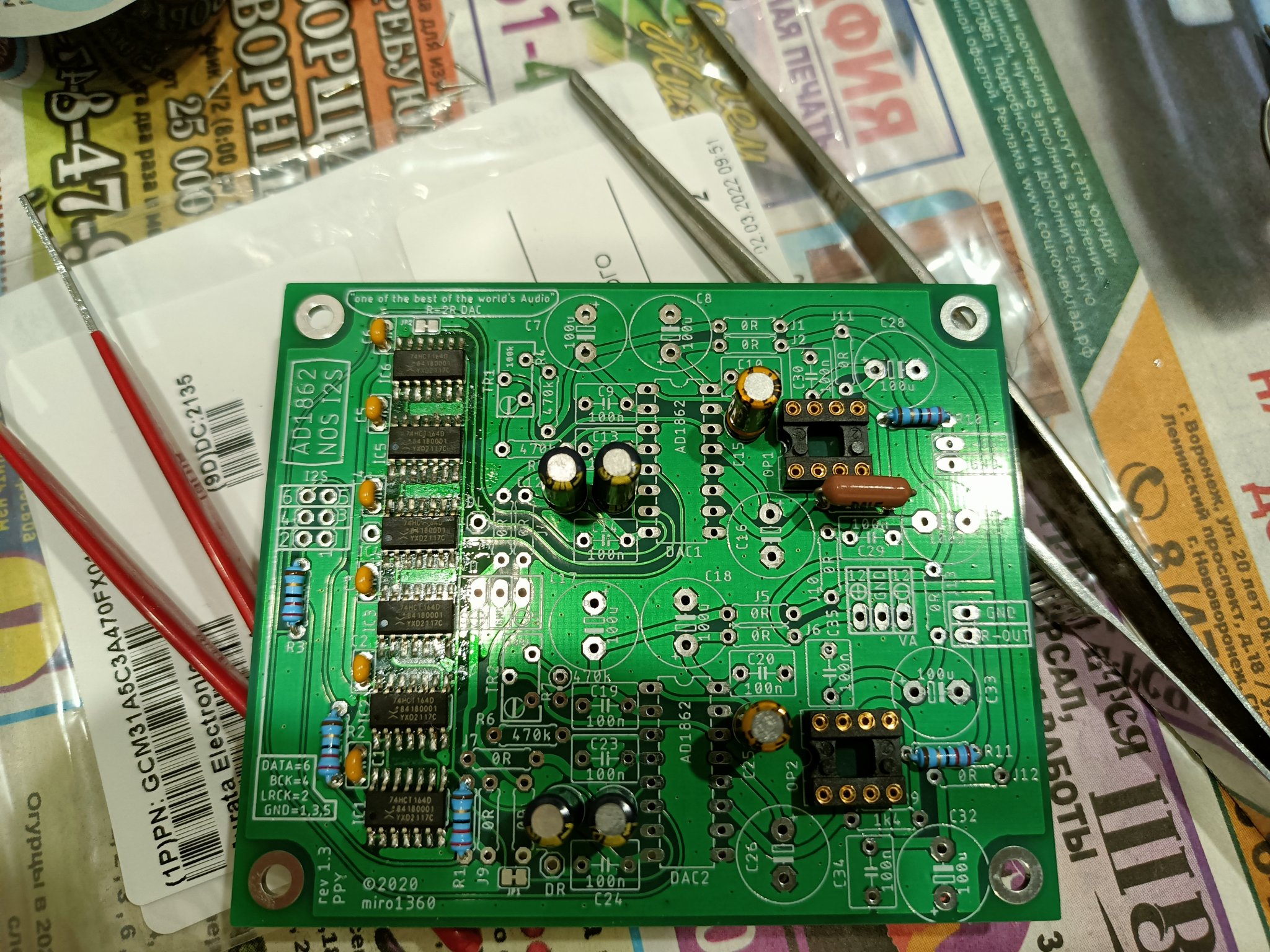

I started to solder the parts... Please look at shift registers - are they properly soldered? This is my first chips and smd's😀
I have a trouble with Dale resistor - he is too big for place on board - what should I do?
Unfortunately I can't build PSU-2. I will be look an another PSU (my friend got one). Do I must solder 2R2 or just jumpers (J1-J13)?
I also buy Amanero and need the transformer (I guess I'll order from ali R-Core 12V). The last parts will be soldered on next week!

@miro1360 back side have only two smd's and not difficult to solder them. I'm glad about 74HCT's 🙂
Dale have a big body and I put down him but is there a small distance between board and resistor. I hope is ok too!
Mouser is not send to me is one thing - 113316 (dip 16 for chips 1862). I will buy them a local shop.
I'm happy that you enjoy it 🙂
What is your B+ voltage?
According to my experience string instruments are sounding so realistic. Generally the music is more "live" for me.
You can try another capacitors at the output. This is a really basic circuit the result is highly depend on the components. You can fine tune the sound according your taste.

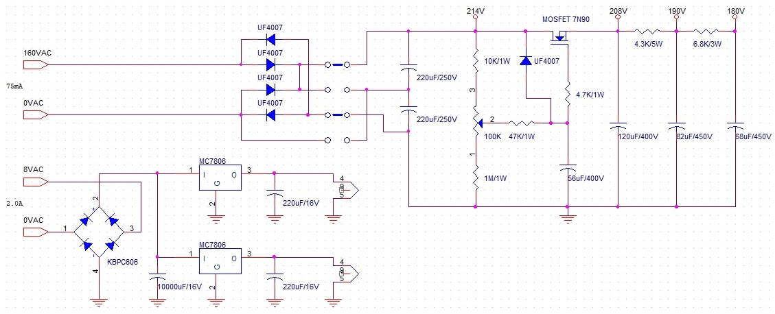

I'm using FET ripple filer circuit. B+ is 205 VDC now, it can be adjusted from 180 ~ 22?
K voltage is 2.53 VDC. I'll try another caps at the output.
