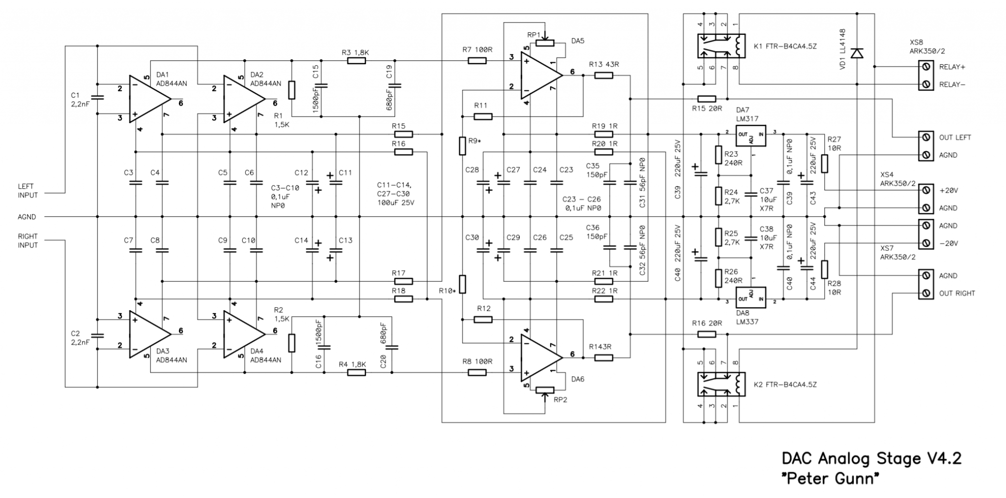

Ordering from a competent person, a fee is PCB according to the following scheme (fees are only sold, there are no gerberas). They are very praised for how it sounds. One "but", it uses BUF03 and is the most preferred, but they have not been produced for a long time and are rare, but there is a minimum order of 18 pieces for our beloved Rotchester Electronics. If there were enough people willing, Paddy would have ordered. I think the Miro DAC will sparkle with new colors with this output, according to reviews, this output with R2R is very much praised.
Not so sure. Old design nowadays. Do you need a headphone Dac maybe ?
opa861 is better than the AD844 for the task and simplier, then the BUF03 can be sometimes hard according what you have in your hifi, there are today fresher oaps for a buf. And very cool discrete stages have been tested in the thread... And a X7R cap with a LM317... bouhhhhhh !
I would see more something as I described with a proper decoupling for the opa861 at I/V then a modern buffer like the single opa825 to stay smd and compact or two modern Toshibas if a buf is really needed as a single opa861 per channel should suffice with most of amp/pre...
Better (harmonics profile)? Sorted out transistor for a discret I/V : EUVL tested already inthe thread.
What is your option with a ready-made PCB board? Over time, I will collect both, I will compare .... Over the course of several years))
Vunce made a pcb for the opa 861 you can use with Miro's board. Both posted the gerbers in the thread.
Sure, do what you want, but I just advért that AD844 was a lot benchmarked vs opa861 and the former never won while being more expensive and eventually needs stacking. So imho better people spend monney where it is both less expensive and better sounding...you know it is a limited world where we live now. But your freedom YMMV.
It is not entirely clear from the diagram what to connect to, one board, one channel, if I am not mistaken, is it connected immediately to the output of the AD1862? Or as an addition to what is in the Miro DAC?

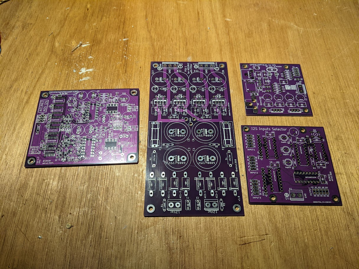

flak monkey, those are nice boards.
Did you have to order a minimum quantity of boards from JLCPCB?
Which one of the many layouts is the one you ordered, as I am looking for a computer usb >I2S>Dac>pre>amp type of format.
MM
There is a MOQ but I ordered extra above that too as it cost so little to do so. I have 10 of each board and am in the UK.
I used the board configurations in the linked post here: https://electrodac.blogspot.com/p/dac-ad1862-almost-tht-i2s-input-nos-r.html

Thanks! Had to do something different with the boards, not that anyone ever sees them beyond the build!
I think I have everything I need for the build, but thank you for the offer!
@flak monkey Nice PCBs, happy building :cheers:
Did you order corrected PCB for the I2S inputs selector? https://www.diyaudio.com/community/...s-input-nos-r-2r.354078/page-146#post-6868316 ... if you ordered the older version (from post #2526), please make the button correction.
For the SPDIF/Optical to I2S do the correction: DATA and LRCK is swapped #2450, don't use GP1FAV50RK0F as optical input (it is 5V) use alternative for 3.3V (@jimk04 used TORX147)
Thanks, yes I ordered the corrected I2S input selector board 🙂 and thanks for the heads up on the DATA/LRCK correction - I do remember reading that and was going to ask if that was still applicable or if the files had been updated since that comment.
I ordered a 3.3v optical input - on a slow boat from China 😆

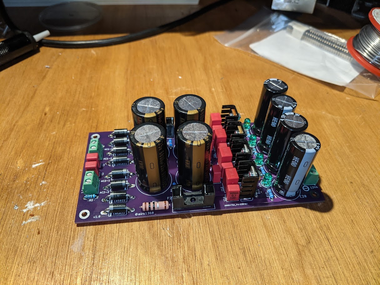

I got the PSU built up this afternoon
