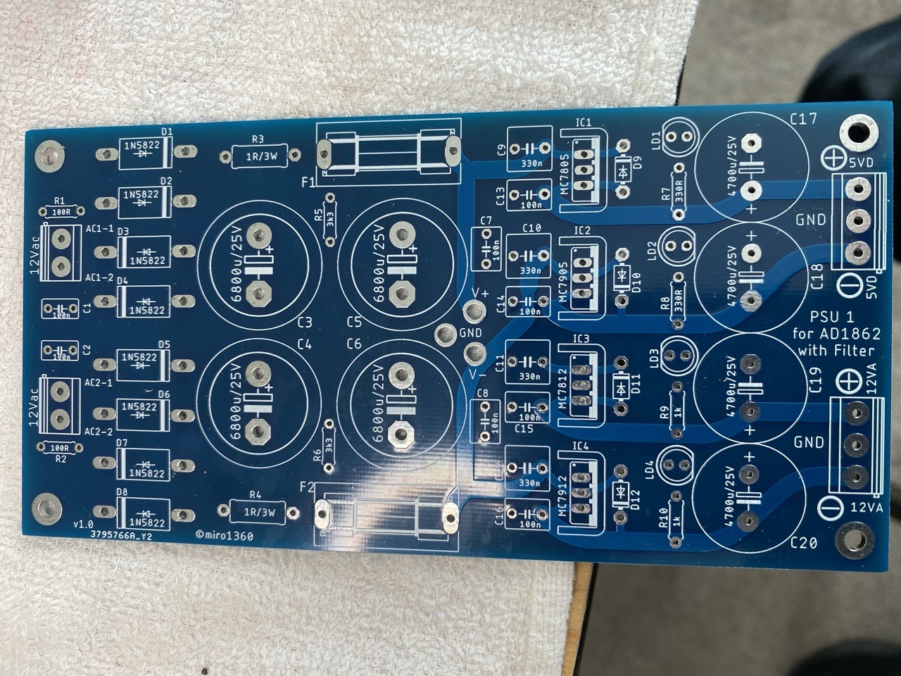

Hey fellow travelers,
Regarding PSU 1:
Can I use a smaller led (LTL—4231N) at LD 1-4 locations? If so, are there any changes to the resistors at R7-10? I just don’t want those led’s to be too bright.

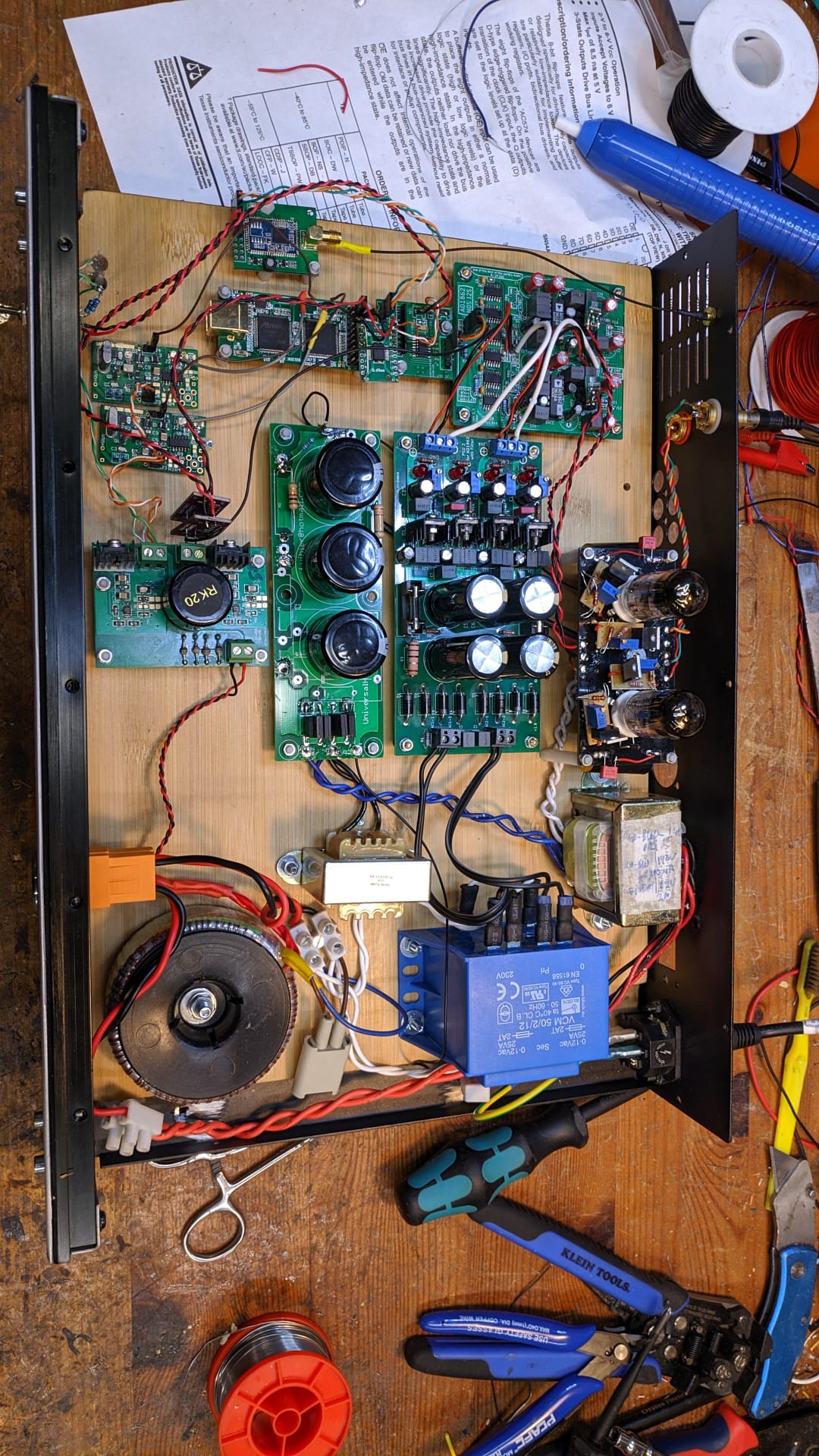

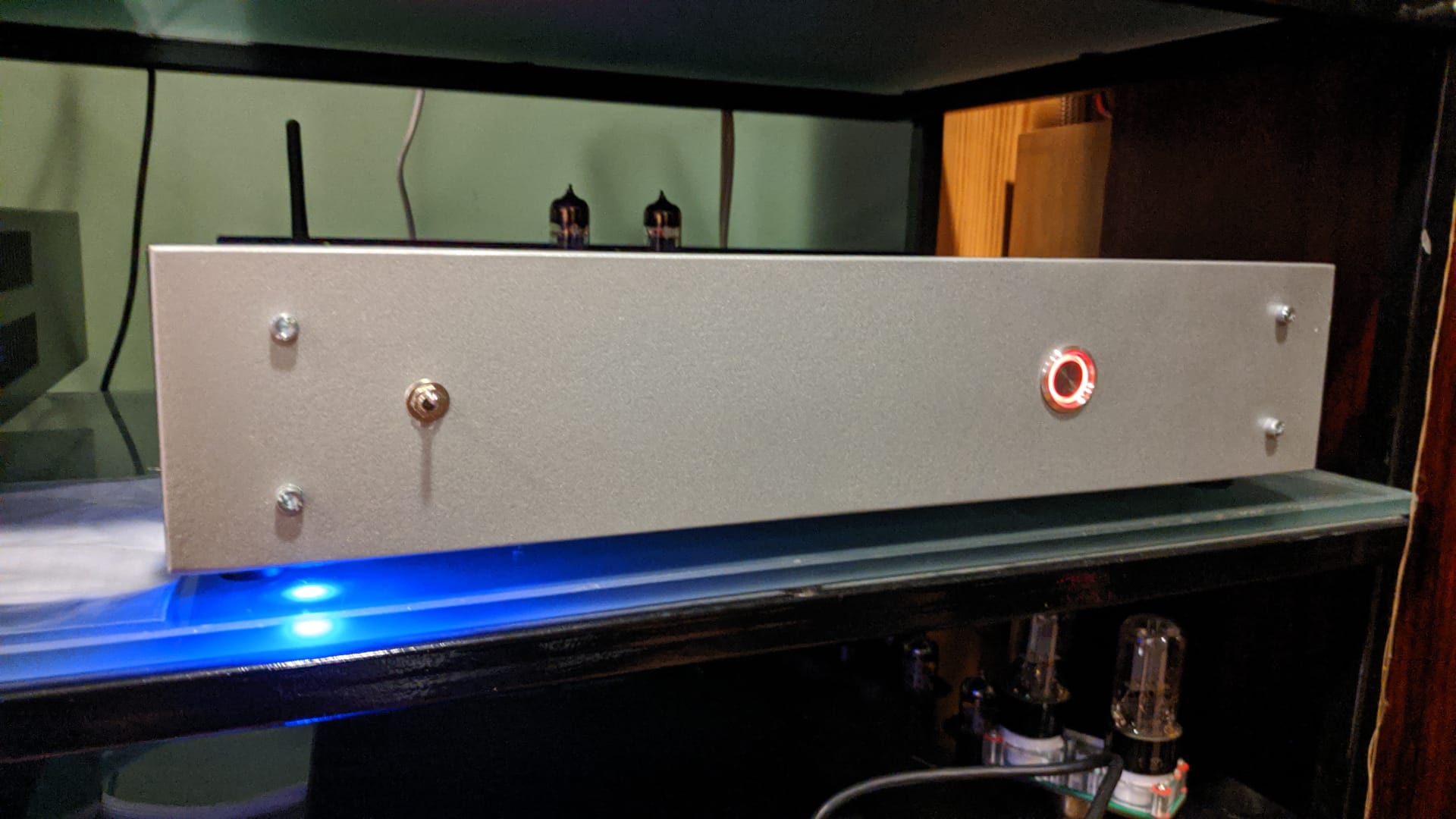

My reference for a good while now has been an SD card player>>Mori clocks>>Miro DAC>>3a5 DHT output stage.... and I have been using a duplicate setup with many different output stages - from opamps, to solid state, to valve. However I think I am not at the end of that rope, and I will use the second build for a USB front end. I have this almost finished now, just waiting on a USB panel mount cable for it. Along the way, I added a bluetooth module and 12s switch to allow me to flip between USB and bluetooth. I've used a 6922 DC coupled cathode follower for the output stage. Very happy with this build which seems rock solid.
This Miro dac has been a real road of travel for me over the past year or so. I had come from a very good 1794 DAC, which is still great, but the AD1862 just tips it as the winner. I know I've said it before, but we should be very grateful for the community here that has fostered this - Miro of course, but also Paddy Garcia for the chips, EUVL for much advice and experience with output stages, and many, many more who have contributed along the way with feedback and testing.
Happy New Year, and may all your builds in 2022 be easy and free of hum!

Nah, there's a cap on each channel out - I tend to favour Bennic caps for this, but have used some of the Russian ones before to excellent. They really have great capacitors.
There's one ground wire between channels - they are tied together on the PCB anyway, but also the two RCA jacks grounds are tied together and then a single wire back to the board. Twisting the wires is habit more than anything else - it's just neater and without it, I always end up with a much worse rats nest (and its already a bit like that!). I try to keep i2s lines as short as possible too. The i2s from the bluetooth unit is a bit long, but thats really for casual listening. The USB amanero links directly to the reclock, then i2s switch before the DAC. I usually would reclock just before the DAC, but I can't do that here with no mck from the bluetooth.
That little cathode follower board is from Aliexpress, I replaced the plate resistor on the gain triode and cathode resistor on the follower with CCS (just 10m45s) which definitely helps it. heaters are AC, with a virtual centre tap elevated off ground by 75V. Even without the elevation, I was still within cathode to heater limits, but the advice out there is that elevating the heaters often makes the stage a bit quieter. So, last step (is it ever a last step!) I think is to get that panel mount USB cable and run it to the back wall, and put the lid on it.
While the USB/amanero with Mori clocks is clearly better than bluetooth, I can say that the bluetooth really does sound good. If you heard this and didn't hear USB you'd think it was great. Very handy for running streaming to hear new material.
