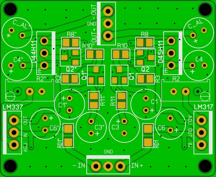

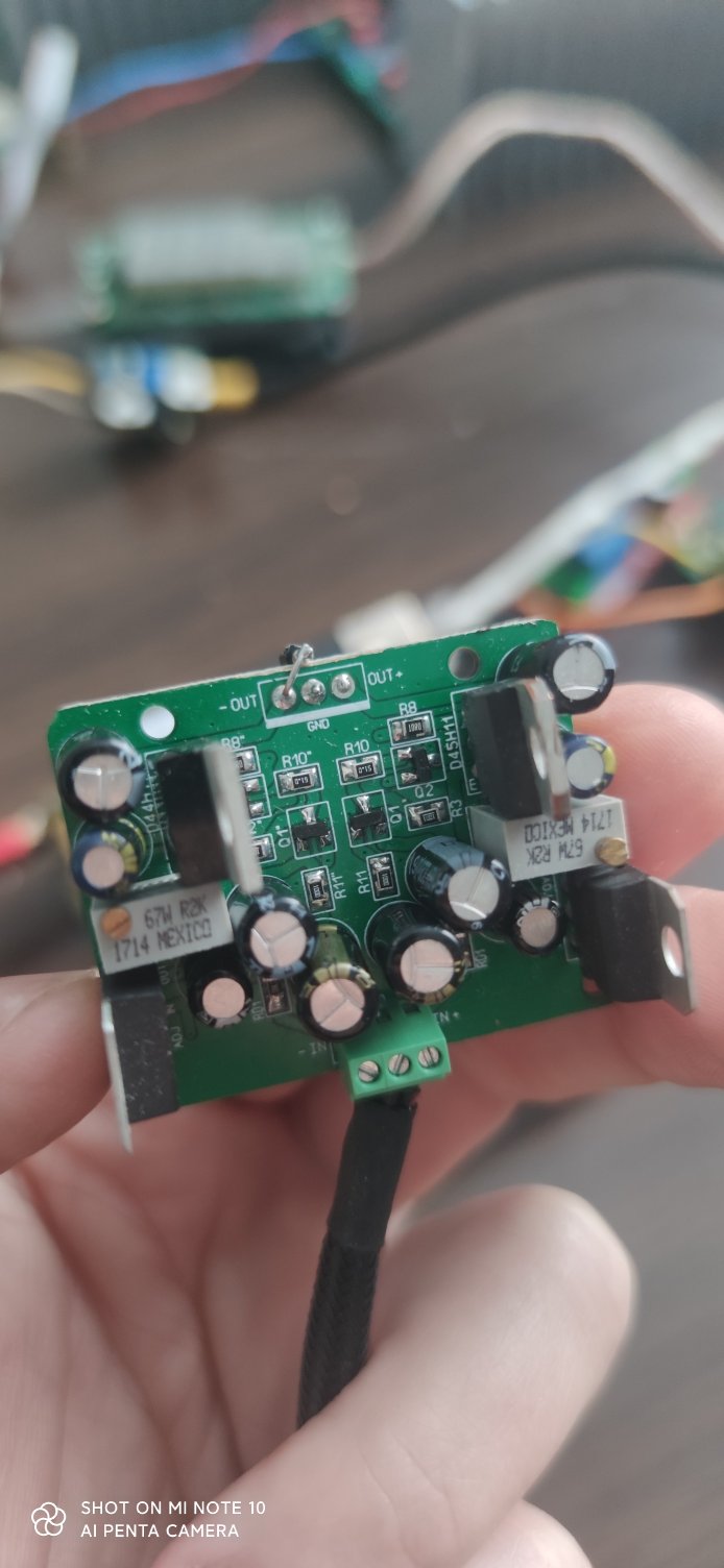

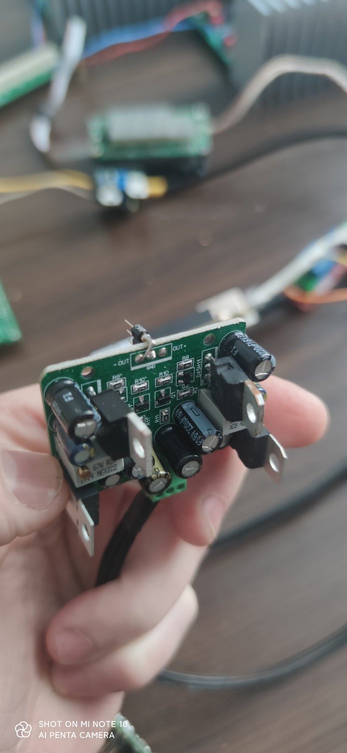

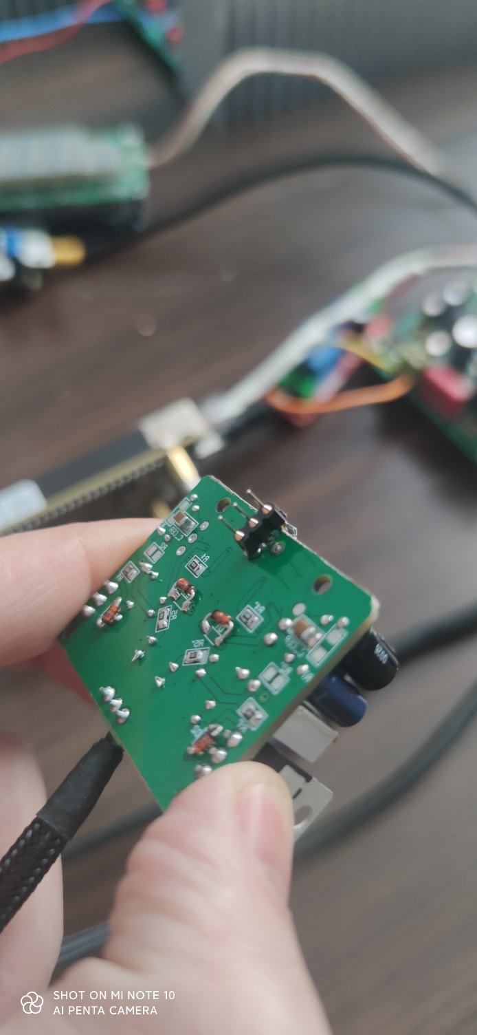

Colleagues, I apologize for not immediately guessing, to transfer the output stabilizers under the DAC from Miro, I did it as in the photo. But if anyone else will order the boards, here's a more correct option. And do not forget to read a note from the developer, with a recommendation for capacitors.
There are also boards for a different, also very high-quality shunt-regulator, from Nazar, if I need to post it, but I also need to tweak the pot DAC boards from Miro
Iirc I perhaps talked here about Nazaar fast reg LM317 based...simple and elegant design...fast transcient, could be perfect with styren radial caps 0,1 uF from Lcr at Farnell shop or red Mkp from wima or blue Ero Roe for smoother sound.
Thanks fornthe gerber...pretty little nice pcb.

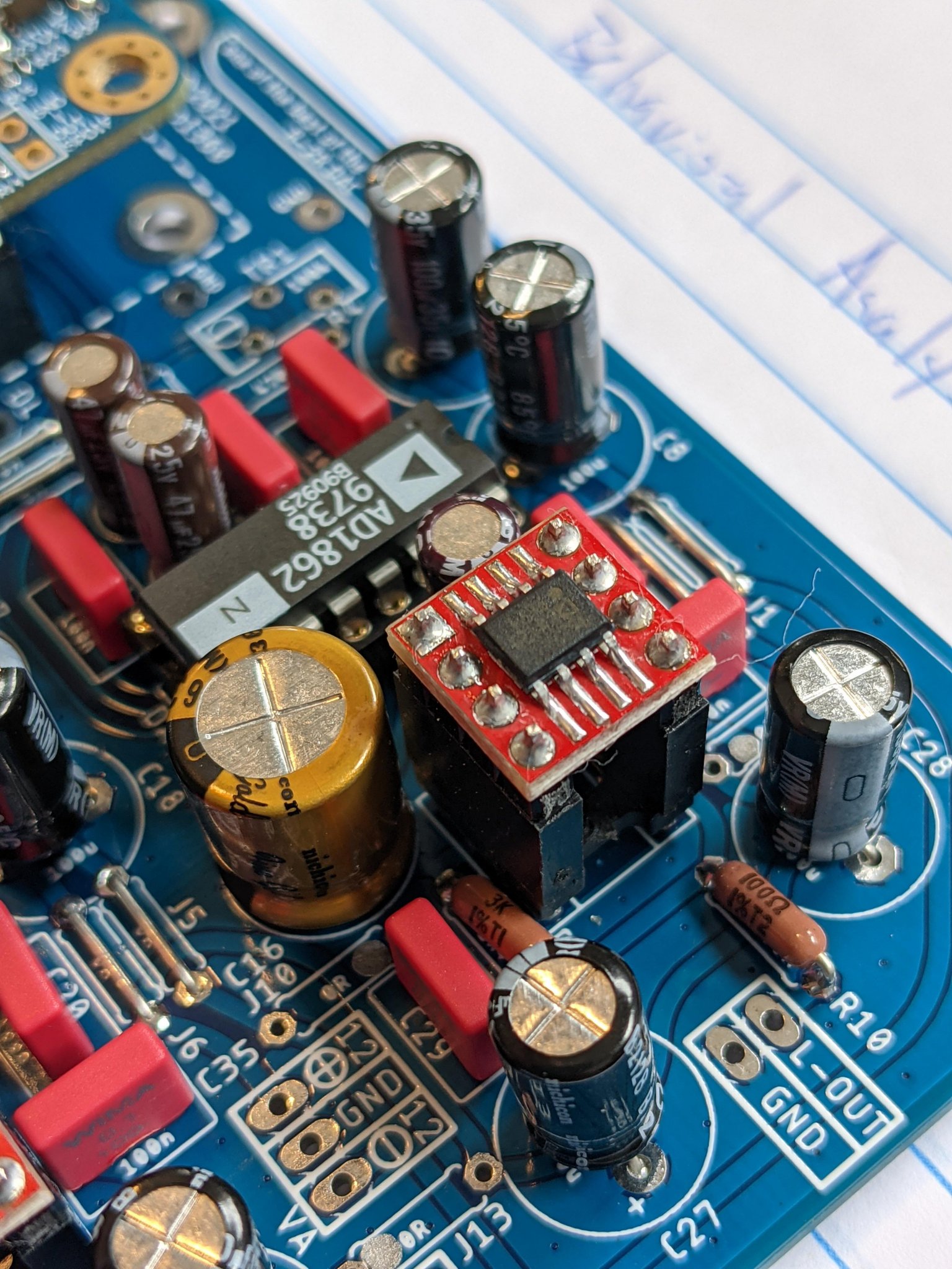

Can you solder a socket to the dac pcb in the opamp location to make it easier to swap out opamps. Using a soic to dip adapter soldered to header pins. Then just change the whole assembly out to “roll” a different opamp? Is this advisable?
This is what I did. There is a photo a few pages backSparkfun looks like a good site. I’ll get some of the adapters and their headers. Not sure if the pins are machined , description doesn’t say
Yup, just checked it out
Just solder up a bunch of opamps and plug and play.

I'm nearly finished with my build. I've got my op amps on tallish standoffs because that's what fit together. Is 17mm high enough to cause parasitic problems and oscillation, or do you think I'm ok?
