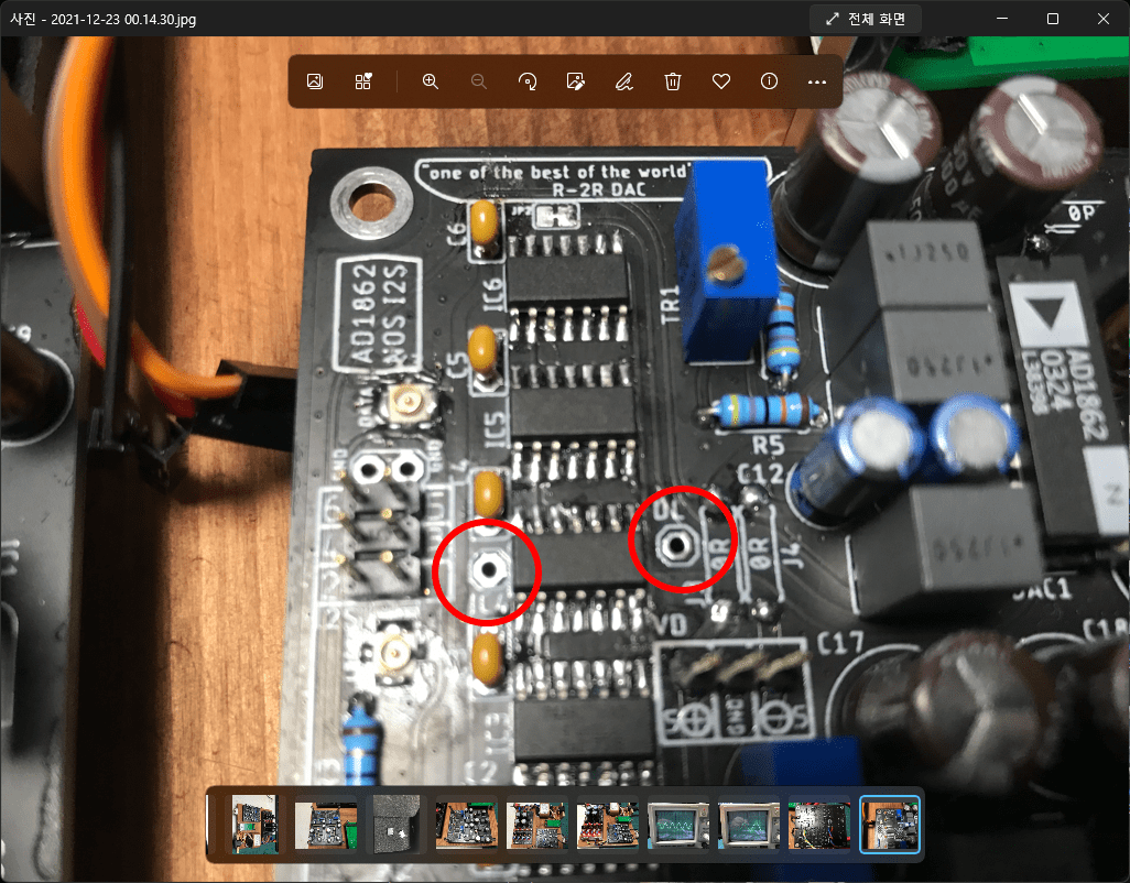

I tested it by connecting the raspberry pi and i2s instead of the pc and installing moOde. I installed moOde and changed the settings to output in 24bit/48khz.
After re-soldering and playing music, the left channel plays normally. This is a sound I like very much.
There is no sound in the right channel. I suspect 74ahct164d on the right channel, but I would like to proceed with troubleshooting for more accurate diagnosis.
I think I could check something with the points marked DL and RL on the board using oscilloscope. I would like to know what this point is used for.
Thank you in advance.

DL and DR pins are for USB/I2S device which does output 20-bit PCM format (jlsounds) (shift registers are not used in this case). There should be DATA present in both pins during music playing, you can check with oscilloscope.

Thank you.DL and DR pins are for USB/I2S device which does output 20-bit PCM format (jlsounds) (shift registers are not used in this case). There should be DATA present in both pins during music playing, you can check with oscilloscope.
I used 74AHCT164D (faster) instead of 74HCT164D , is there any problem?
