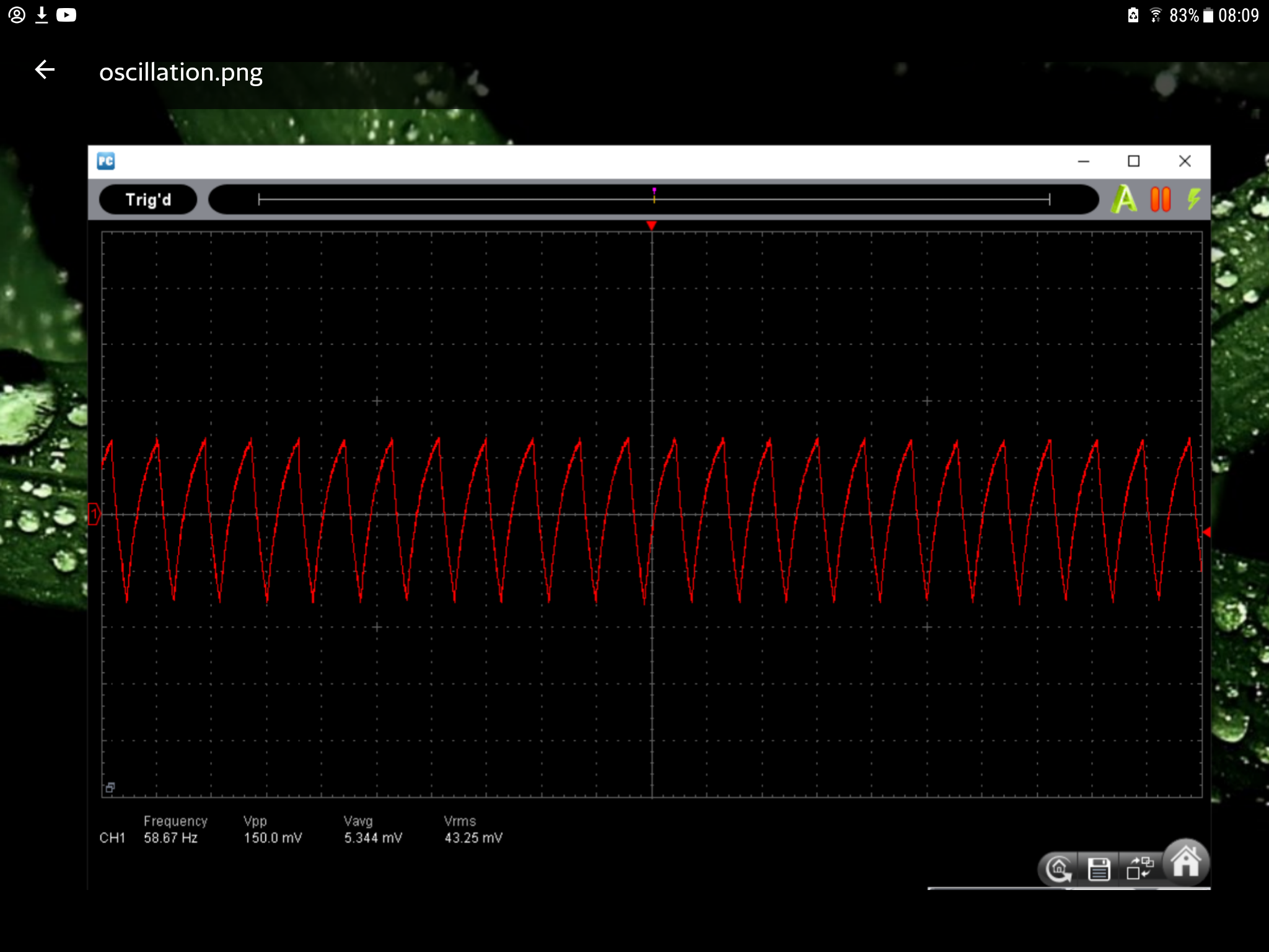

Today I did more thorough testings of my LT3045 and LT3042 power supplies and would like to share the fun:
1) there are no more ocillations at idle or under load, since the voltage fluctuations are sparse and totally random when zoomed in. When I had oscillations, I could easily see regular wave patterns caused by the oscillation. Once the oscillations are removed, regular wave patterns are also gone ;
2) the 20 mv Vpp my scope showed me is actually limited by the smallest measuring unit my oscilloscope is capable of doing. I wasn't aware of this before. I wasn't happy with this 20 mv Vpp and was tearing my hairs out trying to trace it, until I zoomed in all the way to 2ns intervals and saw that the voltage was jumping up and down frome time to time at exactly 10 mv step each time. I realized that I was witnessing black magic! 10 mv, what a nice and consistent number! Hahaha! My power supplies are actually doing better than what I can measure! This has put a big smile on my face. What a relief😀😀😀

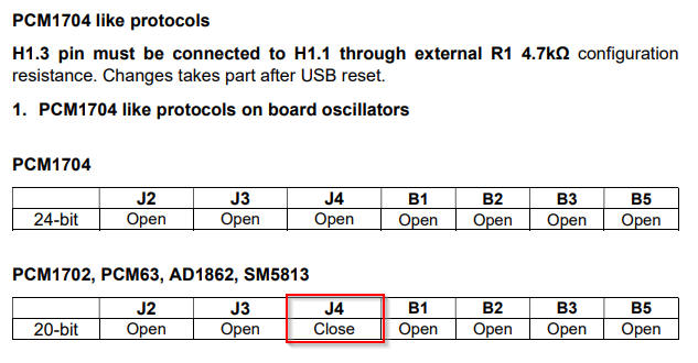

And configured like this?
  • 2021-11-14 14_21_14-I2SoverUSB v.III.pdf und 9 weitere Seiten - Profil 1 – Microsoft​ Edge.png

My oscillation was running at a low frequency of 59 hz. Even so my meter wasn't fast enough to show it. My meter reading was rock solid too. It must have been showing an average voltage, which was indeed rock solid.
I wish I had bought an oscilloscope earlier. My oscillation had a range of 150mv and it didn't have any noticeable effects on sound effects. Only an oscilloscope can reveal it.

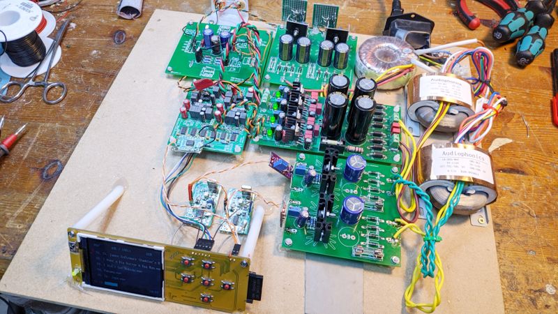

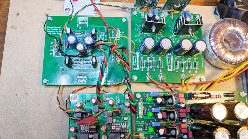

Here's one that I've done a little work on recently. This one has SD card player as input, with Andrea Mori clocks, and the Pedja Rogic diamond buffer output stage, powered via a fairly simple 317 supply with a homemade denoizator.
The i2s lines are reclocked just as they enter the DAC.

Bravo..awesome !
What's your listening feeling on this ? From my side the more the digital front end is tunned with care the better the ending result.
Worth to use the PS2 with some voltage adaptation for the Discroll boards and the PSU1 for the DAC instead ?
I've tried a good few power supplies with the Rogic output stage - shunts, jung type regs, even supercapacitors but this pretty simple reg wtih the denoizator matches them. Its the first time ever I think that a basic supply is not far outclassed by something more high performing.
Its a lovely stage - and if you search back you can find the gerbers that dvb-projekt posted several years back (with permission). They were made for TDA1541, so need a slight adaptation to 1862, but its simple. Also, if you match transistors half way near each other, and keep them thermally in contact then you won't need an output cap.
Every improvement on the front end can be heard....
Need I say this again.... this is a great DAC. If you want to take it to a higher level, use a good front end, good power supplies and a discrete output stage.

What modifications did you have to make to Rogic's output stage? I'd definitely like to give it a try with the AD1862. 🙂
