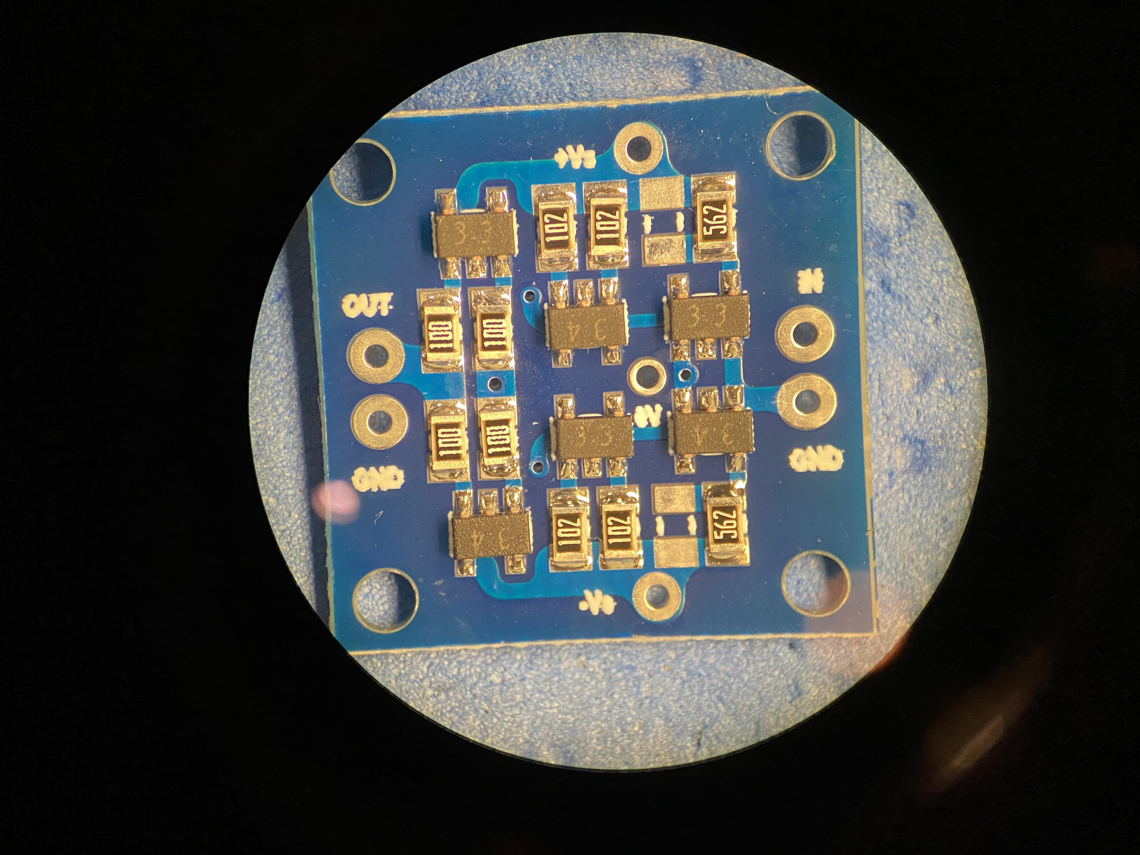

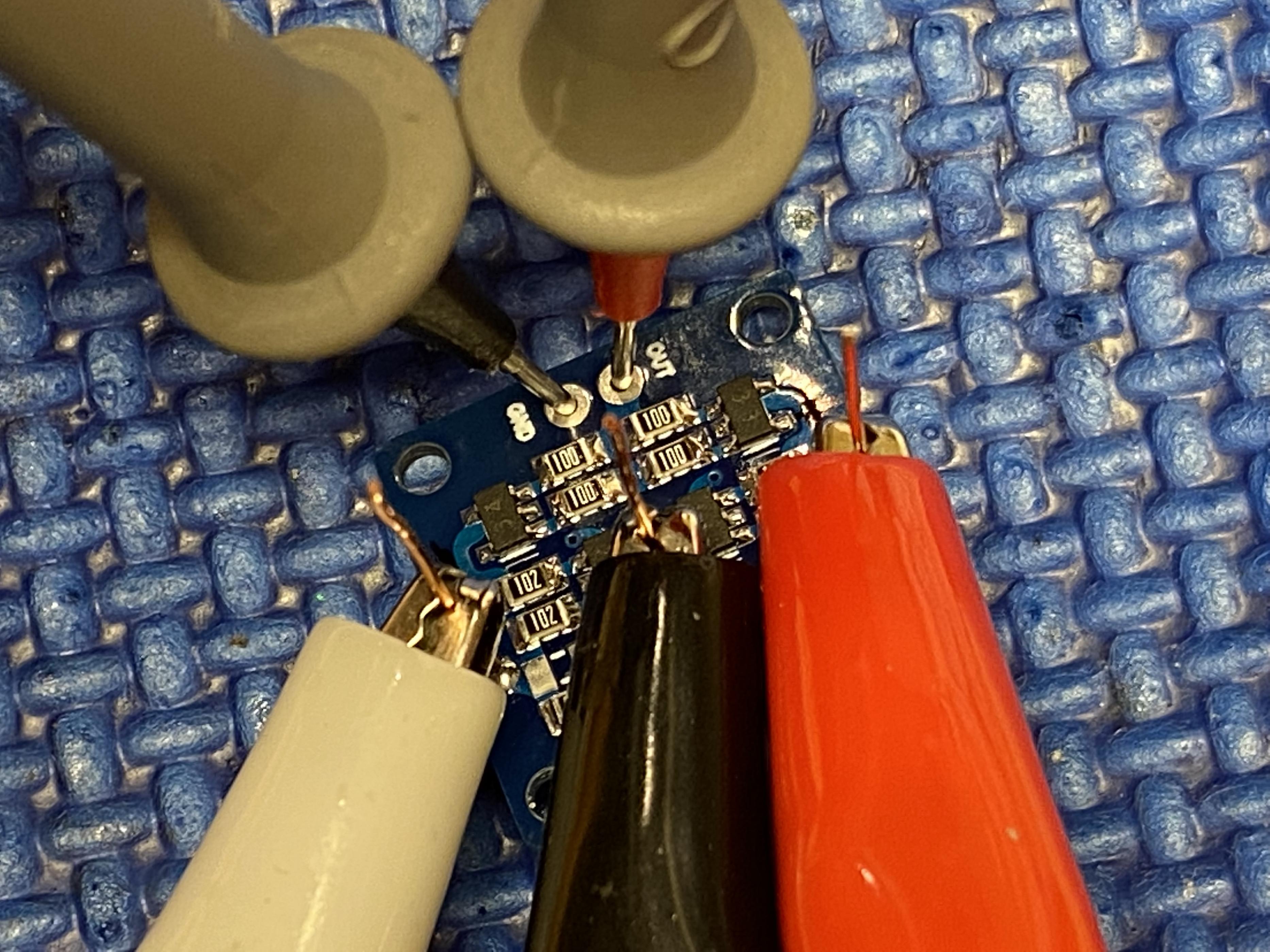

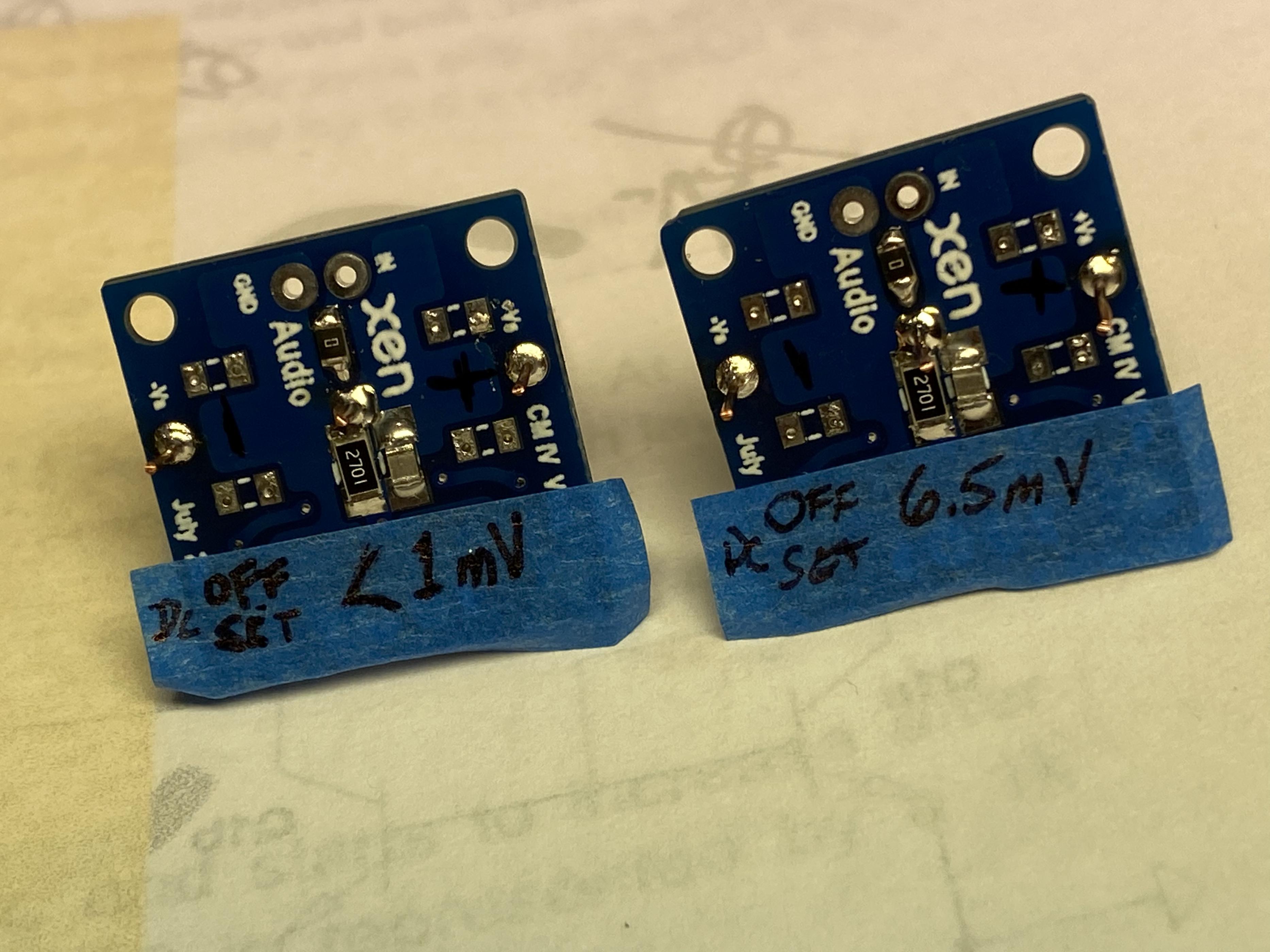

I’ve made some progress on EUVL’s Current Mirror I/V converter boards, one pair is soldered. Just checked the output DC offset using my bench supply feeding +/-12vdc:
Board #1 = less than 1mV
Board #2 = 6.5mV
These measurements are without any trim resistors installed! I’d say Ripster did a Fantastic job matching the transistors!!! Thank You 🙂

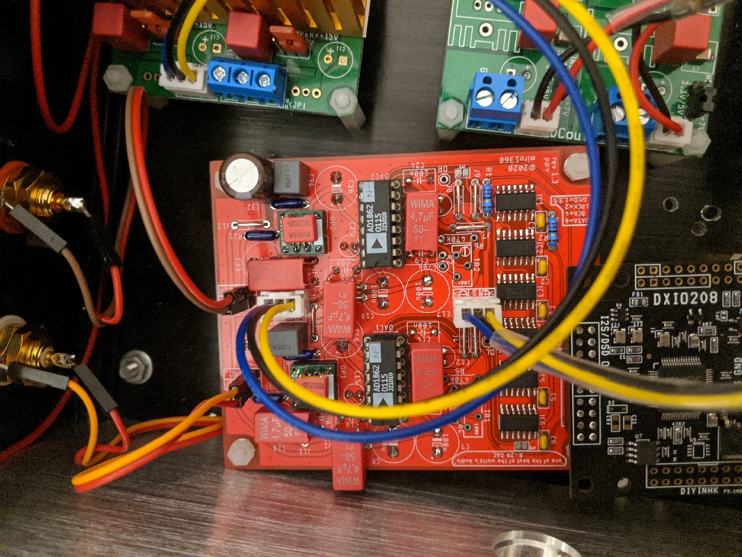

Today I have discovered a way to make my miro's AD1862 sound significant better. I am pleased to share my joy here.
I have been comparing the sound quality between my modded DIYinHk ad1862 and miro's ad1862 and have been frustrated to find that I always like the DIYinHk version better.
I listen to music but mostly I use family videos I recorded myself as a benchmark to judge the sound quality of my dac, because I am much more familiar to how my family members and I myself are supposed to sound.
With the same i2s input, the same power supplies and the same discrete opamp (ss3601 for miro's and ss3602 for diyinhk's dac), the two ad1862 dacs sound very much different. The diyinhk dac has always sounded more correct and enjoyable. I was admittedly disappointed because I was expecting improvement over my diyinhk dac that I had put together before the miro's version.
I started to investigate what might be causing the sound difference. I bypassed the 100R output capacitor, but there was no change in perceived sound quality. The diyinhk version has stop clock mechanism and separate digital and analog grounds, miro's version has a nice ground plane.

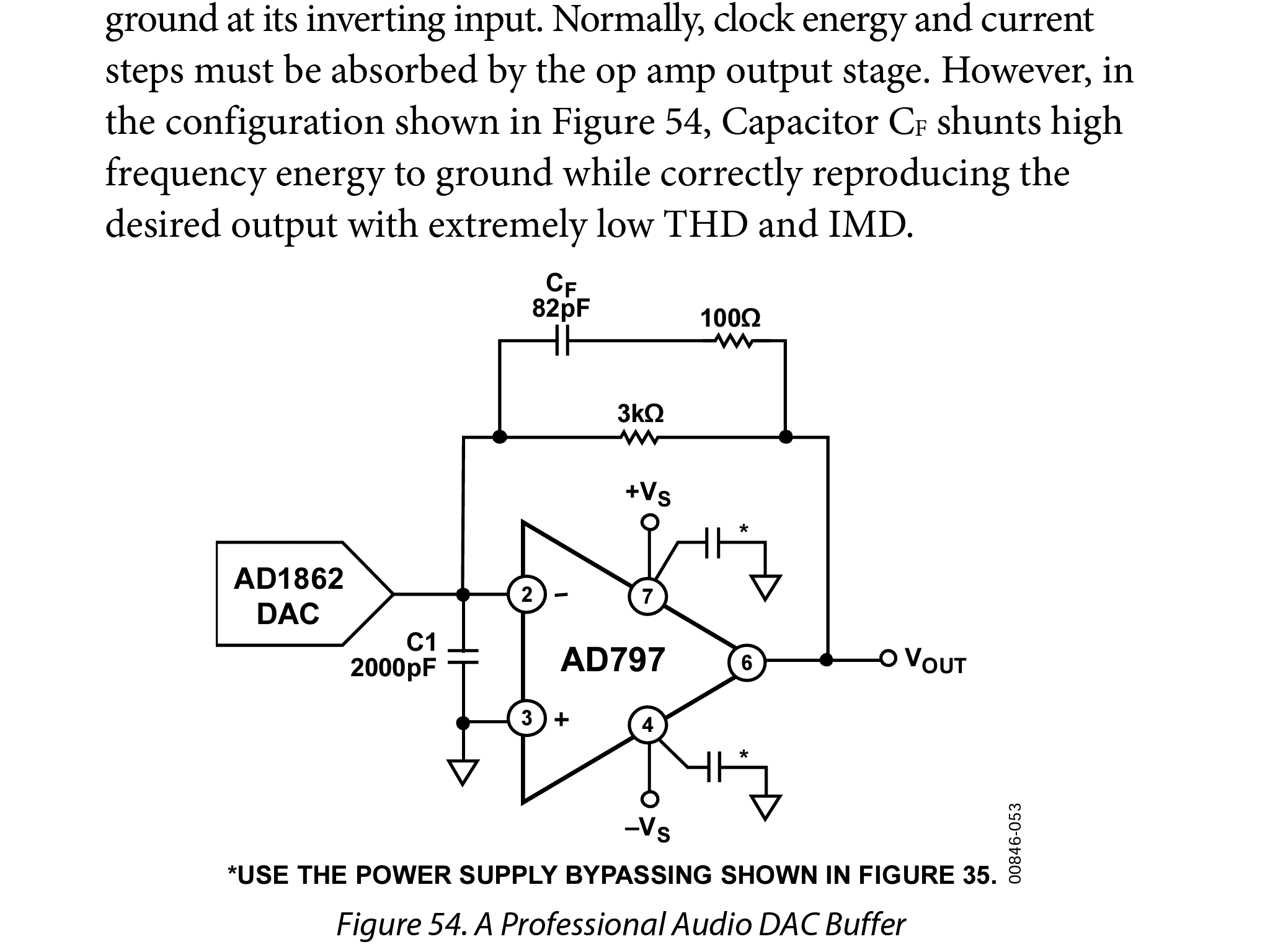

Would it be possible that the stop clock mechanism is the main reason behind the difference in sound? I studied the data sheets of the various opamps I have until I found this:
I was excited to see that shunt capacitors can be used to absorb clock energy and current steps and decided to try it. I didn't have 2000pf caps on hand. The closest I had were 0.01uf C0G and 1000pf Wima film. I tried the 0.01 uf first, but I heard oscillations. Then I put a 1000pf right across pins 2 and 3 of AD797brz and was pleasantly surprised to hear a nice and big difference in sound!
The sound is now open, smooth and fluid. The resolution has been drastically increased. It is as if I were seeing music with a magnifying glass. The front to back sound stage has clearly expanded. Music is live and 3D. Every song sounds different. A layer of hoarsness has been removed.
Now, finally I am not sure which dac I will prefer. So far the miro's dac has sounded best, but I haven't implemented the same shunt caps for my diyinhk dac yet. I will order some 2000pf caps to try later.
Anyway, I am full of joy now. Kudos to the engineers at Analog Devices who had designed the AD797, who had invented the stop clock mechanism and who had invented the shunt caps mechanism. And thank you miro and diyinhk for designing these nice ad1862dacs!

Hello Hidy,
Did you try 100R resistor as well? According to the datasheet:
"Optimum flatness and stability at noise gains >1 sometimes require
a small capacitor (CL) connected across the feedback resistor (R1 of
Figure 39). Table 6 includes recommended values of CL for several
gains. In general, when R2 is greater than 100 Ω and CL is greater
than 33 pF, a 100 Ω resistor should be placed in series with CL."
We are using 47pF in CL position, so maybe we should try 100R as well.
Regards
Laszlo
Sorry, the attachment was somehow gone.
In case it goes missing again, let it be known that my attachment is a screenshot of the schematics on page 17 of the official data sheet of AD797 (rev.k). It is also on other versions of the AD797 data sheets, but on a different page.
There they are again:
View attachment AD797.pdf
I haven't tried the 100r yet, because I am using 20pf now, a value low enough to go without the 100R. But I will try the 82pf plus 100R set up once I have a 82pf available.

@Hidy,
A cap to ground at the inverting input of an opamp may cause frequency peaking or instability. Good to be careful with that if it is deemed necessary.
Also, if you find the dac doesn't sound as good as the diyinhk version, well, that would concern me. I am not a big fan of diyinhk designs so far. Haven't seen one that couldn't use some improvement itself.
Thanks.
Using a bigger value of 0.01uf did actually cause oscillation.
I wasn't comparing the sound quality to the default version of diyinhk board. I have added 10 x 100uf muse caps to the power supply pins, which has improved its sound quite a bit.
