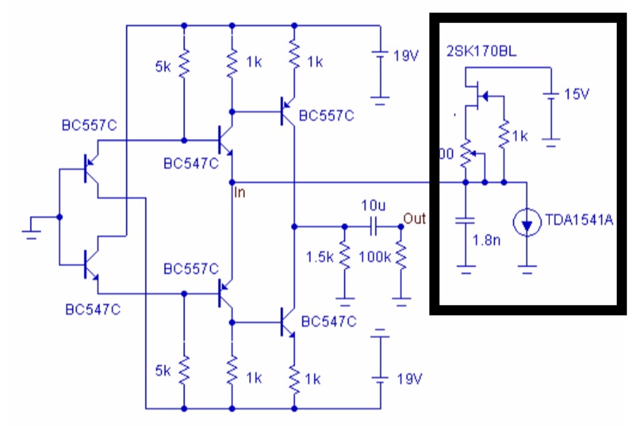

What modifications did you have to make to Rogic's output stage? I'd definitely like to give it a try with the AD1862. 🙂
Do you mean this?
Yes, thats the one. The modifications were:
2k7 for the IV resistor instead of 1k5 (well mine has 2k5 rhopoints, but use what is right for you)
You don't need any of the parts around the 2sk170 which compensates for the V offset of the TDA1541 I believe.
I got away without needing an output cap, one less cap in the chain by putting a bit of heatshrink around the transistors, filling it with thermal paste and heatshrinking it down to get reasonable thermal coupling.
I'm feeding it +/- 20V.
If you use different transistors, then you will need to verify pinout if they are different.
FYI - that board is quite big, and this IV stage could be made a lot smaller/compact if thats important to anyone.
woodturner-fran,
Thank you for the information on the Pedja Rogic
Discrete Diamond Non-Feedback I/V Stage. I’m going to give this buffer a try. Already ordered the board and a bunch of the BC557C and BC557Cs.
So I don’t need the components in the box in the attached picture for the AD1862?

Diyiggy got there before me - yes, its useful because you don't need the hardest to find part, the 2sk170. When you power up, let it settle for a little and check for DC offset - if matching and thermal contact is good then you won't need the output cap.
