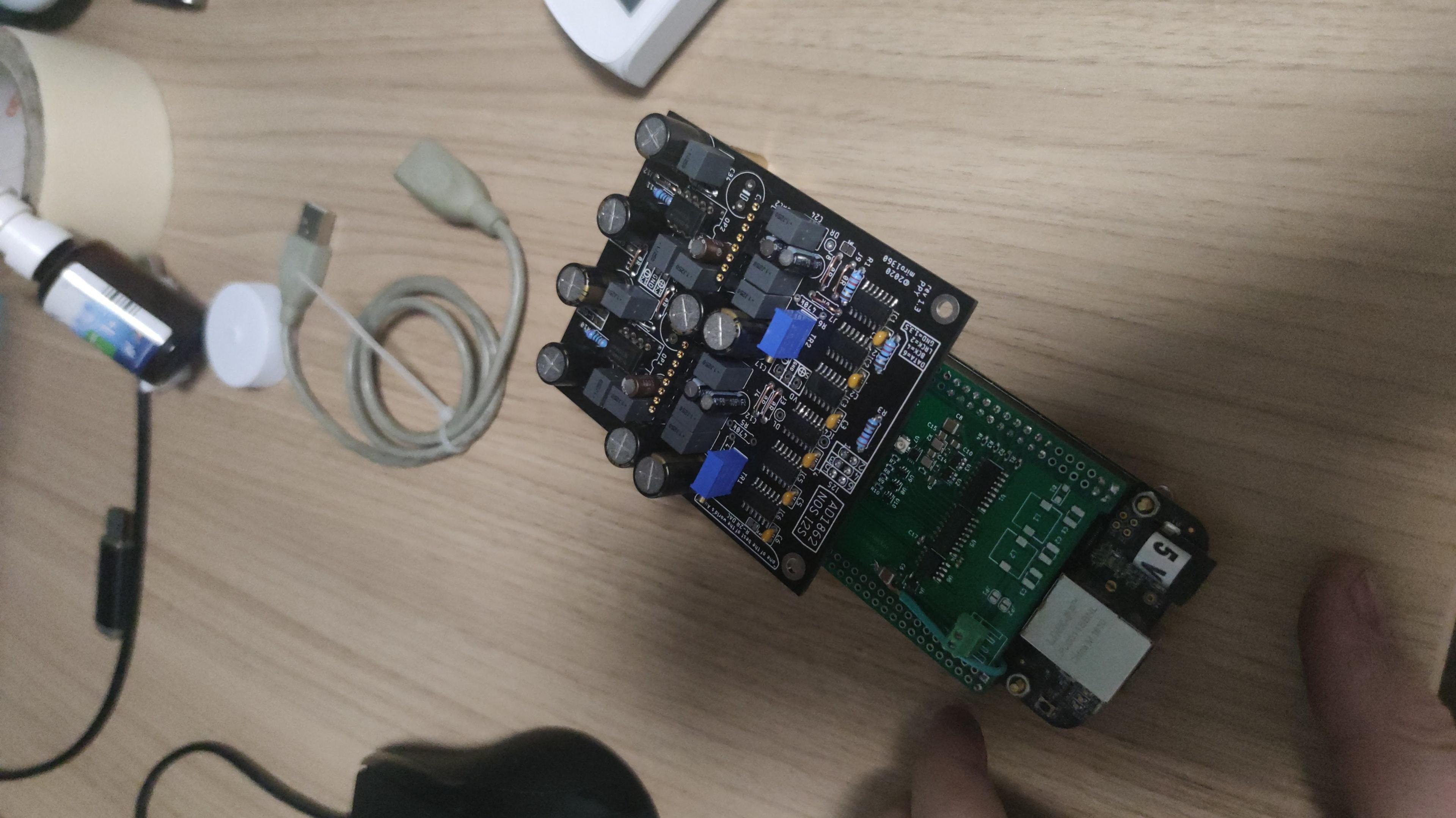

Thank you Miro.
I would like to buy PSU2.
Also I want to feed clear +5v to I2SoverUSB board.
Dose it make sense if I have another +-5v secondary or just
Share from PSU2?
I don't mind if I pay extra money from Japanese Rcore tranie.

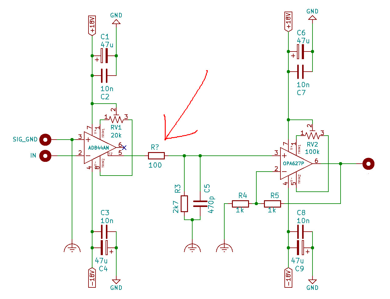

The network I am currently using is similar to the single AD844 version in your link. The issue with the AD844 is that it often has instability issues with capacitors connected directly to ground, that in your link is 470pF. These issues stopped if a series resistor of > 50 Ohms was connected in series with pin 5, hence I use 100 Ohms between pin 5 and the capacitor.
I used a styrene 470p and didn't notice stability issues with the AD844. Do you mean I should add in any case the 100R as in the attached schematic?
I would. I normally test devices and networks without local power supply decoupling in order to determine the sensitivity to instability. With a capacitor of value indicated (and mine are polystyrenes as well) it was found that oscillates occurred at pin 5.
In general if power supply decoupling becomes necessary to stop oscillation they are considered active of coupling power supply anomalies into the audio signal.
Thank you! But I still failed to completely understand it... Even if instability would occur without local decoupling caps: why is it not OK to use decoupling caps if that helps? So many datasheets recommend to add a cap to avoid instability, now I hear that this is kind of a "dirty" solution...?
Local supply decoupling caps close to the supply pins of the IC are a must if you want to keep your supply rails clean and prevent ground bounce. Both these things can lead to other mishaps, such as false triggers (0>1 and 1>0) due to noise on the supply rails or a shifted ground level.
