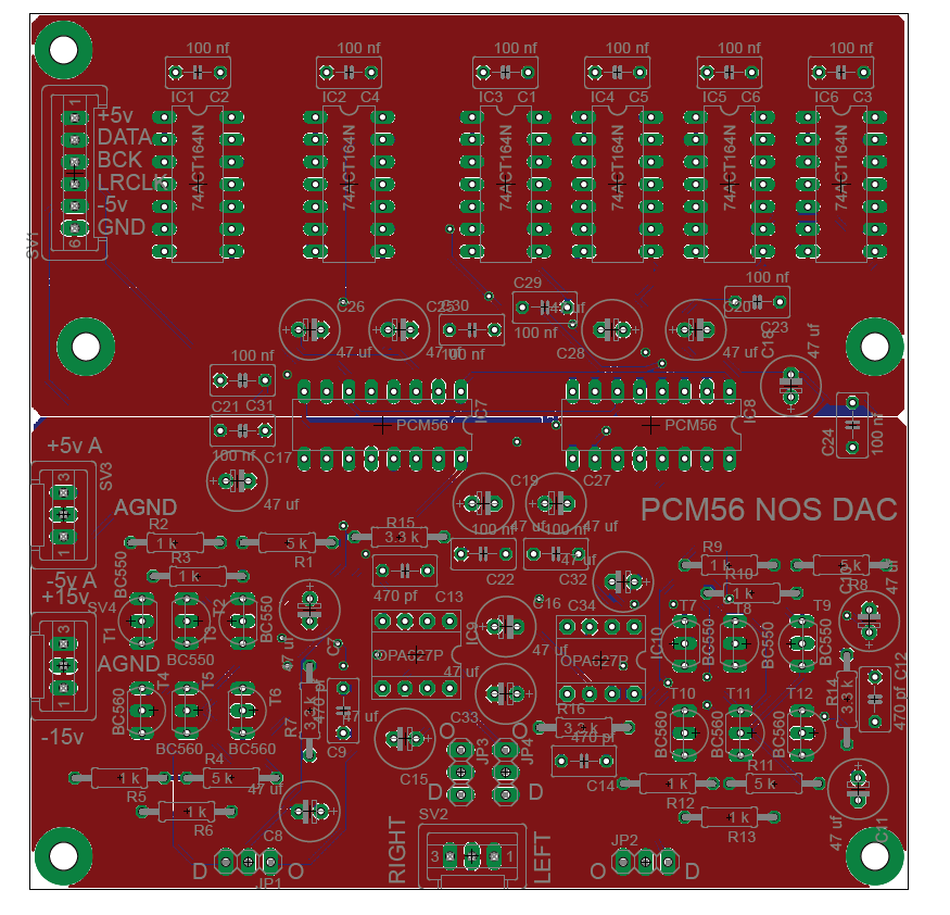

I used to have (and still!) something similar to this dac. It's based on pcm56. We have a small diy group, while sharing some ideas about old dac chips we decided to design something with pcm56. This was three years ago.
Long story short; If we use high value gain resistor sound becomes tiring, anything higher than 1.5kohm was a drawback. As I see 1862 has the same current output value as pcm56 and similar other dac chips from same era.
Anyone has any measurement or feedback about this?
I attached old design we used for pcm56.

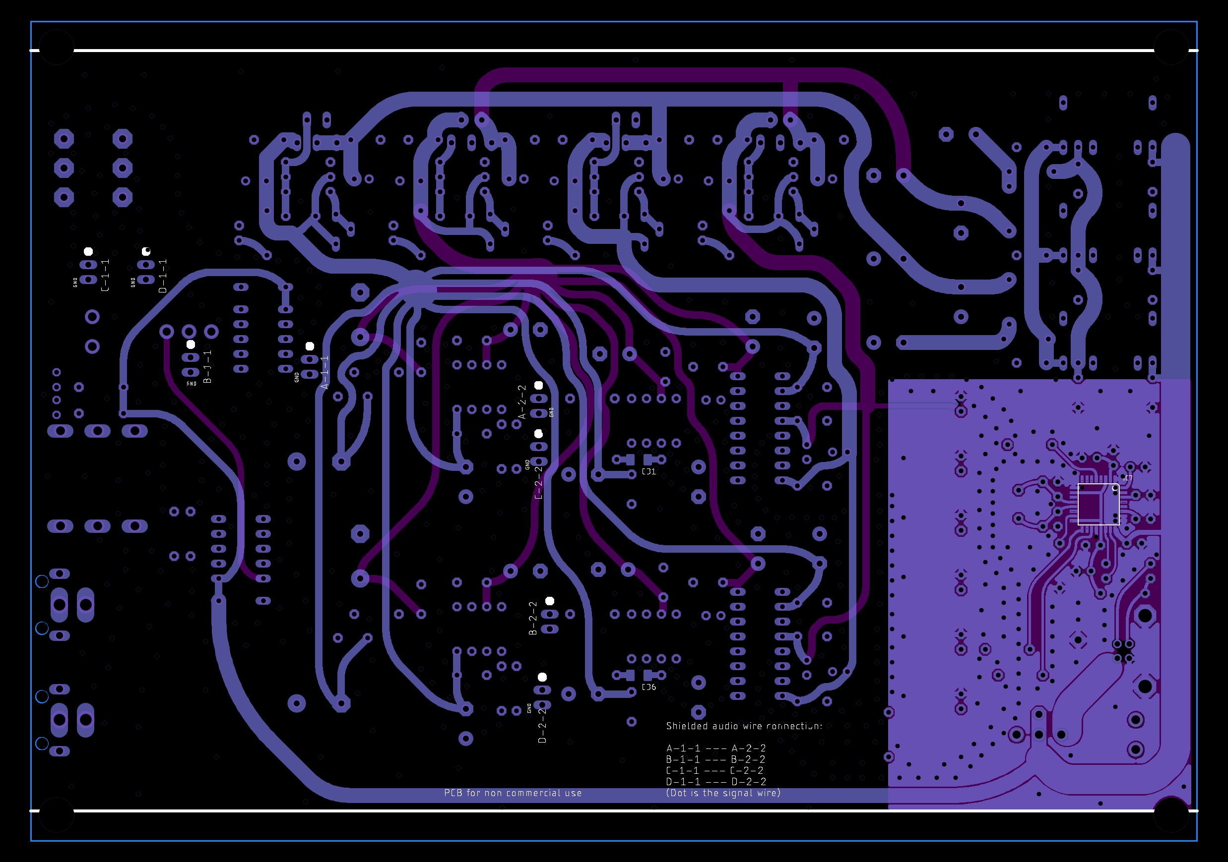

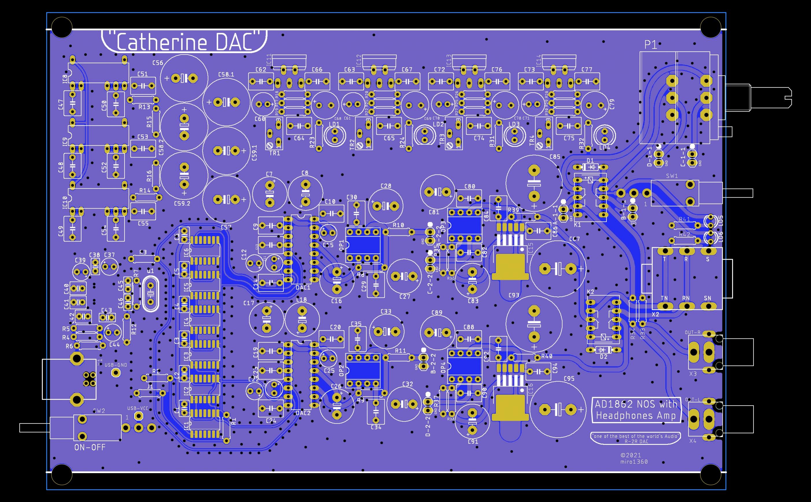

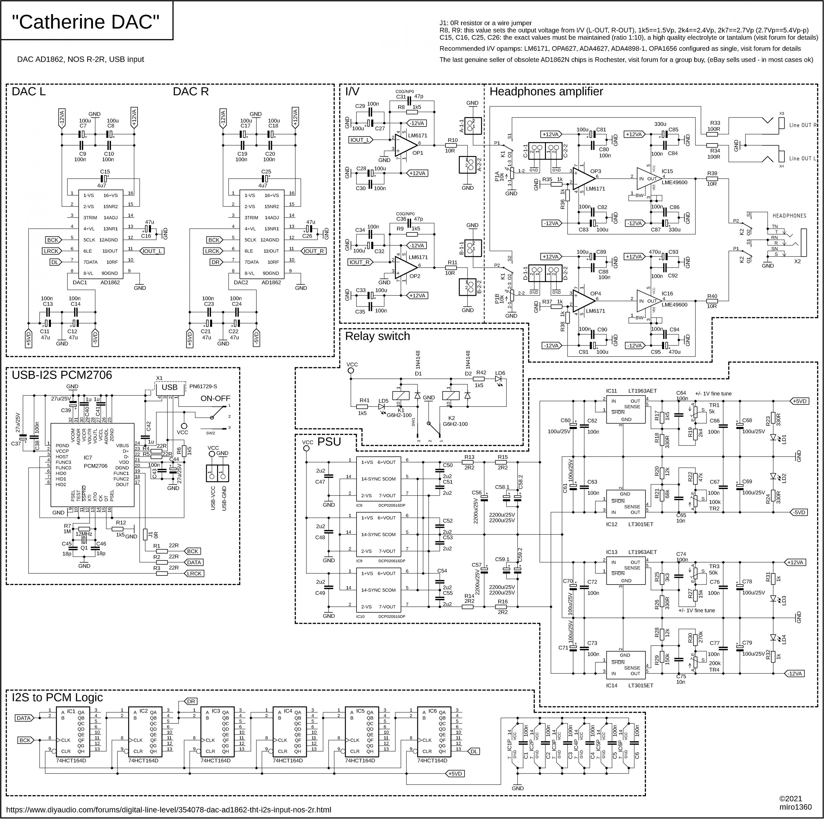

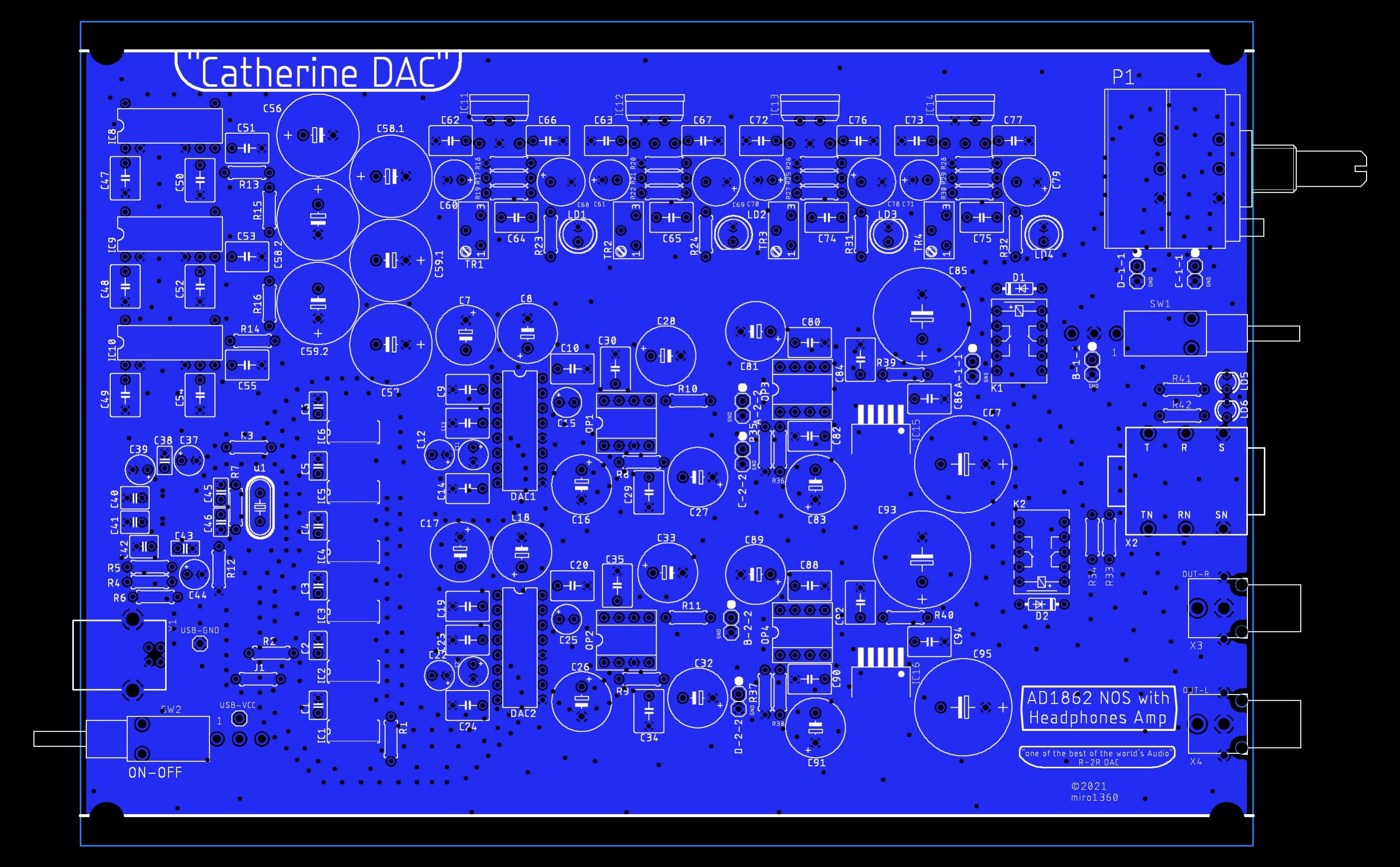

Catherine DAC preview
Catherine DAC originated as a project for my purposes 😎
It is AD1862 NOS almost THT DAC, completely USB powered with line-out and headphones amplifier, sourced with a decent power supply (800kHz DC-DC, CRC, LT1963/LT3015).
Headphones amplifier is the LME49600 buffer (sourced from the opamp = preferable opamp sound can be easily maintaned).
Integrated USB-I2S is the PCM2706 (only 44.1/48kHz 16-Bit, but any preferable xmos board can be "glued" to the PCB).
The PCB is 4-layer 140x200mm and easily fits into a cheap eBay enclosure (ebay.com/itm/333940934162) or any DIY enclosure.
Having a bug in such a larger PCB is not funny 😱, therefore I'll test it first. I'll share the gerbers after testing, it can take a while :snail:
The price for premium parts is quite high, but still better than delta-sigma premium filters :yuck:

What if the relay was noy between the I/V but between the second oap and the headphone buffer ?
In others words, does the main DAC goal to drive a pre line not deserve its own non relay path ?
Relays can be sometimes seen as I2S/USB input choice for versatility (a merge of the two before designs)

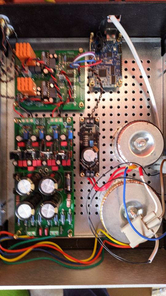

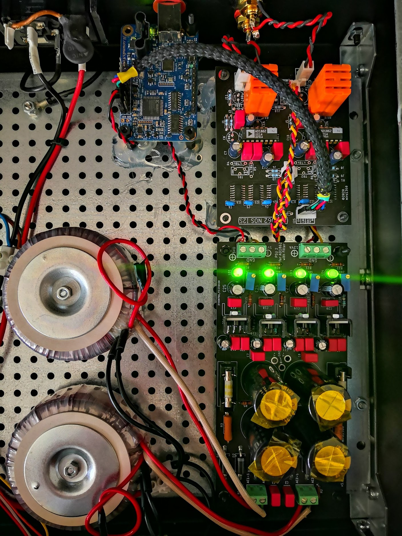

My current setup, just finished miro's PSU. First fedex lost some parts then I realized I ordered wrong trimmers with pins in line so I had to do some bending to fit them but now everything is assambled and working.
I would like to try some discrete diy I/V stage and tube next...
Hi Ripster, close to my arrangement, just mirror inverted. This gives the opportunity to shorten the i2s cables, while keeping the transformers off the DAC board.
I am waiting for a crimp tool in oder to make shortest possible cabes for that. And waiting for an ICE inlet.
Like your usage of hot glue. Never seen that.
🙂 I like Pan FC on Ripster's board and the polyswitch is pretty cool
I like the short I2S connection from Ernst's board

The feedback needs to be disconnected.
Anyway, the headphones output is technically the buffer or preamp, which can theoretically drive the amplifier.
Is there a load input windows where the LM49000 is working better; e.g. 60 to 1000 ohms ? 32 ohms to 50 K ohms ? (numbers just took as an illustration)
What is please the purpose of the second LM after the first in the headphone aop input ? I never understood thetechnical purpose of several oaps after an I/V, it's above my head 😕, though see it often in the old cd players.
LME49600 deals great with impedances and capacitive loads 🙂
The second LM works together with LME49600 as the headphones amplifier (it has own feedback).
>>I never understood thetechnical purpose of several oaps after an I/V, it's above my head , though see it often in the old cd players.
It could be active filters 🙂
