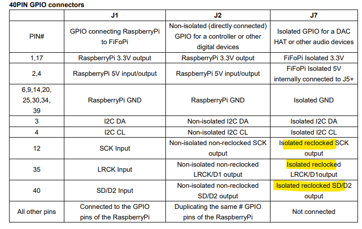

I think the hat which is reclocker is ok and in pair with external usb about the jitter as both are asynchronous. The hat is even better as the signal is partially buferred (fifo ). What I wanted to highligth is the GPIO is not reclocked imo just has a galvanic isolation. So as you say, the clock is comming from the unique 15 Mhz XO reclocked by the intrnal FGPA of the Rpi. This should not be seen at this level of DAC quality 🙂 , cause it's big waste imo. Hence I said it could be enhanced by taking the clock from the uf-l which are the only reclocked I2S outputs on that hat ! And also Ernst had a problem with one of his Rpi clock as well : no sound !

GPIO i2s
I just checked Ians documentation of the FifoPi and it says, i2s gpios are isolated and reclocked.
cheers, Ernst

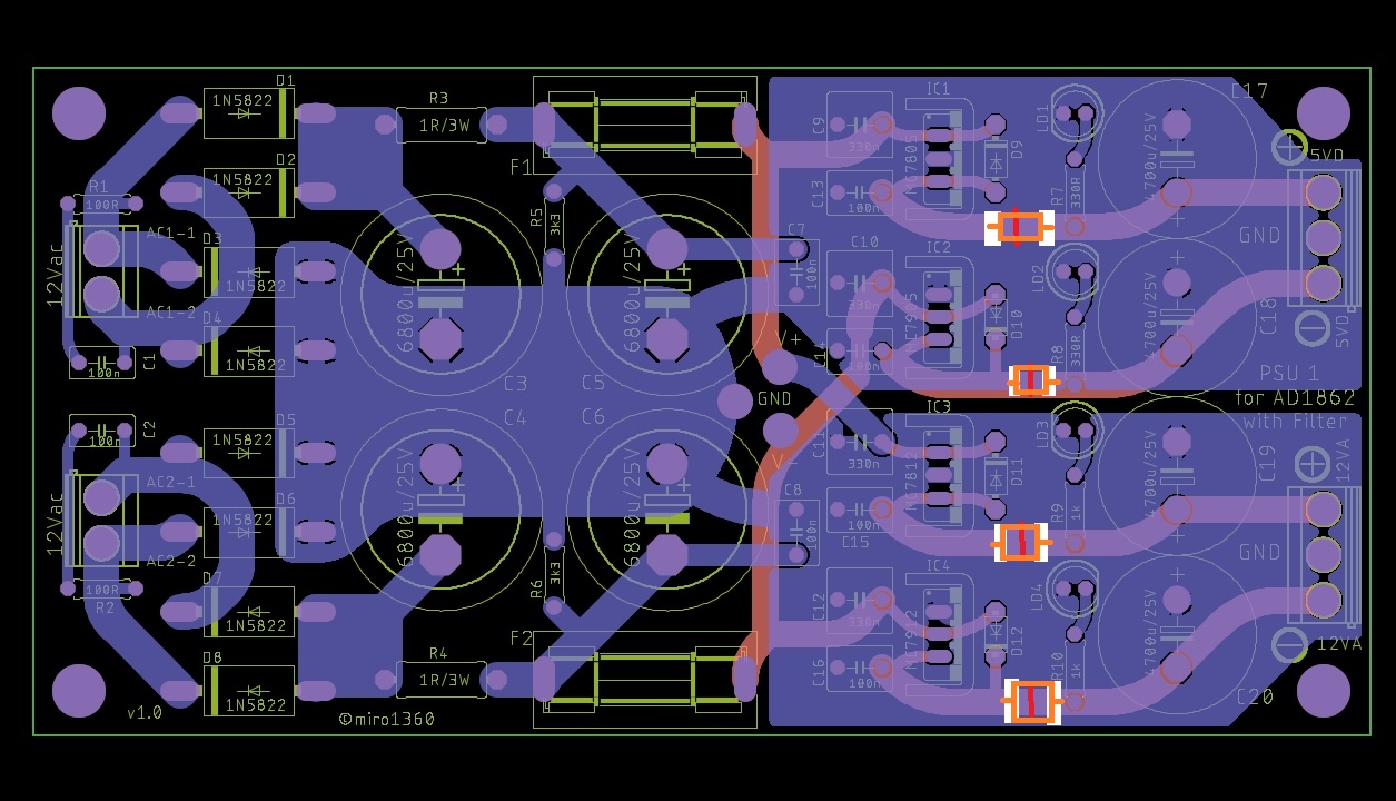

Sorry if this question has been covered, I couldn't find an answer above.
I've built a couple of Power Supply 2s, which work nicely, and also an 1865 DAC which I haven't fired up yet. The 1865 board needs VData +5 VDC and VAudio/analog +/-5 VDC. The schematic doesn't indicate that VD ground and VA ground are independent and the meters showed these pins to be connected together, so as part of the pre-chip-insertion tryout I fed VD+ and VDground from VA+ and VAground, respectively.
The power supply definitely didn't like this, acting as if there was a short. Meter says no connection between VD+ and VA+. There's a little conduction between + and ground on VA and VD, and between - and ground on VA, I think as the filter capacitors charge?
Any ideas why this isn't working? I'm happy to use two separate power supplies if that's the answer but also want to learn what I'm missing here.
@Paddy
Most LDO regulators don't like a high value of low-ESR capacitance on the output. When two rails were connected together, capacitor C11 increased total output capacitance and lowered the ESR for the LDO power supply, which apparently created the problem :Ouch:
It is hard to estimate the maximum "limit" for capacitors, and if such problematic situation happens, jumpers on the PCB (on power rails) come in the play - resistors are used there (low value like 2R2, 3R3). Thanks to this resistance, the power supply is then stable for a high capacitance.
Regulators 78xx/79xx have an emitter folower stage with no gain, so the big output low-esr capacitance makes no difference to the phase shift, thus stays stable for high capacitive low-esr loads, but the drawback may be higher noise :crying:

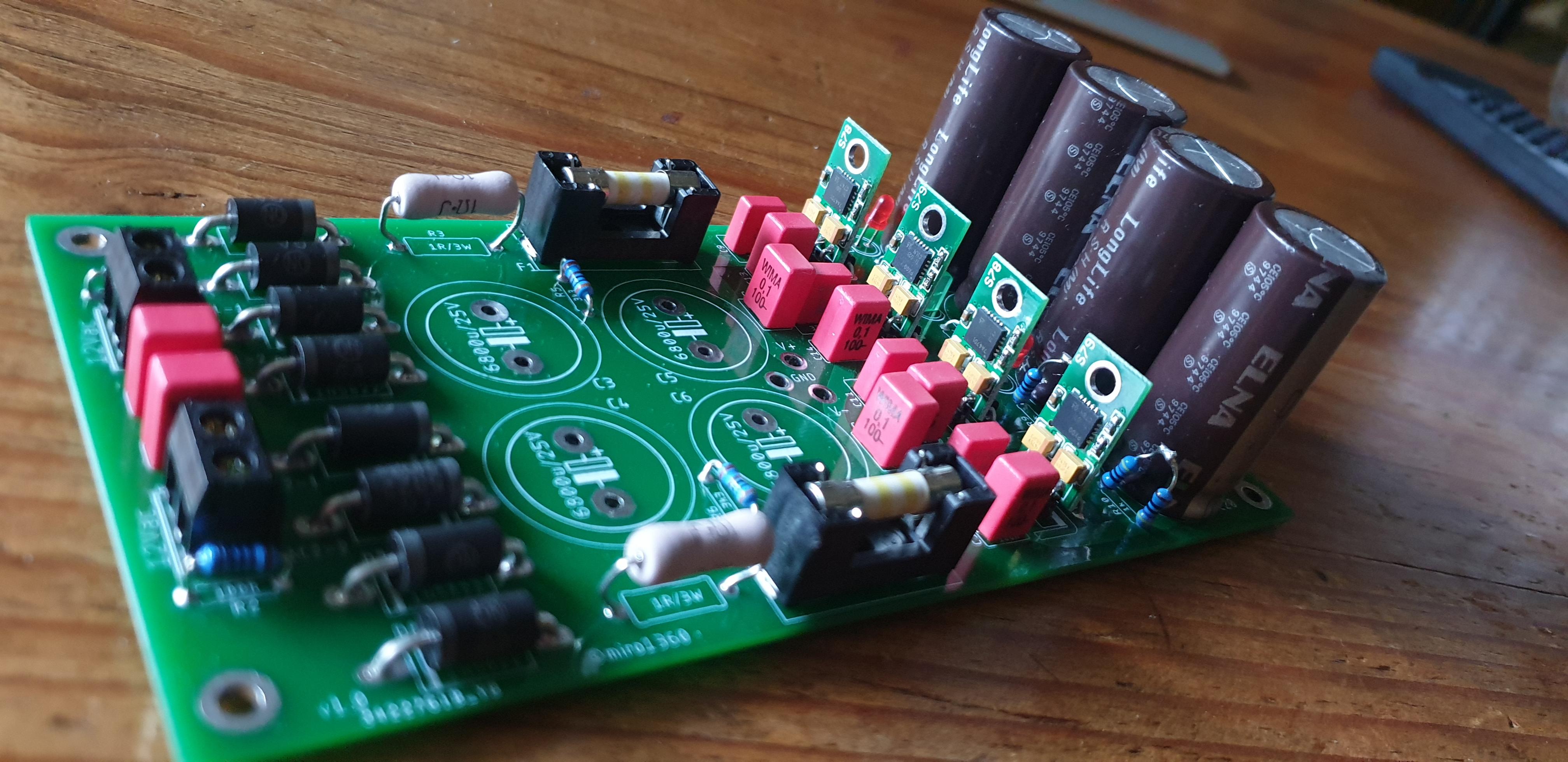

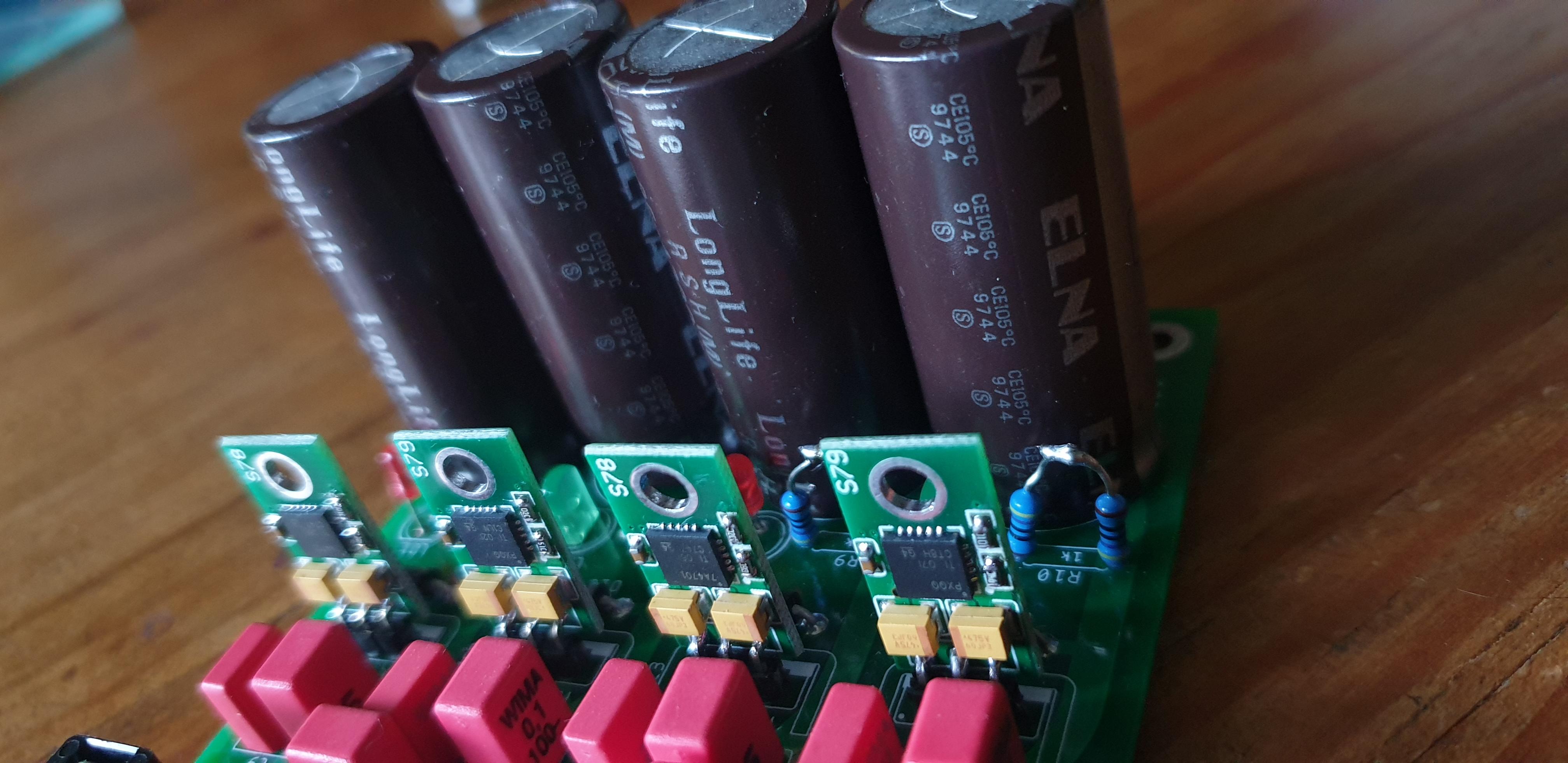

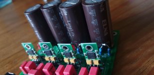

Interesting reading on the PSUs there. I have built a PSU 1 hot rod using Aliexpress regulators that use the Ti TPS7A chips. Have had good results with them in my Cambridge Audio Dacmagic.
I was thinking just recently if the 4700uf on the outlets would suit them . Have read the datasheets.
I guess I will try the PSU with them and maybe with some lower values too.
I don't know why but I always found them better than the more often seen LT304x... Go figure why ?!😕
@jimk04 ... you did very nice mod on the PSU 1 :happy2:
There can be instability with TPS7A regulator, because there is not output resistor in the functional block diagram. If you find any instability (check with scope - during start-ups, during different loads), just scratch the top soldermask, break traces and bridge the traces with 2R2 or 3R3 resistors 😉
