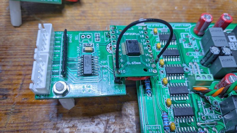

This is something I've been working at over the past little while. It's a low cost i2s switch from AliExpress, with a d-type flip flop on the output to reclock right before the DAC. My previous experiments were just seeing how it all worked (it did) but I haven't actually tested this arrangement just yet. The idea was to eliminate as much of the wiring as possible and allow 2 sources to be used with one DAC, in my case USB and an SD card player.
Unfortunately those nice potato flip flops are gone, but this TI chip is handy in that the inputs and outputs are lined up opposite each other on the chip. Both the switch and flip flop will run from either 3.3 to 5v which is handy.

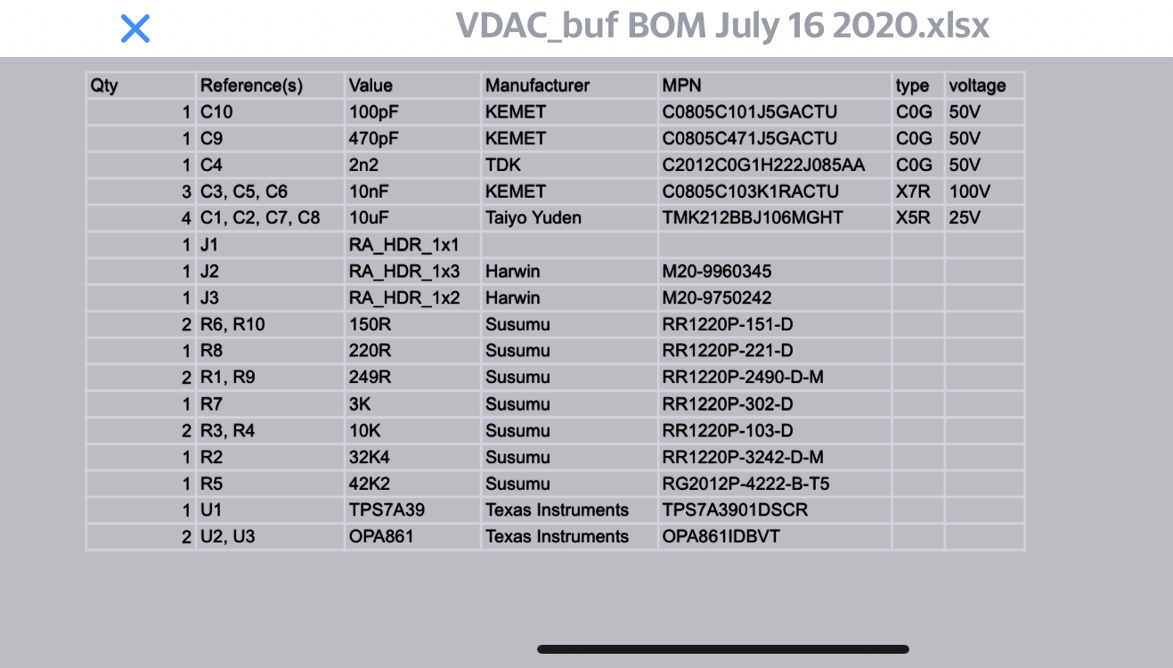

You can experiment with different film caps like Diyiggy suggested, but keep the required package size as per the BOM. Susumu RR, RS and RG(for regulator section).
Jimk04,
Your correct in thinking the TPS7A39 regulator is the tricky piece on this board. That would be nice if JLCPCB would pre-populate that for a reasonable price. Maybe if enough of you in the EU wanted the boards, the service would be doable.
Enjoy!!
:cheers:
Ps: Sorry Iggy, I didn’t have enough time to create the giant Bordeaux bottle that Miro did, Cheers anyway 😀😀
Pss: Get the pcb’s with ENIG finish, easier for SMD soldering.
