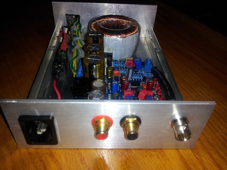

BNC Box almost there.
Need to wire two LEDs to leads in power switch and fabricate cover. PCB and toroid are just on double sided tape as new R-Core should arrive in a few days.
If the jumper from board to socket needs more shielding, please post. It will be a fully metal enclosed box when completed.
Also, not sure what to do with AC earth/safety ground as it relates to the BNC ground. If earth gnd is attached does the BNC ground need to be isolated?
_
Yes ! Please isolate the BNC from the case. BTW I am not an expert but I think it would be beneficial to use a SPDIF transformer if the DAC is going to be connected with a computer as I see a ground loop there. Maybe a more experienced computer audio enthusiast can shed a light on this ?

In my TE7022 board which is sold on ebay as an USB - S/PDIF converter, a miniature transformer on the S/PDIF output is present. So it isolates the ground of the computer or laptop.

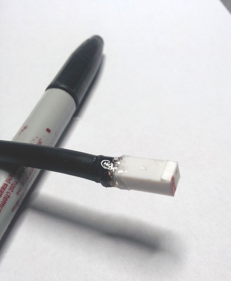

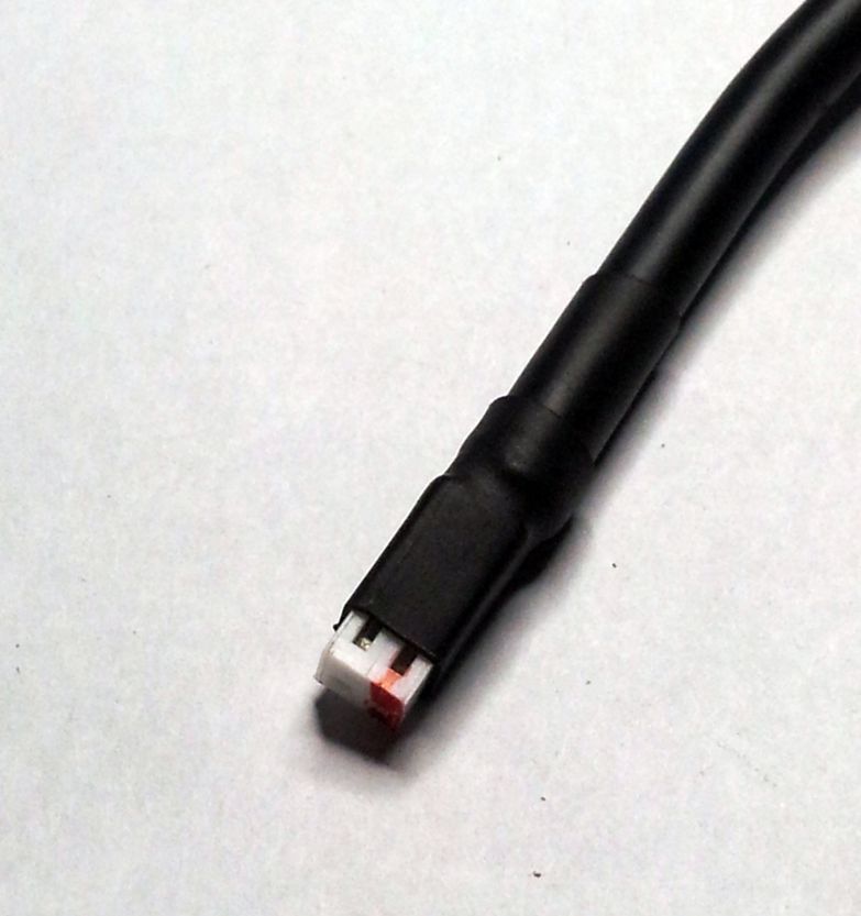

First row Left to right:
1. RG-59 soldered to gold plated posts in socket. Goop silicon for stability.
2. Heat shrink for added protection.
3. Hot wire soldered as short as possible.
4. More Goop.
5. Pin out location.

1. Pin closeup.
2. Adapter installed. Had to trim/shorten shell to assure good pin contact.
3. From the back.
4. Yellow RCA is regular S/PDIF out - above Toslink socket. Got all bases covered now.😉
5. 18 ft 75 ohm cable with compression ends. Wire was $0.26 / ft from Home Depot. Also made a 2 ft for less remote component placement.
