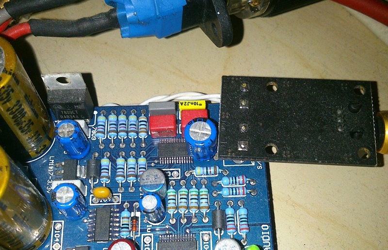

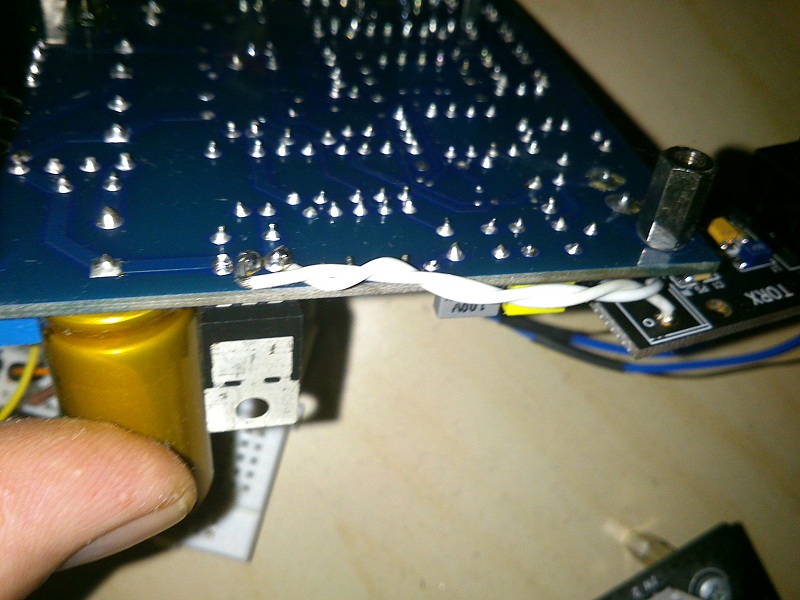

It needs a regulator and a couple of passives.
Better thing, IMHO, is buying this module:
TOSLINK Optical Input to S/PDIF Module | eBay
I'm using it and I can't tell the difference Vs a very good quality coaxial cable.
Looks nice. What is supplying the 6-20V and what voltage did you settle on?
I'm using the 9V output from digital reg.
Still not quite clear. Can you post a pic. Is that a separate unit or are you saying 9V can be found somewhere on the DAC/Dac circuit?
Great, I'll order one and build a rig where I can test/compare both approaches. Already have standard Toslink out on Music Server PC motherboard. 😎
Thanks !! :
