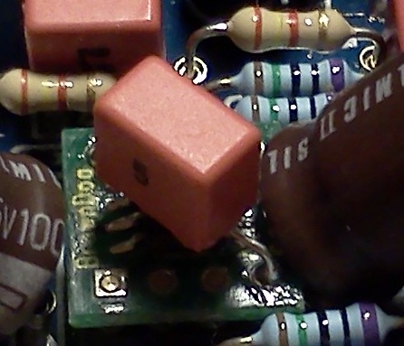

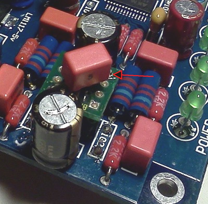

Just a little warning where it applies. The quality of sound had dropped significantly today. With some fiddling and prodding, I found one lead on the cap attached to the Brown Dog adapter had come loose. Re-soldered both leads and the problem was solved.
So I'm just suggesting for those who are moving the DAC around a lot, remember that's a vulnerable spot due to the small solder area involved.😉

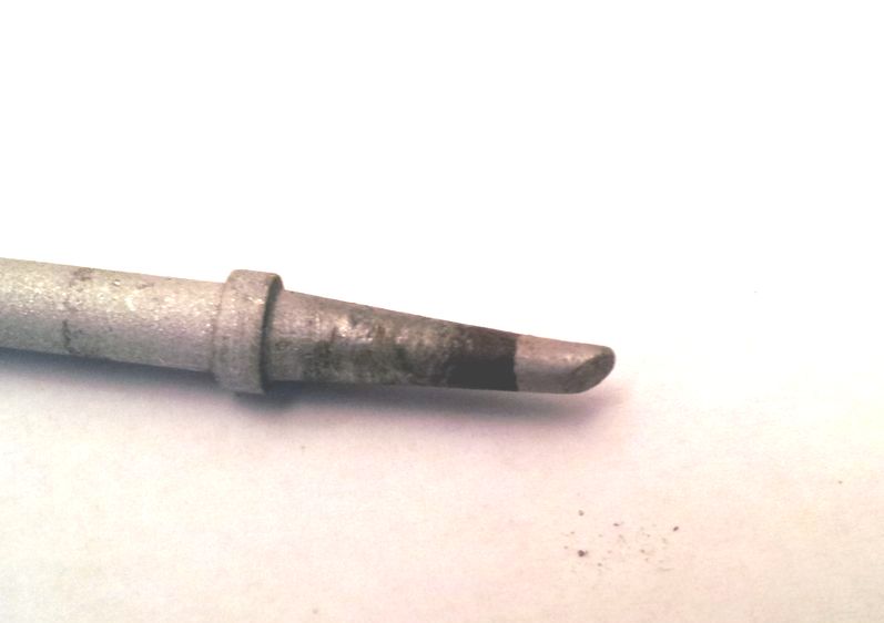

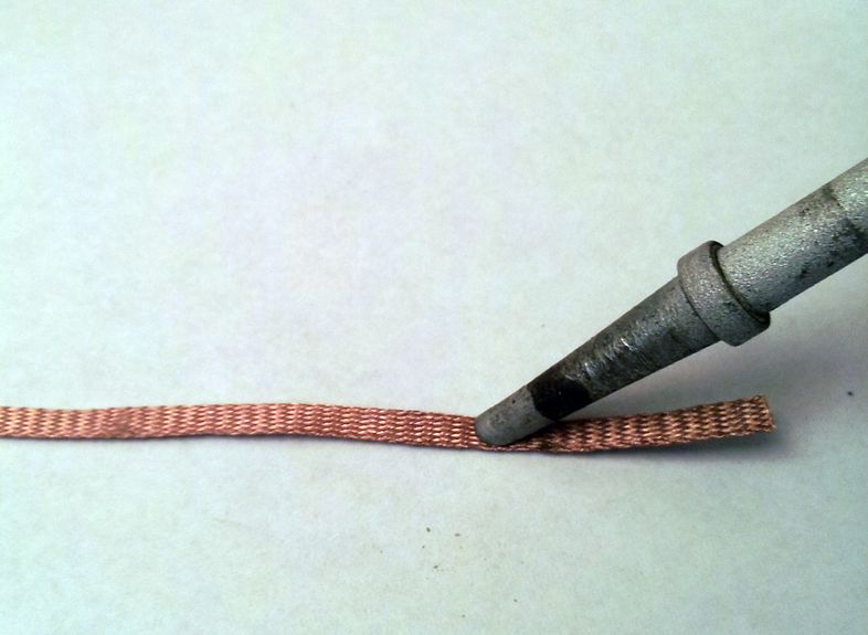

My best method - still not having a de-soldering station - is to use copper braid with lots of liquid flux to soak up as much solder as possible. It is important to let the braid heat fully and slowly draw it across the pad/lead end. Be careful to not pull the braid off if it has cooled. It will take the pad with it. Just reheat till you see it start sliding again. With some practice, parts need very little heat for final removal.

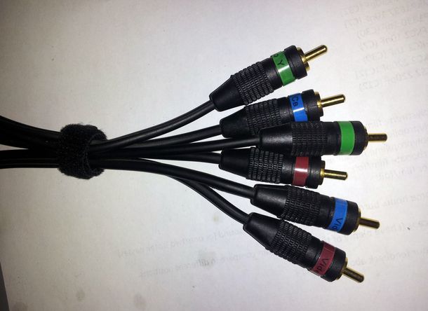

Got several excess RGB cables in the stash that can be sacrificed for the short chassis to PCB and MB to socket links.
I think this would guarantee 75 ohm over the path.

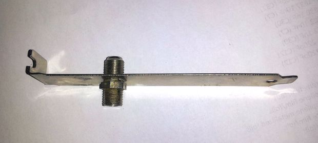

Correct. Any connector used fro video is fine. Like the BNC connector (you can get it way cheaper than Mouser). The F-connector is also fine. But the problem is not the plug. The cables are....
haik, Isn't something like a stock compression (not crimped) end interconnect of the quality the cable companies use acceptable? Those wires hold 75 ohm over long distances and I would think usable in a 1.5 to 3ft (maybe much longer) connection from a PC to a DAC.
I was also looking at RG-179 (Nom. O.D. (in) 0.100) for the short jumpers - if if can be found/purchased in small lengths.
