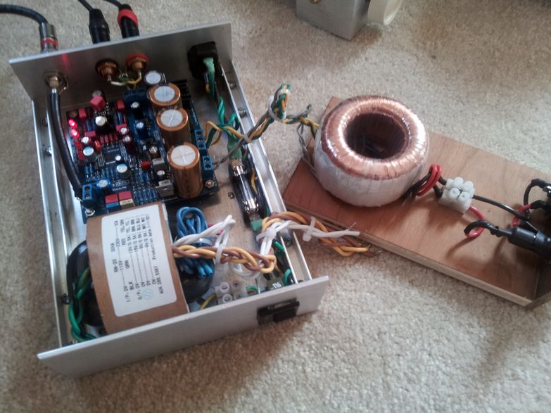

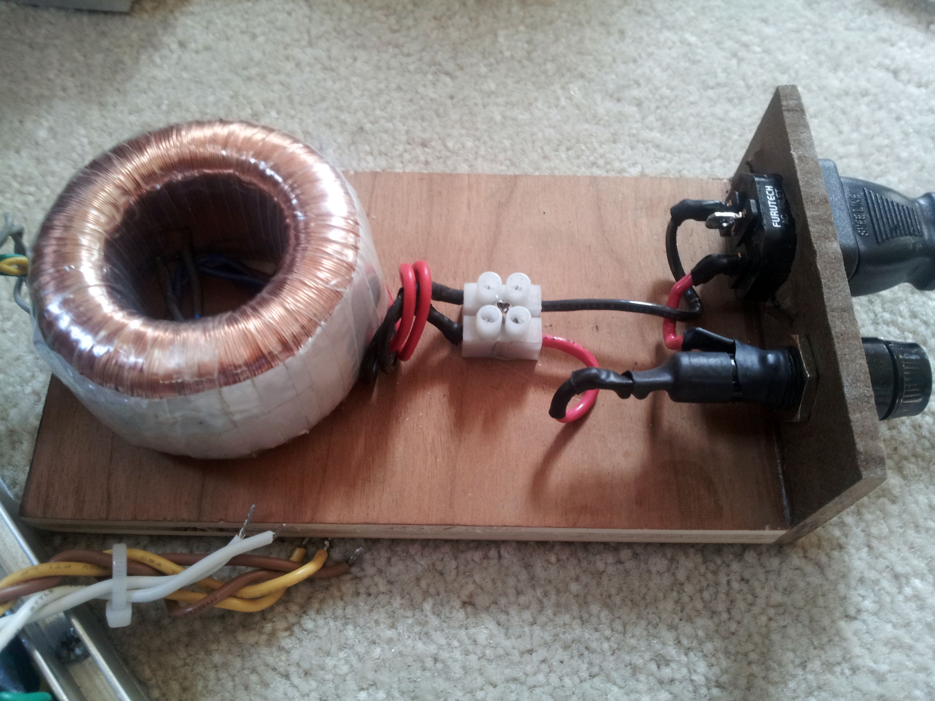

I did the A/B between toroid and R-core with very pleasing results. It wasn't just my imagination. The difference clearly appears in both more clean air between the instruments and the trite phrase "removes a veil between the listener and the music"
I used the occasion as an excuse to download a small bundled 96/24 version of Shostakovitch Symphony No 9 from DH Tracks. It's got everything from sparkly bells to big brass and a giant bass drum. The toroid produced a sort of "ghost ringing" - and the beginning and ending of notes wasn't as accurate as the R-core. To my ears, the timbre of everything is simply closer to reality. The low notes retain their power and heft but are better focused using the R-core.
I'm convinced.

Bob, thanks for sharing the results of your A/B test ! I should have asked about R-core vs toroids earlier on. I noticed Dario chose one way and a few builders chose the other, but I didn't think much about it. (And of course, I bought the toroid -- it looks more "audiophile" !! One of the joys of being a beginner, I guess ! )
Jean-Paul, you mentioned decreasing transformer noise using "ferrite cores and such." I'd love to hear more specifics, as related to a DAC build such as this. (I'm assuming a ferrite core can't make a toroid sound like an R-core, but I like to include refinements such a this when I can).
