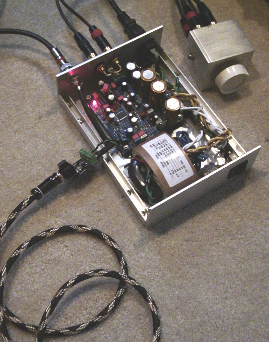

To my ears, there are enough differences between optical and BNC feed to clearly hear what's being used. The optical is quite a bit cleaner and precise. That comes at the cost of a good amount of "flavor" that flows over BNC/RG59. The optical sounds like the speakers were moved 3 to 6 feet away from the listener while BNC sounds like your inside the performance if the recording has that character. What is most noticeable to me is the reduction of the bottom end with optical. It will take more listening to figure out if that is simply less or a better balance. Cymbals in a jazz group are crisp and wonderfully detailed but lack some inner resonance.
The Toslink is very sensitive to a bad/loose fit in the socket and the LEDs on the board flash intermittently at plugin, as though a sync operation is settling in. BNC is as solid as can be with it's self-locking/self-aligning design. For a good comparison, I used a 20ft Toslink as the BNC is 18ft. I will move the computer closer to the DAC/Amp to test with standard 3ft interconnects in a day or so.
I'm sorry to keep doing this, but I honestly don't know which I prefer at the moment. I am suspecting there will be a difference in ear fatigue over long sessions but that will take a few days to determine. I'm still thinking the extra circuitry needed at both ends of the optical link has to do some filtering in the translation to and from light. That's two extra steps.
So in short - IMHO, the Optical sounds like a very precise and detailed high quality audio system. The BNC - though maybe a touch "messy" in comparison - gets my vote for warmth and realism. Oh the choices.
One thing I am sure of - the combination of the Mini2496 and the FE amps is great if the sound of interconnects can be heard so easily.😀

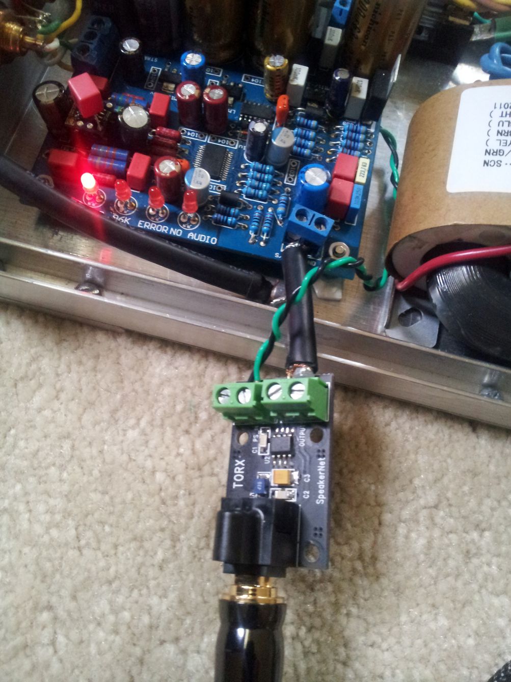

Forgot closeup. And after a couple full orchestral pieces that signature "James Bond" effect (master movie mix) sounds spectacular on the optical. The bottom is definitely present but for the first time in months, I though about hooking a sub back in the system. The fingers and crack on harp crescendos are just super
The way you power the toslink receiver, the wire distance, the type of capacitors used, and the grounding method will all contribute to the sound of the optical input. I think you could push the toslink to sound better with further experimenation.
Hey erin, no doubt some adjustments could be made. Do you have any suggestions on powering alternatives and grounding? I hadn't planned on using the screw terminals that came separate with the module, but did so for convenience in swapping for the comparisons. As Dario pointed out this piece, I will defer to his experience and curiosity about changing the parts on the module. I don't yet have the knowledge to make those calls.

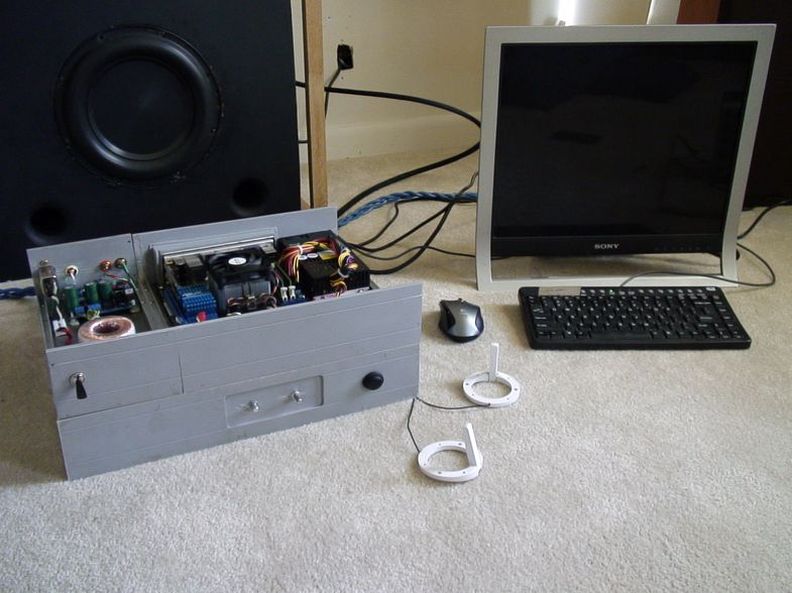

I put my integrated build on hold when the FE process started but most likely will put all components including a computer in very close proximity to keep all interconnects as short (inches) as possible.
The optical in no way sounds bad and I hope I didn't give that impression. Quite the opposite - it feels like choosing between two excellent technologies based on subjective preferences and associated equipment - again. I honestly don't think I'll ever find the "perfect" system but will end up with a couple of options tuned to the current need - 2 ch stereo for music vs 5.1 for movies, adding or removing a sub based on program material - as examples. To me, all the DIY helps maximize/optimize the various elements. There is a good possibility both optical and BNC will be available in the final mix.

I'd put a solid organic cap on the power input to the toslink board (where the screw terminals are).
Also replace the coax with solid core cat5. If you try this let me know what you think.
I have plenty of cat5/6 but am not sure what you mean by "organic". Are you suggesting that cap be placed in series on the hot leg, or configured as isolation between hot and ground?
