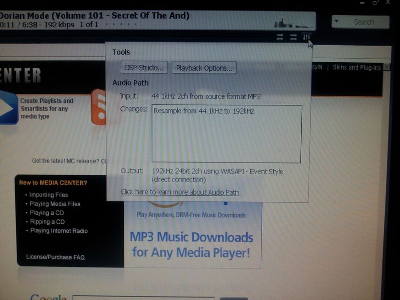

Yes, but I'm not sure what that means. Using JRiver the settings are straight through WASPI and the windows 7 driver is set to play 192. The Audio path drop-down however is reporting 44.1 / 24 bit on the output side. I'm still checking for some other settings to see if 192 can go through the software.
In any event, what I'm hearing is great>

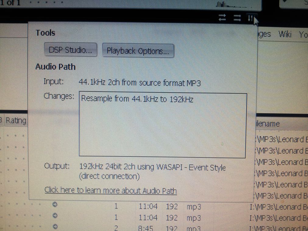

Found it.
Encoding Settings - JRiverWiki
1. Use CBR / ABR Encoding: Target Bitrate: 32, 64, 96, , 128, 160, 192, 256, 320 (Kbps)
2. DSP Studio - Output Format - Right Click in Sample rate box - "Set All to 192...".
Tools - Audio Path - Output now reports 192/24.
On some songs sync is lost causing the need to close the program. Still investigating.

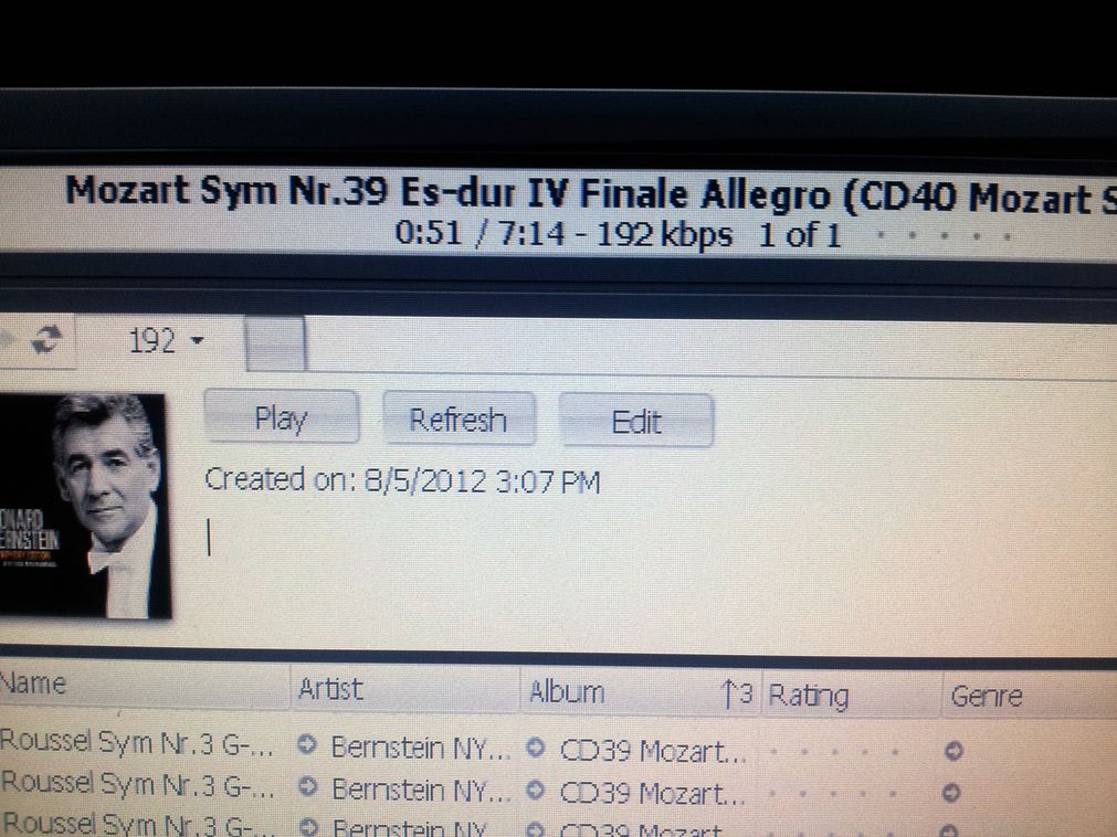

It is still a little confusing. Windows explorer shows the file to be 192k in the datails tab of the properties dialog. First photo shows a 192 source but the Audio Path drop-down indicates there is some sort of re-sampling going on. STRANGE>
BTW: The "96" LED is on while playing 192.
Also: The toslink playback is very sensitive to a good square straight solid fit of the plug. There are static-like blips and the LEDs flash accordingly. The BNC/RG59 connection shows no such problem - super stable.

Yes. eBay toslink module can play 192khz. My CS8416 had pin 20 high,
so it could only play 108 kHz max, as I learned from here:
http://www.diyaudio.com/forums/digital-line-level/211321-dac-cs4398-cs8416-cm102s-2.html
and here:
http://www.cirrus.com/en/pubs/appNote/AN339REV1.pdf
