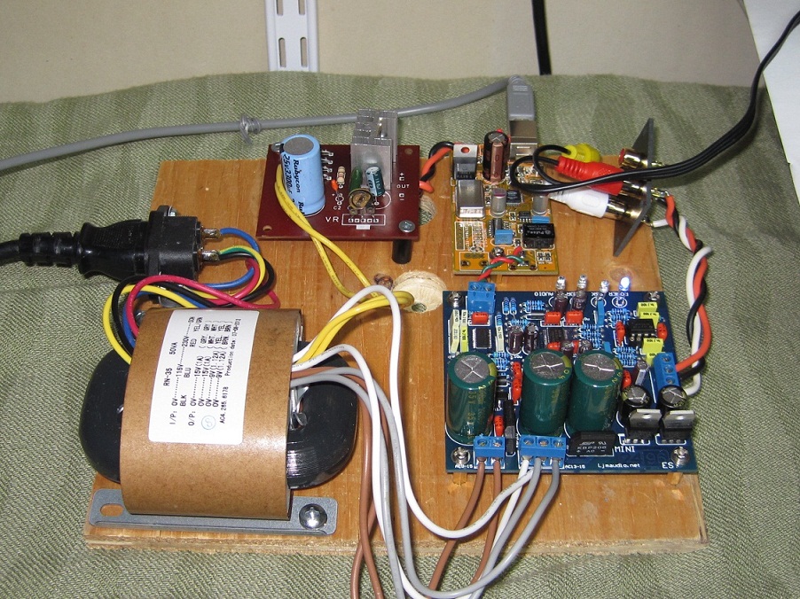

So, I was intrigue with this DAC and decided to give it a try.
I bought one fully populated board and one bare board with SMD chips only.
Since I don't have any source with spdif output, therefore I need to get a USB to SPDIF converter.
Spent a couple of hours last night to assemble a quick and dirty one and got it working the first time (thanks to countless hours spent on this thread)
The USB input is connected to my laptop, running JRiver.
So far the sound is not too bad, considering the cost.
Now I will start the journey by changing parts one by one as defined in this thread and hopefully learn the sound differences on each change made. Hopefully my old and rusty ears still can still pick them up.
The plan for bare board with SMD chips is to build one like sterlingmck and experiment with different output buffers and converters.
Thanks guys for introducing me to another exciting thing to try in life.

If you have a standard CD or DVD player, they usually have a RCA (normally orange) that outputs spdif. A simple stereo pot between the DAK and the amp works well for volume. In the U.S. I've seen new players for as little as $30 and even less at secondhand stores.
