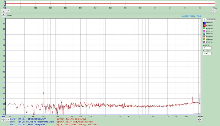

The spikes are some kind off artefact: the denoiser can only generate a continuous noise spectrum, and discrete frequencies must result from instability, external noise sources, etc5. LM317 at 6V with denoiser. Still further improvement. However the spikes are bothersome.
I think that the comparison between a 200 mA device (LT3042) and a 1.5A device (LM317) is completely pointless---they are for totally different applications. Do you really think anybody can HEAR the difference between -140 db and -160 db?
true -90db PSRR, CMRR, THD+N ... is enough for everything.When i see better than that i skip...
This is my assumption as well. However external noise sources are probably not the cause since LT30xx graphs do not have these even though the setup and location was exactly the same in all measurements. Instability is more probable. But all in all the spikes are at a very low level so they may go unnoticed. That is why I would like to see other denoisers measured.
I think I found the culprit. Whoever designed the LM317 power supply (acting as a DAC pre-regulator) was following the latest diy-trend of that time (about 2005) and used ground power planes. These apparently act as antennas that pickup small noise artefacts. I made a quick&dirty new LM317 regulator (without any ground planes) and the spikes were gone. Here is the new graph.
