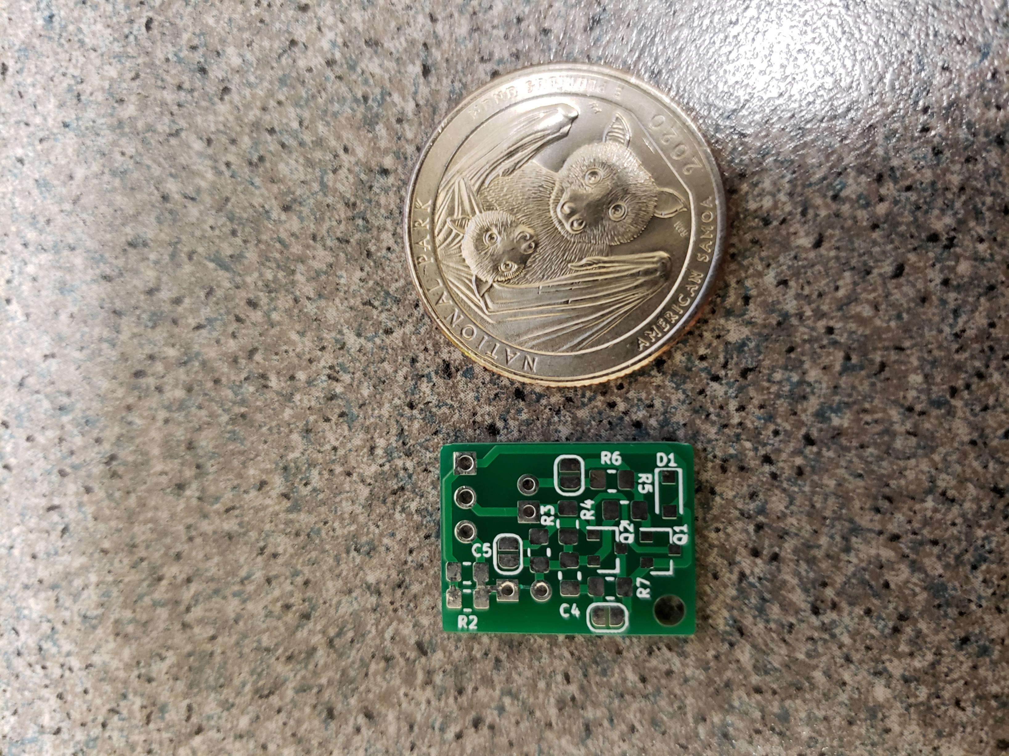

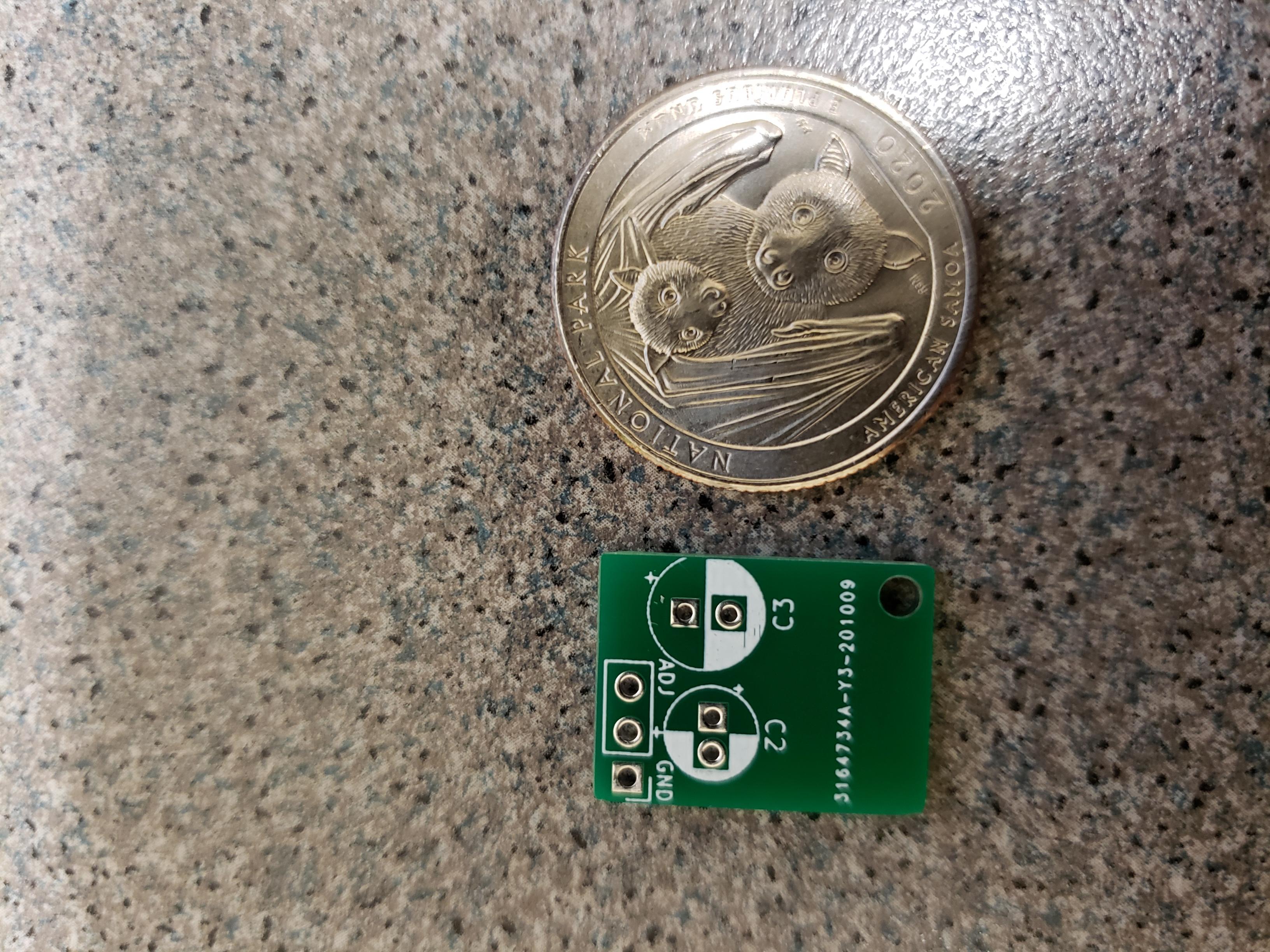

I received the SMD boards designed by Trileru. I'll have to order a few parts, I'll let you know how they work.

What voltage rating does C4 need to be? 16V is very common, but I know my Power supply is outputting 23volts. Does C4 see all that voltage?
The input cap sees all of the output voltage and the collector one sees the OP minus a few volts.
Probably a bit over 16V with a 23V out.
If the bias resistor is increased, it is possible to go under 16V.
Large value ceramic caps have a huge voltage coefficient, much higher than Ecaps. I don't recommend using them there
R7 is also from the comp network and you could try to solder the jumper to bypass it but I'm not sure of the stability. Maybe Elvee can chime in? Is that resistor needed for the Denoiser or Dienoiser?
edit: You could try to connect the gnd/reg_output connections close to either the lm317 output cap either close to the point of load. See what works best if you can measure the results. I'd try with the Dienoiser version at first, because it offers lower noise and a tighter voltage swing at startup.
My plan is to use the denoiser, less parts, more stable and the Hafler is already pretty quiet. From Elvee's initial DeNoiser diagram I was going to order 3.3nF C4's. C3, R2 and C5 are already on my Hafler board. The Hafler board had 22uF for C3, so I'm swapping in 470uF for C3 on the board and using the 22uF for C2 on the DeNoiser.
Where did C3 change from 3.3nF to 22nF for the DeNoiser?
R2 and C5 are for the 78xx reg types, not to be used for the lm3x7 types.
C3 is wired to ground in normal lm3x7 circuits. You need to take it out of the normal circuit and tap the adj pin that you'll then have access to. I don't think you can use it on the initial circuit.
Elvee put 10nF for C4(C2) in his schematic when he made a recap of the circuits, and I see Diego used 22nF for his Dienoiser. I think 10nF-22nF should do without problems.
You could try to take out the ground leg of the ADJ cap on the initial circuit and wire it to the denoiser board on the ADJ connection, but you'll need to bridge C3 on the denoiser add-on board. But I'd just add it to the denoiser board. I think the board could fit a 8mm diameter one and would just barely touch the 22uF one.
