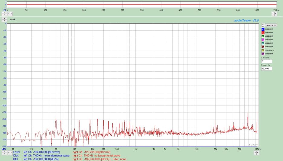

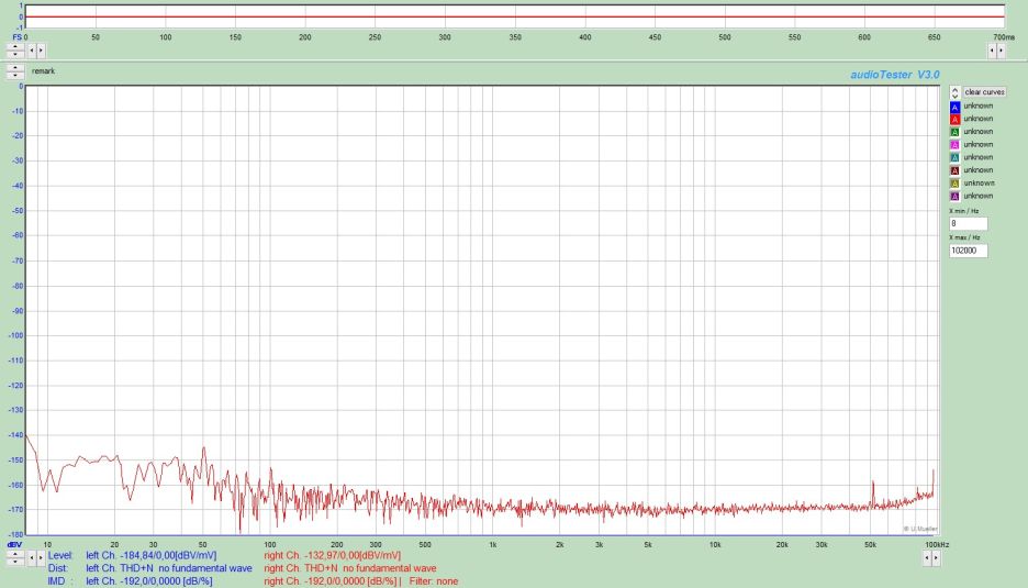

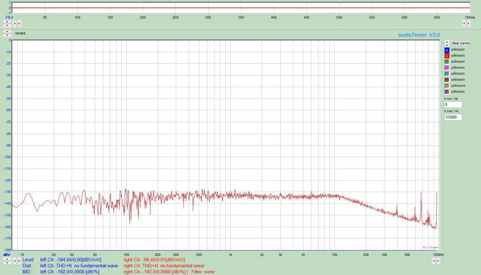

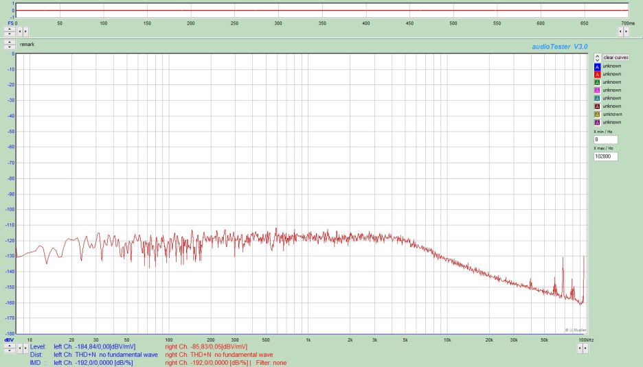

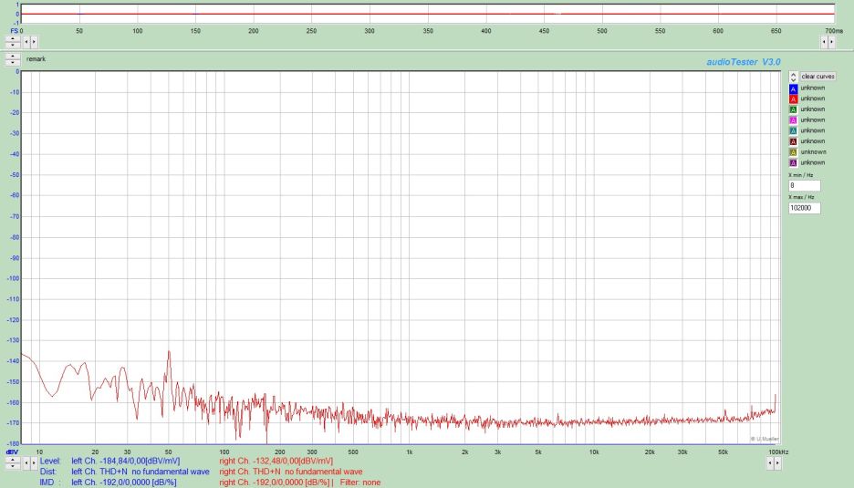

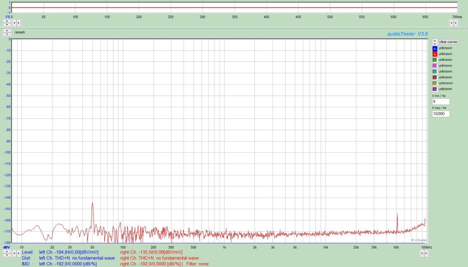

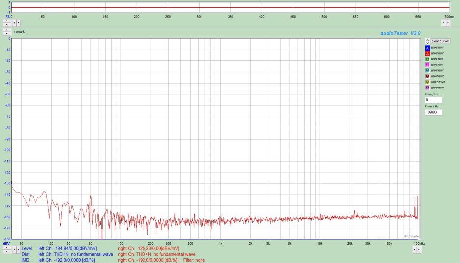

Ok, time for some measurements.
I don't have APs or any other fancy equipment so these are not be taken as definitive results and the absolute numbers are probably meaningless. However the results may indicate ballpark relative merits of the DUTs.
My measurement setup was the following:
- MAudio ProFire 610 external soundcard (sampling at 192 kHz)
- AudioTester 3.0
- 60dB LNA
- Load was 200 Ohm + 100 uF parallel
- Regulator power supply was a small 12V lead acid battery
LNA was screened (diecast aluminum case within a stainless steel kettle). DUT and battery were in open air.
The DUTs were the following:
- Denoiser (single BJT) with LM317 at 6V.
- LT3042 at 5V
- LT3094 at -5V
Attachments (y-scale in graphs includes the 60dB LNA):
1. LNA input shorted
2. LNA shorted with 1k resistor. As the 1k resistor has a noise of 4nV/rtHz and the measured noise is about 10dB higher than baseline, the LNA should have below 2nV/rtHz noise.
3. LM317 at 6V without bypass (Cadj)
4. LM317 at 6V with 100uF bypass. Expected improvement.
5. LM317 at 6V with denoiser. Still further improvement. However the spikes are bothersome.
6. LT3042 at 5V. Excellent as according to the datasheet. Very close to the measurement limit.
7. LT3094 at -5V. Ditto.

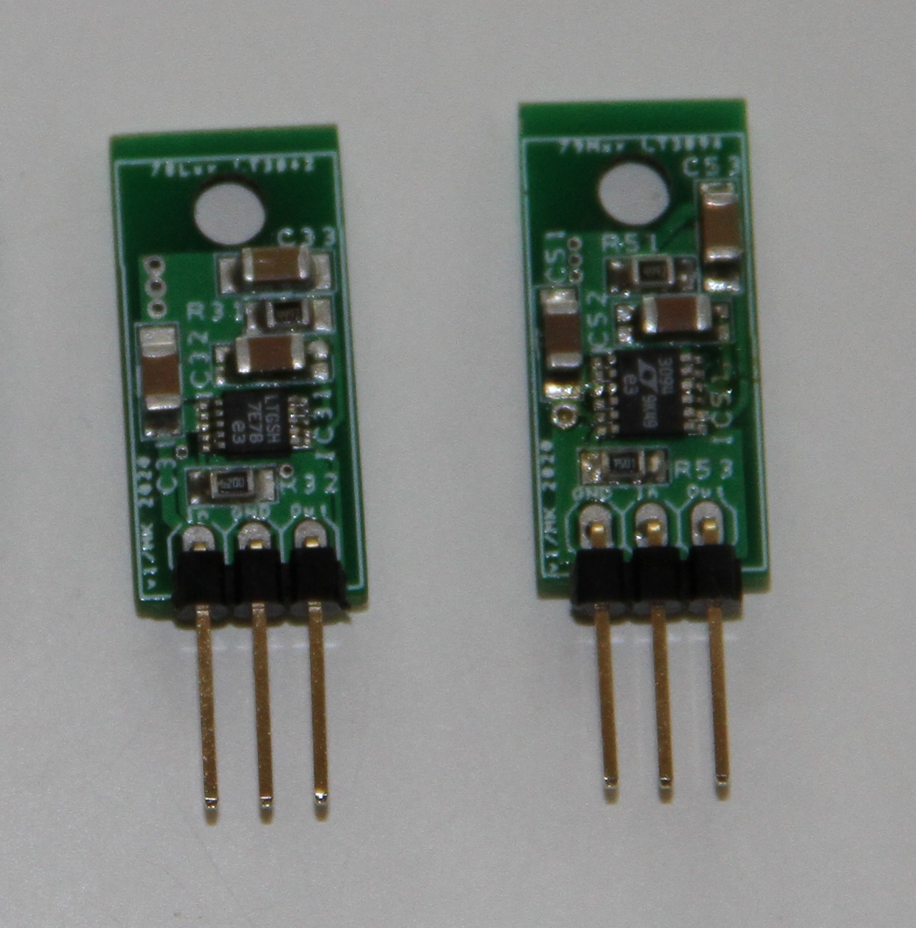

8. Pictures of my LT30xx boards. Layout follows datasheet recommendations.
Regarding the denoiser measurement I tried a couple of add-on denoisers I have built (one with SMD and one with TH). Results were the same. I'm not sure if the spikes are oscillations or just intrinsic to these denoisers. They may quite as well be due to the LM317 power supply I used in testing. However through oscilloscope no oscillations are visible and the overall noise level is clearly lower than with LM317 bypassed. I have also tested the improved dienoiser (with Sziklai). That clearly oscillated (as reported elsewhere on this thread) but even after suppressing the oscillations the results were more or less as with the basic denoiser (spikes included).
These results should make it clear why I have put the denoisers to rest and switched to LT30xx regulators 😀

Since layout for the denoisers matter can you please share with us the two regulators you tested? Pictures of them, and of the layout? It's really important.
There's been people making mistakes with these, in layout and part choice. Also you say they are add-ons, not full lm317 circuits? How did you install them?
That pretty much ends the discussion effectively. Thank you for your effort and your time.

I would not use these graphs to calculate total noise or noise densities as no bandpass filters were applied. I leave that to someone having more sophisticated equipment.
I'm not claiming that my denoiser layouts are perfect but I would much rather see measurements of other denoisers that have been presented in this thread. The smd version I tested was already displayed in D-Noizator: a magic active noise canceller to retrofit & upgrade any 317-based V.Reg.. The TH-version had similar 3-legged construction.
BTW are you now suggesting that denoiser layout is more critical than LT30xx layout 😀
