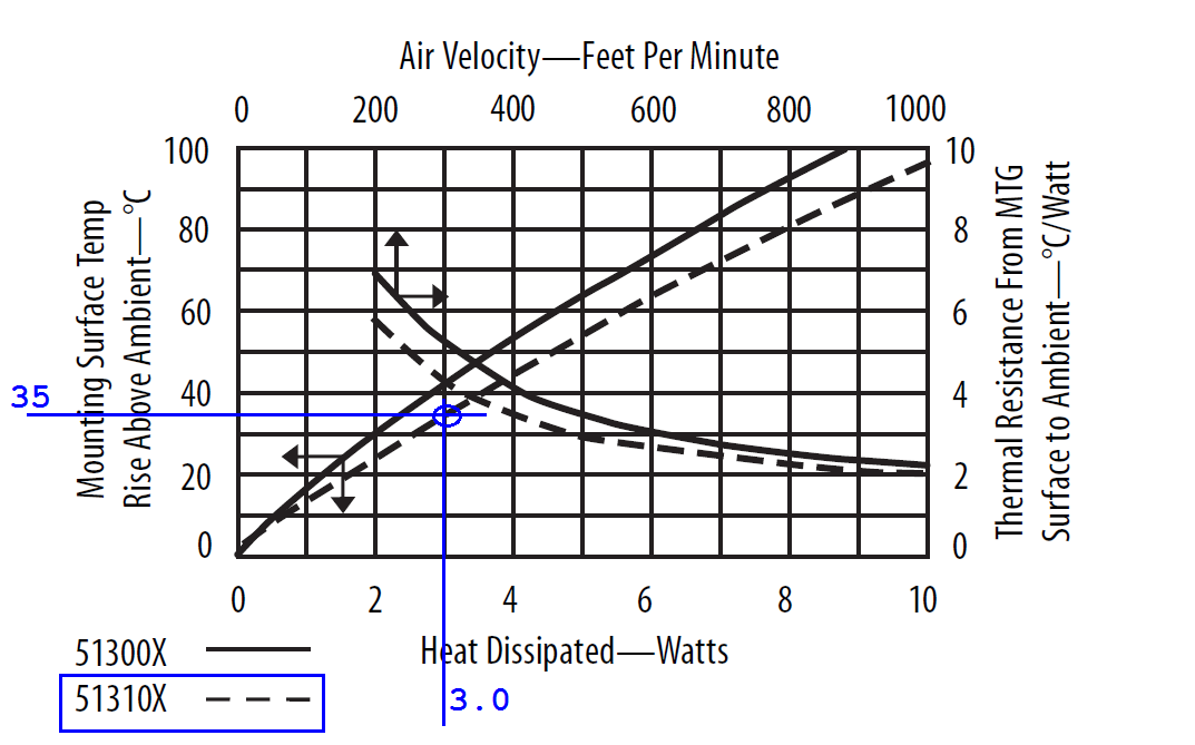

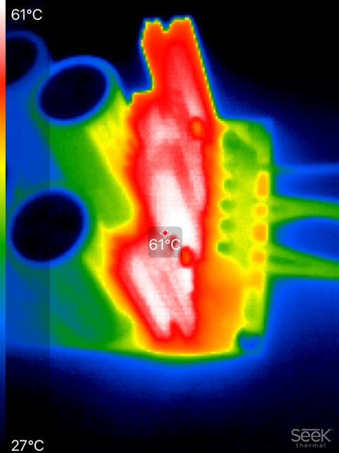

WE could take the same pictures but with these currents I would not worry too much but I would check with a simple IR meter as usual. Your application is a power amplifier and your testing was done with +/- 27V and 4A continuously for 90 minutes. That's 216W.
Why on earth NOT buy a hobbyist grade infrared imager and get hobbyist grade accuracy? It's not terribly expensive because they don't make you pay for a color display; that's on your smartphone which you already own. You'll have a lot of fun taking images and will feel greatly reassured if and when you see that your electrolytic capacitors are not excessively heated.

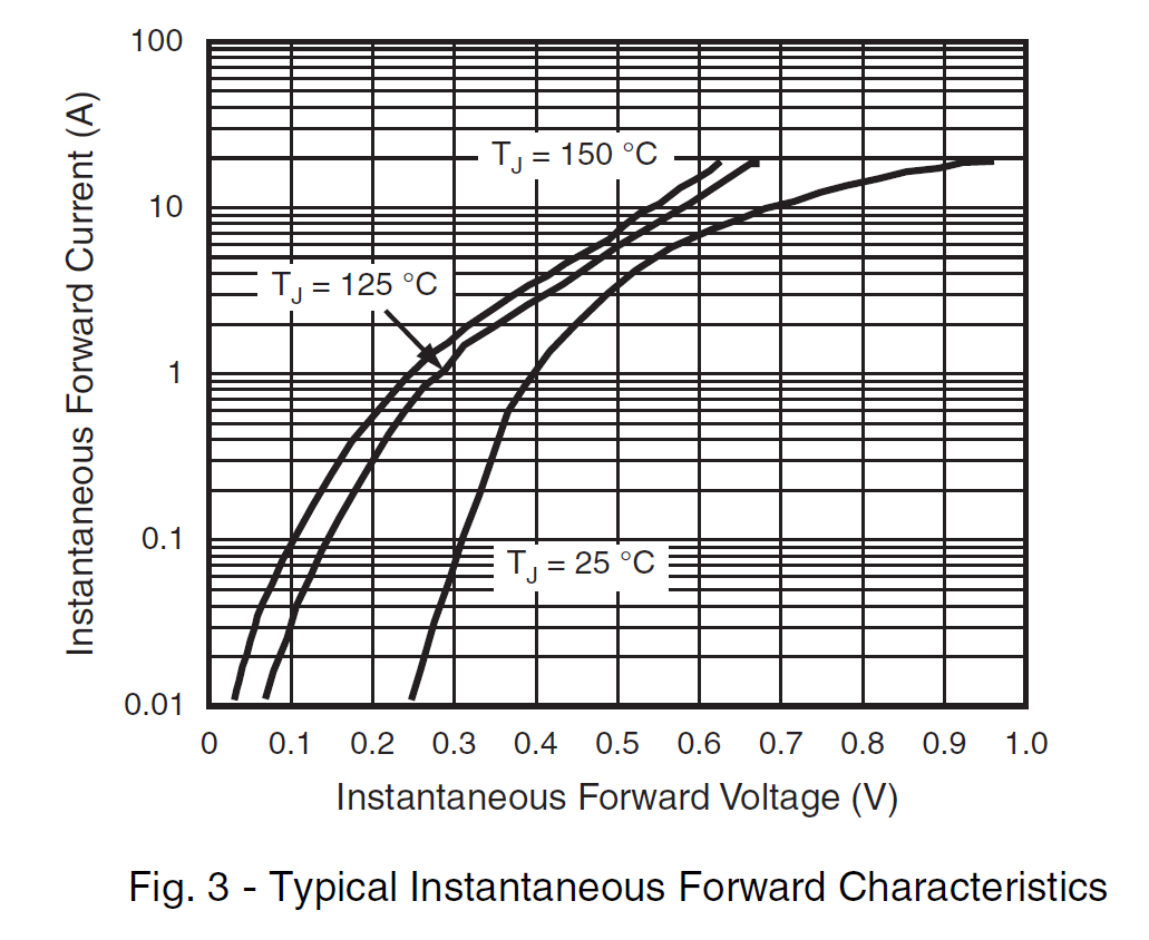

BTW the PSU board I tested, only dissipates about 6 watts itself -- the rest is dissipated in the electronic load used for testing. And boy does that electronic load contain a lot of fans! To calculate the power dissipated in the PSU board: 8 amps total (4 in the positive rail and 4 in the negative rail), times the forward voltage drop of the MBR10100 Schottky rectifiers (about 0.75V RMS thanks to the small conduction angle) equals 6 watts.
This matches the thermal imager results pretty well. The images say the heatsinks are 61C, while the air is 27C. Thus thermal rise is 34 degrees. The heatsink datasheet's curve attached below, shows that a thermal rise of 34 degrees corresponds to a dissipation of 3.0 watts per heatsink: see the blue circle. Since there are two heatsinks, the total dissipation is 6 watts. Check.
