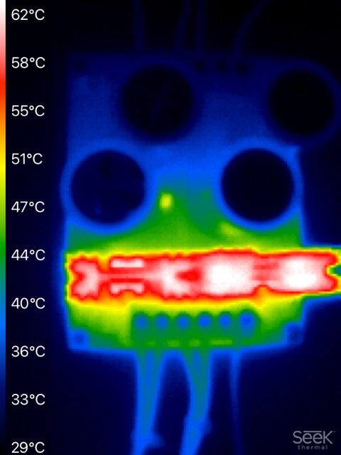

You guys may want to invest in a thermal imaging camera. "FLIR" is one famous brand but there are plenty of others.
I ran a Group Buy in December, for a power supply PCB to run chipamps. The board positioned high-power-dissipation rectifier diodes, near to electrolytic capacitors: (link) . I used a thermal camera (dongle attached to my smartphone) to capture some thermal images; they showed just how hot the diodes, their heatsinks, and the nearby electrolytics, were running. Have a look -- click on the images to see them full size.
796302d1574274095-pcb-available-psu-chipamps-super-gain-clone-compact3886-hottest_spot-jpg
796300d1574274095-pcb-available-psu-chipamps-super-gain-clone-compact3886-top_view-jpg
Just imagine the wonderful images YOU could take, if you had one of these! Enjoy.

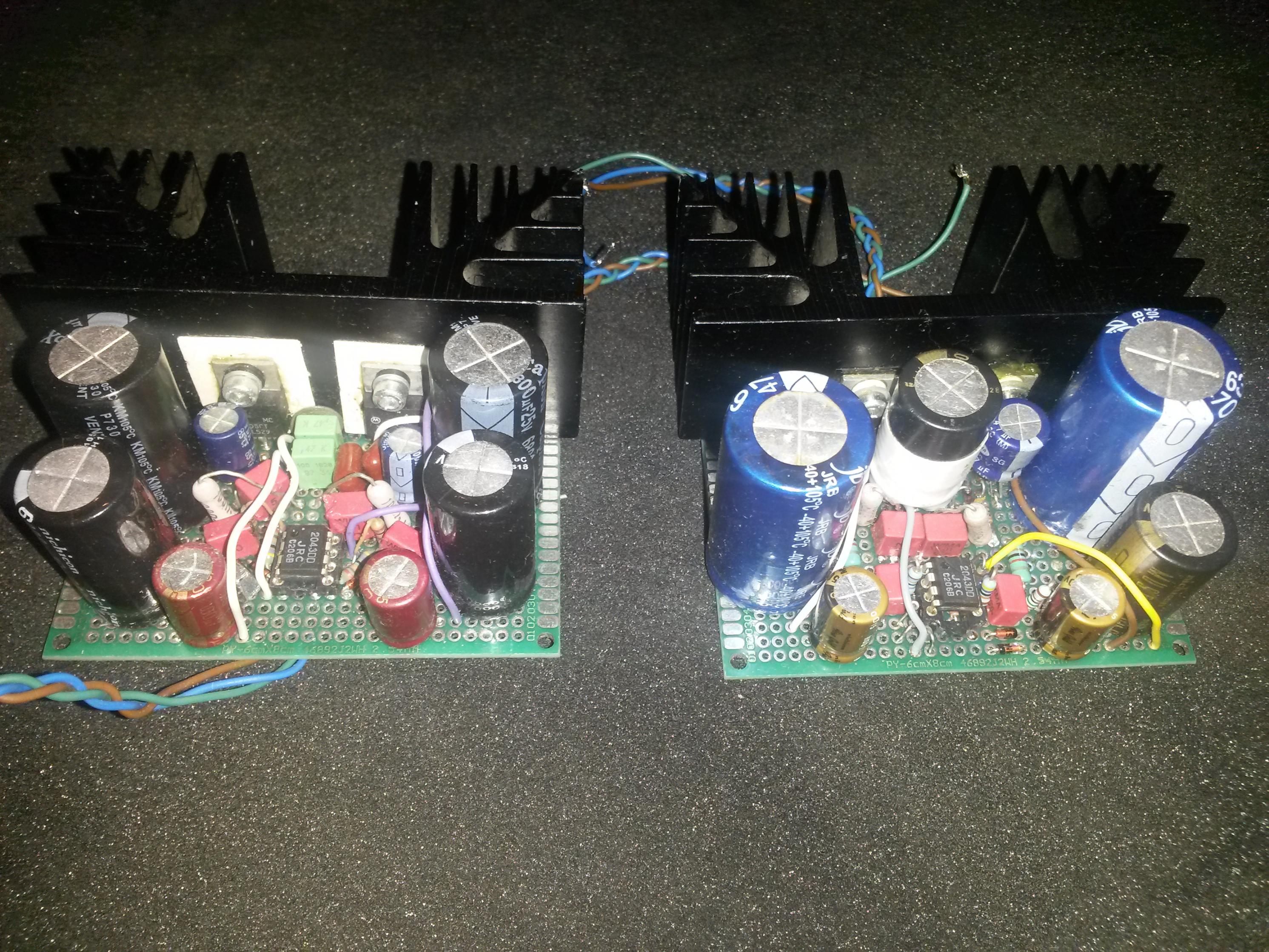

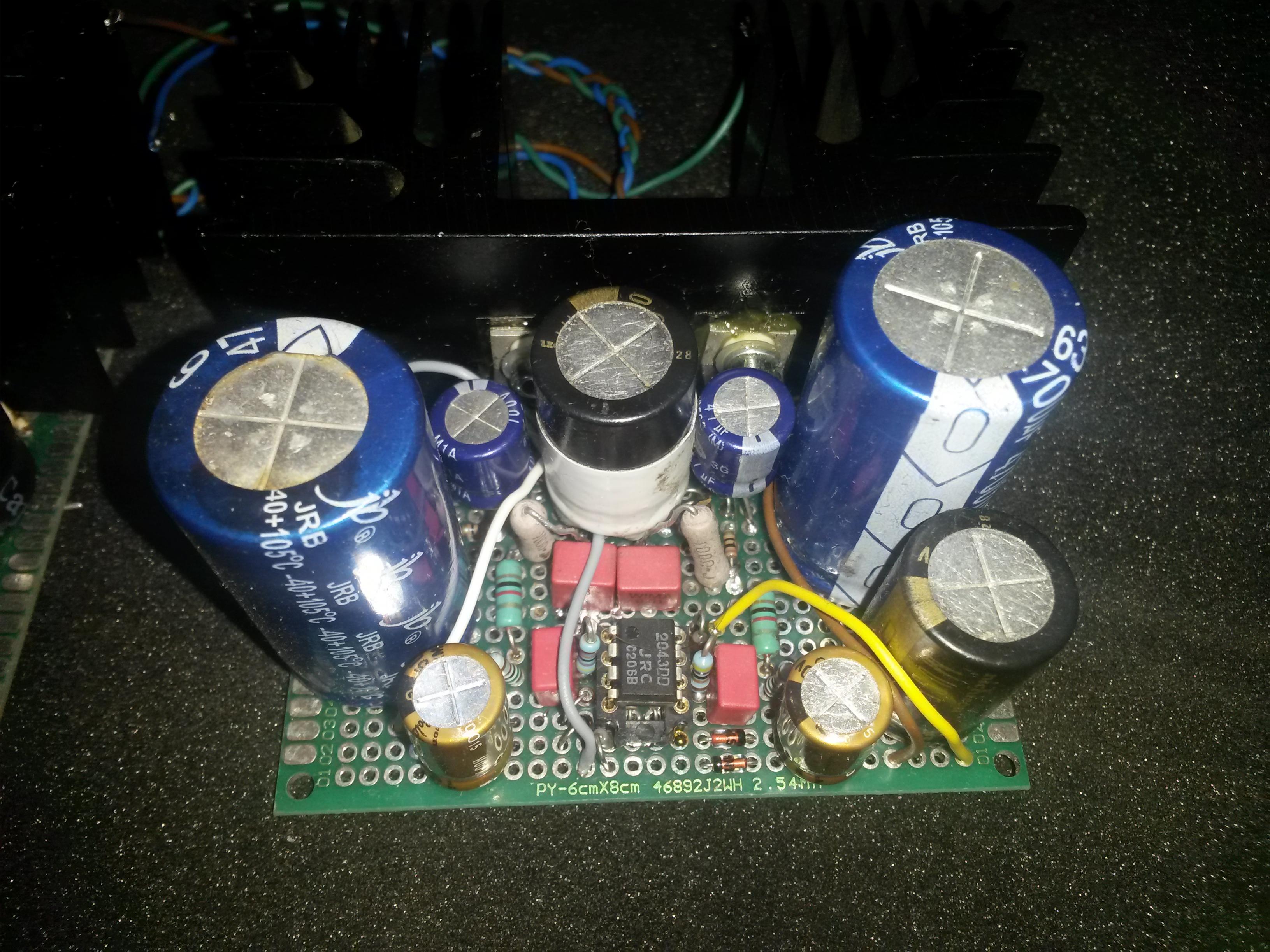

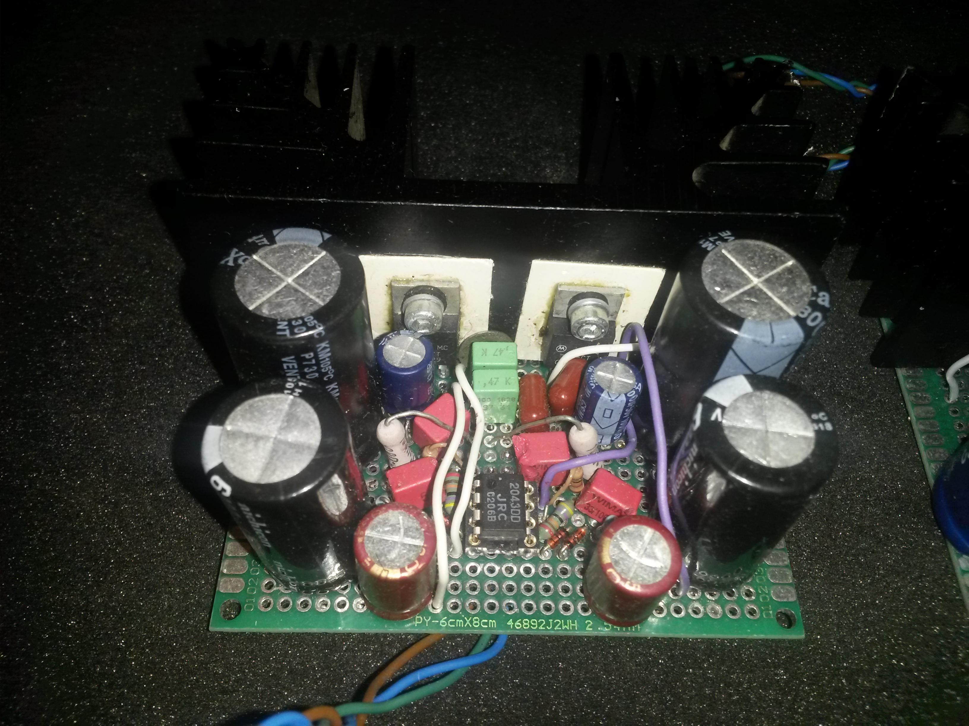

Yet i preffer the Technics denoisers for the simplicity of running them at any usual voltage with an appropriate zener and lm78xx series chip which i can source from any scraped digital board.It may not be as good as Elvee's or other's design due to the use of LM78xx series, but it's good enough, those caps in the first photo are 6800uf ones , one at the input,one at the output and i don't need to pay anyone's commercial fees for using a 30 years old design.

One double op-amp takes less space than 4 transistors as the passive components for your denoiser take the same space as the passive components i use on both regulators, but on one pcb of your size i have both positive and negative supply with the Technics denoiser.The perf boards in the photos post are two complete pos+neg regs(+-10v and +-20v) I'm also using the biggest size of capacitors ...

If you think that things on perfboard are able to compete with a double layer PCB with a modern regulator you are dreaming indeed.
There is no "good enough", we want the best out of our audio and the PSU is most important. Not to keep hanging in the past while way beter stuff is available out there be it DIY or ready made. Regs should work OK in the audio band but for DACs the regs should be able to cope with high frequencies too. Many will use such a PSU for digital gear which demands other things of a PSU. Not everyone uses 30 year old analog gear and is building LM317 stuff for it.

Totally out of reach for most or unreasonably expensive when compared to the device one is building. I have extensive experience with FLIR and they are good professional tools for higher power applications. I wouldn't call the pictures wonderful as one needs a higher range very expensive FLIR for real good pictures otherwise they are low res. WE could take the same pictures but with these currents I would not worry too much but I would check with a simple IR meter as usual. Your application is a power amplifier and your testing was done with +/- 27V and 4A continuously for 90 minutes. That's 216W.
