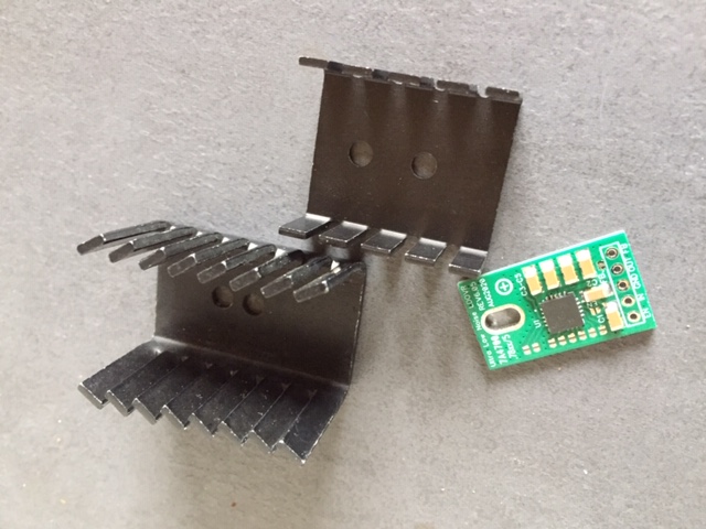

I recently built my DAC with LT3045/LT3094/TPS7A4700 from LDOVR.
They are very compact and hardly worth the hassle to make yourself.
The earlier discussed LM317 as pre-regulator will make thermal management easier if the LDO has little dropout to handle set by LM317.
For TPS7A a little heathsink as sold in RPi kits could fit nice too.
These heatsinks are also OK when the complete PSU boards are used. For applications like yours I use thermal glue and glue the regs to the heatsink and tighten the bolt and nut. After the glue is hardened the bolt and nut can be removed and the regulator can be attached with a plastic standoff to the chassis. It is indeed not worth the hassle designing themself as they are not that expensive and they are delivered with all the needed parts which avoids the minimum order blah blah at many online companies. Still I have to measure them.
Edit: I noticed you use plastic standoffs like you should.

For a quick and dirty (cheap) try out these will do. At the time they were introduced parts were hard to find and I had to design a PCB so I ordered a few of these. I replaced a few parts here and there as you never know what are original parts or not but the LT3042 is there.
Low Noise LT3042 Linear Regulator Power Supply Module For Amanero XMOS DAC Power | eBay
If you remove the PNP transistor specs are better but current is max. 200 mA. With the PNP dropout is 1.5V and max. current is above 1A. Heat is then dissipated by the PNP.
