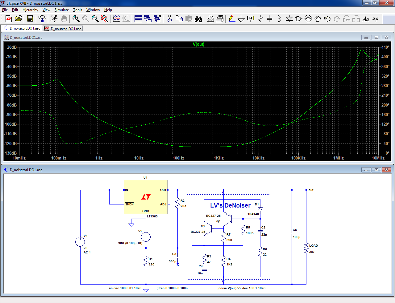

Following inquiries, here is the general method to use the Dienoiser with ground-referenced regulators, like the LT1963, the TI TPSxxx series, etc.
attachment.php
Note that this is the topology, and is purely theoretical: there is no guarantee it will actually work (= be stable) in reality.
In particular, R3 and C4 might need to be adapted: in the sim, with a LT1963 they look quite critical.
With other regulators, not present in the LTspice library, a real world test (and probably tweak) will be required.
Other regulators generally have a higher impedance feedback divider (R1, R2).
It is therefore not necessary to use low value resistors in the amplifier (R4, R5).
The resistors can be scaled according to the equivalent resistance of the FB divider.
This in turns allows lower values for C2 and C3. With lower, more convenient values, the ratio of C3 to C2 can be increased to reduce the slight VLF peaking.
All of this is completely speculative, and needs to be checked and refined in reality.
It is quite possible that some regulators will not work at all with a Die/denoiser!

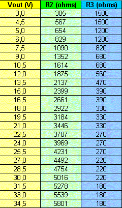

The resistor R7 will need to be optimized according to the output voltage (and the scaling).
Diego has provided a table for R7 (with R4=1K8):

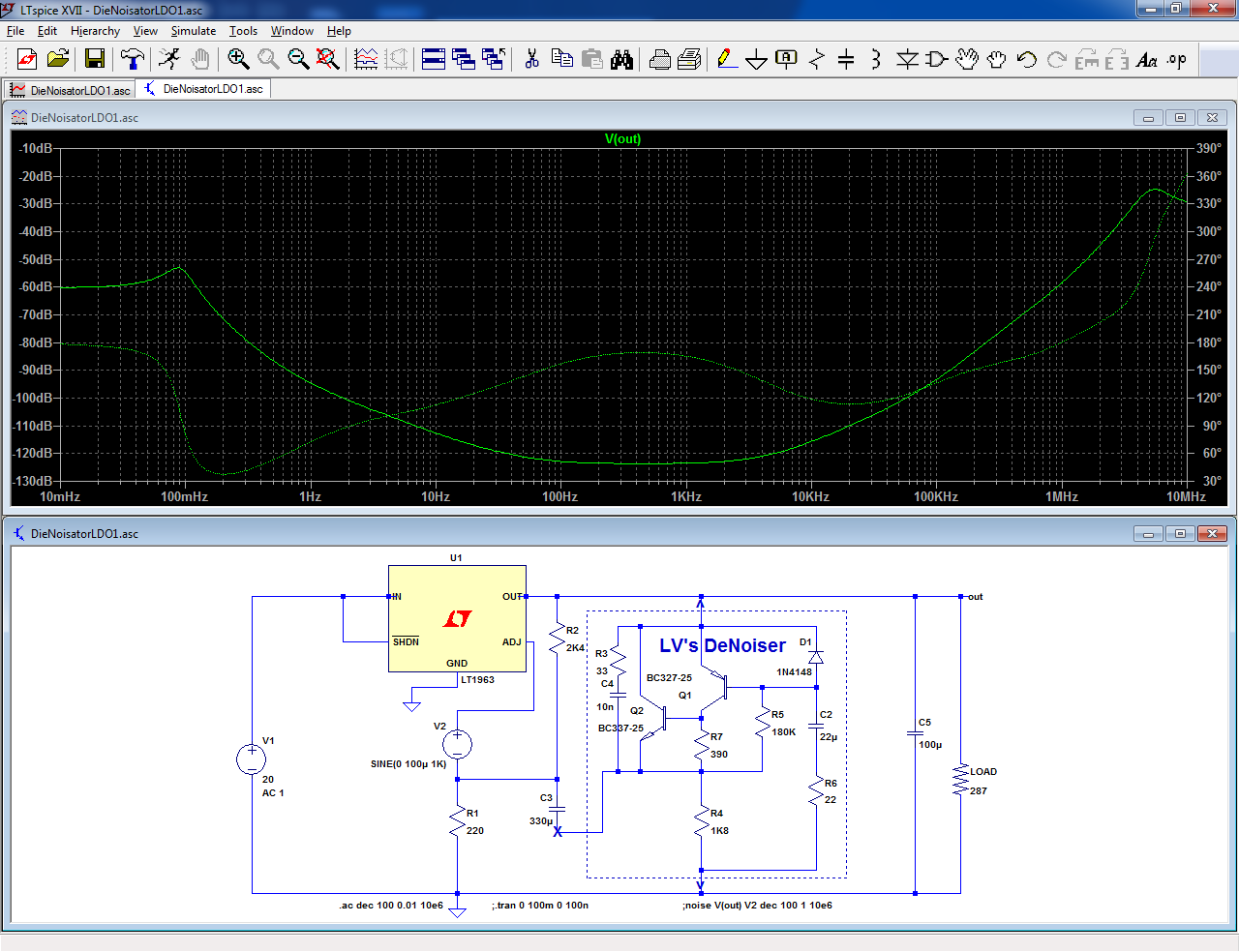

Edit:
I now belatedly realize that I have forgotten to move the compensation cap to the other side.
This is the corrected version:
821832d1583180712-noizator-magic-active-noise-canceller-retrofit-upgrade-317-based-reg-dienoiser5-png
The wrong circuit has been on line for ~9 months now, I just hope that nobody went mad trying to have it working...
Maybe because the first results were poor because of the wrong circuit, and because the maximum input voltage was 20v (when I needed 35v at least), I didn't care so much for the LT1963 and tested only PSRR.
With the corrected circuit, sims for PSRR, noise and impedance now look very very interesting.
But as you say: now it needs an actual field test, to see if it's up to the sims.
Then there's also the practical availability of LT1963 power supplies at reasonable prices to add the Denoiser to.
So I do not expect to see many projects involving LT1963 + Denoiser around.

I built the first circuit and it works like a charm. Without the compensation capacitor it oscillates, with it, it doesn't.
In you latest schematic, much more than just the compensation cap has shifted position. I am somewhat puzzled.
