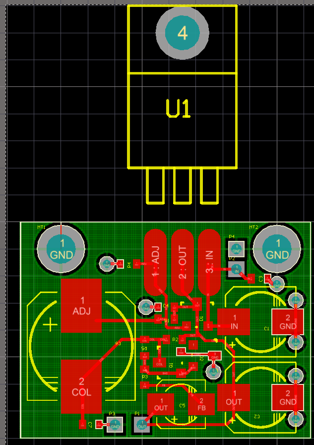

Hi Kimschips
I designed a dual rail board using lm317/337.
Post 518 page 52.
There are some gerber files that can be used to order pcbs from a PCB house like JLCpcb.
There is also a mouser BOM.
I can verify that the board works but we don't yet have noise figures. I'm waiting on Carlmart to do some noise measurements on one of my boards.
