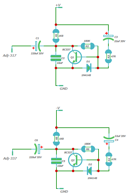

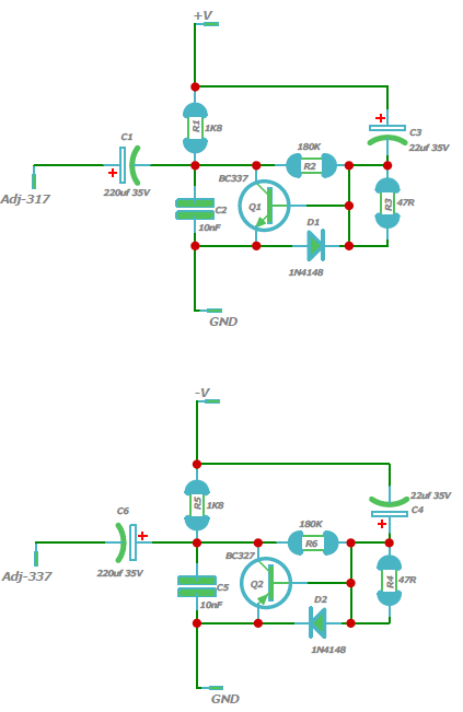

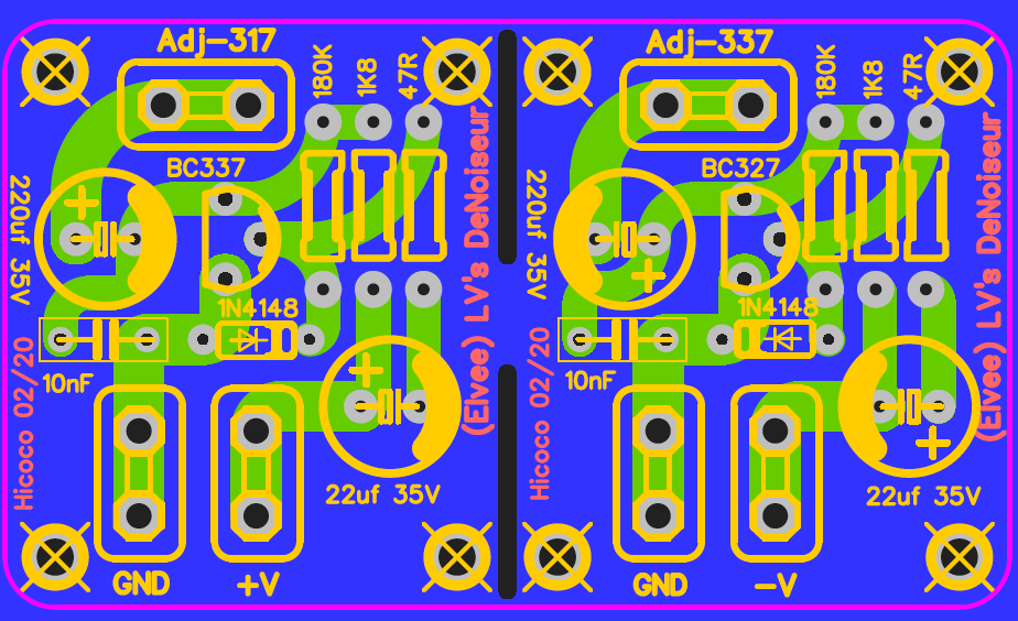

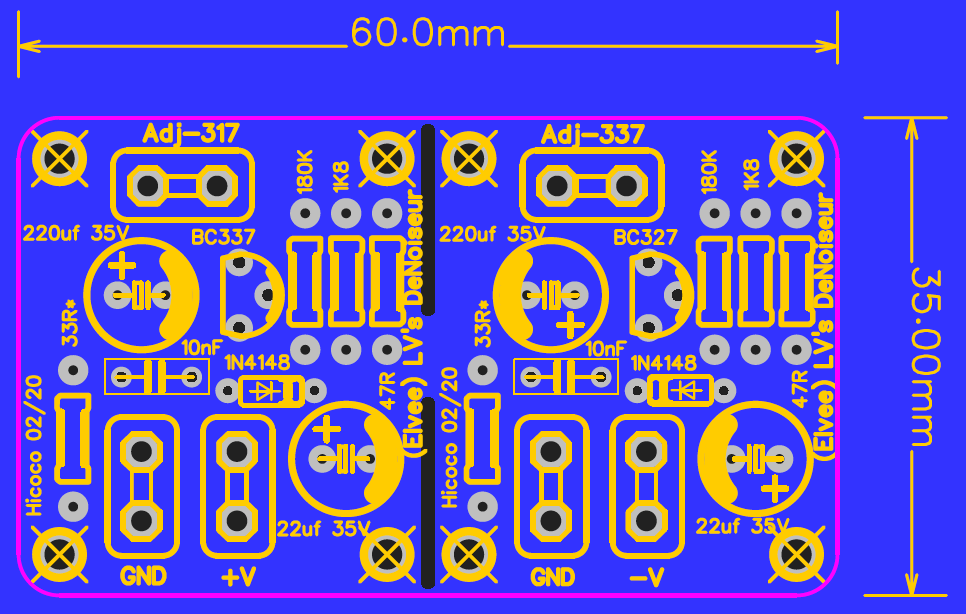

I have made a dual rail pcb that works as intended.
Attached are the gerber files that can be used to order pcbs from a PCB fab
Sadface, I am wondering if you could turn your obviously superb layout skills to making gerber files for a couple of small retro-fit PCBs using Elvee's brilliant and simple de-noiser circuitry. One for the LM317 side, and one for the LM337 side. I was thinking that splitting the two might make it easier to fit various existing voltage regulator boards; maybe it would be too costly; I don't know. All eight components on each board, including the C3 220µF coupling capacitor to the adjust regulator pin. That way, the board could just replace the existing capacitor (with the additional connection to the regulator output), or be wired in parallel with the voltage-setting resistor R2 if there is no cap on the existing board.
Whattya think? I'd do it myself, but I don't know how!
My denoiser boards using your gerber layouts are on order; probably take a few weeks to arrive, though. Perfect for use in my new builds, or to replace very old regulator boards; but I have numerous existing LM317/337 regulator boards that could well benefit from the denoiser.
Exactly: that was the initial intention, a retrofittable module.
Sadface, you would do a great service to the community by designing such an add-on PCB.
You could even sell them at a honest price: I see absolutely no inconvenient to it (and I am not going to ask any percentage on your sales!)
I also need of this add-on......

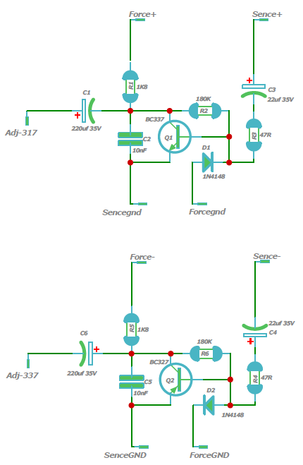

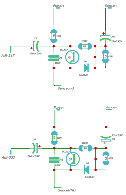

@Hiroco
You have shorted R3 and R4. The base of the transistors should not be connected to R2, R3 and C3 (or R4, R6 and C4 for the 337 version).
You flatter me, I am merely an inexperienced amateur with probably just enough knowledge to be truly dangerous.
I'd be happy to design a denoiser addon board however this raises questions as to how one would want it implemented in terms of connections, mounting and size etc
I see that Hicoco has stepped up in my absence and designed a splitable board for separate rails.
Does anybody want or require a dual rail addon board with a single centre ground rail or are we happy with Hicoco's fine looking offering?
Other questions I could ask would be do we want boards designed for minimum size and therefore less options for component choice or would we prefer boards that are larger but able to accommodate varied footprints?
How would the addon boards be best mounted? Vertically mounted using jumpers to connect to the parent board or horizontally mounted on screws and spacers and then wired to the parent board using screw terminals or faston spade connectors?

Sure, I just need the approval from Elvee to post the PDF and the Gerbers Files
You don't need my approval since it is a completely open project, but I give it anyway
Mounting: screws are possible but overkill, double-sided adhesive tape, electronic putty, silicone, thermal glue etc. are probably easier and sufficient.
Size: a small as practical to be used even in cramped spaces
Splittable is excellent: it leaves all your options open
A common ground could simplify the wiring in some situations, but it comes with restrictions and possible issues like non-optimal ground connection.
Keep separate grounds
A difficult one: some builders don't care about VLF response or peaking, others do.
The boards should be as small as possible, yet tolerate the 220µF (the largest cap), and perhaps 330µ or 470µ (optional)
Many mounting methods should be possible, to accomodate a maximum of real situations

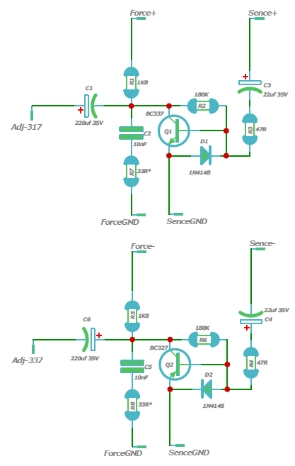

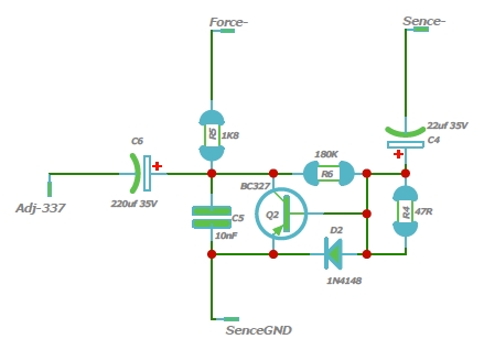

The negative with Kelvins shouldn't be like this?
You joined Force- and Sense-. Shouldn't they be separate?
My mistake, i followed the LV No-Noise schematic for the Kelvin connections...please correct me if this one is not suitable.
I beleive that is interesting to use Kelvin connections if the D-Noiser is distant from the PSU Board.
*Optional 33R has been ad

I added the 33R Optional D-Noizator: a magic active noise canceller to retrofit & upgrade any 317-based V.Reg.
PLEASE NOTE THIS PCB HAVE NOT BEEN TESTED YET...
I added the trace for 2SD2704 at the Bottom in case someone would like to test the board to replace the BC337
