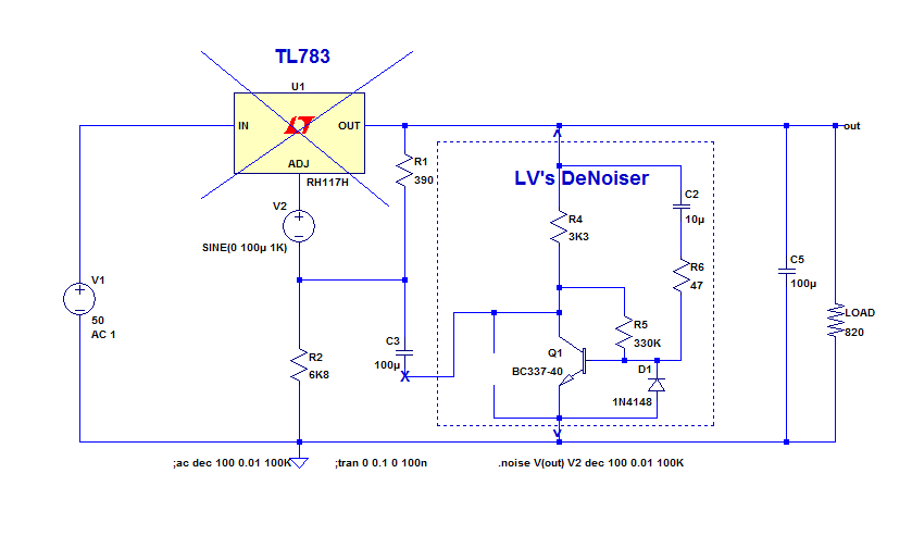

D-Noizator: a magic active noise canceller to retrofit & upgrade any 317-based VReg
I just made the ultimate, most reliable sim possible: a breadboard test.
I have somewhat adapted the values to reduce the dissipation, but that's still a denoiser:
attachment.php
Result?
It works, and it is even more tolerant than a regular 317: it is stable without the 10nF compensation cap, however I don't recommend omitting it: it could be on the verge of oscillation.
It should work equally well with a nonoiser or a Dienoiser, since it looks so easy to live

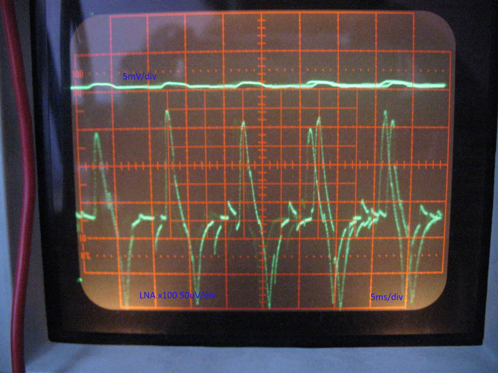

I made a quick test how good could be d-noiser used for heating tubes and it's not bad at all. I didn't measured ripple with HP334A like last time cause that part of workbench is a mess,but i used oscilloscope at 5mV/div and tube was EL84 6,3V/760mA, cables from PSU to tube we're around 50cm long so i soldered 220nF cap on tube socket.
D-noiser gave me around 1mV ripple and i coudn't see any sign of 100Hz from rectifier, only some higher frequency ripple that with very low amplitude.
Classic lm317 with cap on ajd pin gave me 5mV good old 100Hz ripple that contained a lot of higher frequency noise.
In most cases i don't think there is need for such a clean voltage for heater but for MM phono preamps and maybe if somebody is crazy enough to build MC preamp with tubes this could be nice and cheap PSU.
Good to know, but slightly disappointing at the same time: the improvement with the denoiser should be in the region of ~30dB, unless there is a source of really high frequency noise somewhere (in the regulator or the measurement loop)
Actually i completely forgot i bought BNC to banana plugs adapter so i can connect my LNA to oscilloscope that could help quite a bit to see what's going on. I have Tek 466 with 5mV/div so i can't really see without LNA what's going on on screen.

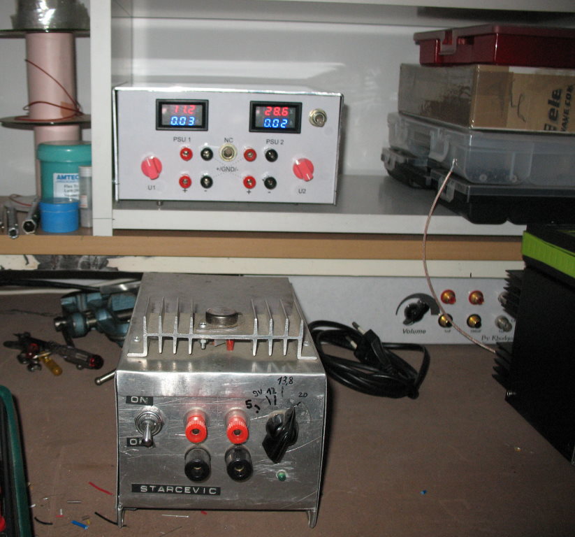

I made a test today with my simple LNA. With x100 LNA i could measure 50uV/div. I made mini lab supply with denoiser so there is chinese AVmeter connected to it all the time. Supply voltage for AVmeter is taken from bulk elcos just after rectifier so denoiser and AVmeter share same supply.
After measurement i made other day(without LNA) i decided i'll use denoiser for my next tube project(one denoiser will supply heater voltage for two ECC88) so in couple of days i'll test denoiser as it is without any modifications and post results,until then this is my test with EL84.
Upper line is simple x1 probe,down is with LNA x100.
P.S.
Ignore my really old supply in plain box on table. Denoiser supply is one that is pretty with chinese AVmeters. 😀
Yeah, typical crap generated by multiplexing, but even with a common supply source, it should be possible to eliminate it almost completely.
Did you properly twist the supply cables (separetely, of course)?
Didn't you make inadvertently a ground loop somewhere?
I don't think i have a ground loop. Denoiser "lab supply" is not grounded/earthed. LNA battery supply ground is connected through BNC input. So only thing i have earthed is oscilloscope.
Cables from psu to el84 we're twisted and since i have two individual denoisers in my psu they have cables twisted separetely.

Hi @Khadgar2007 - nice power supply in your picture. Quick question about the chinese AV meters. I have the same ones (and some similar V only meters) that I was thinking of using. Did you notice or measure if they introduce any additional noise or grunge when fitted? I've seen the odd comments on other threads and forums about extra noise after fitting, so I don't want to add noise back into the Denoiser.... Thanks Adrian
That's big question. I didn't measure noise i get from those AV meters.I have measured denoiser(stand alone without AV meter) that is in my PSU some time ago and i know noise it has on it's own. So i could measure noise now and compare it.
But from this project i didn't expected to get best performances but just some better then basic lm317 bench supply.

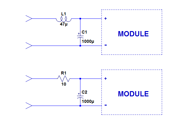

I have the same, and as any similar gear, they are quite noisy which is normal for something having a multiplexed display, and perfectly manageable if you follow good wiring practices.
The supply wires must be twisted and go directly to the source: the module has to be completely independent from the rest.
A good supply bypass is essential: either you connect directly to the reservoir cap, or you use a substantial bypass cap directly on the module: 1000µF for example.
You can also a RC or LC filter in the supply (near the module):
attachment.php
You also need to avoid ground loops: you have to think about the way of connecting the input ground without creating one.
Finally, the module should not be too close to the denoiser to avoid electrostatic coupling.
The denoiser is mostly low impedance, but at a close distance the 0/5V transitions will couple into the output of the correction amplifier
