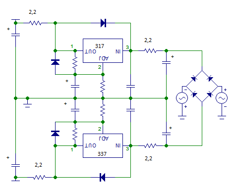

I'll remove the ones with the LM337.
You say : "The 337 does not tolerate resistance at all." , but after removing the ceramic cap , everything seems ok . could the 33 be the cause of the instability with the ceramic cap ?
Yes, real oscillations occur at 80 ohm, but any value reduces the stability margin, even if it does not cause direct oscillations so it is preferable to eliminate it completely for the 337
@Elvee if you think this is a bit offtopic i'll stop here with this modified denoiser versions. I just wanted to show that we are all grateful that you got this idea so we we're playing around it to see if we can improve it a bit as stand alone PSU.
No problem, other members will certainly find additional application examples useful and inspiring

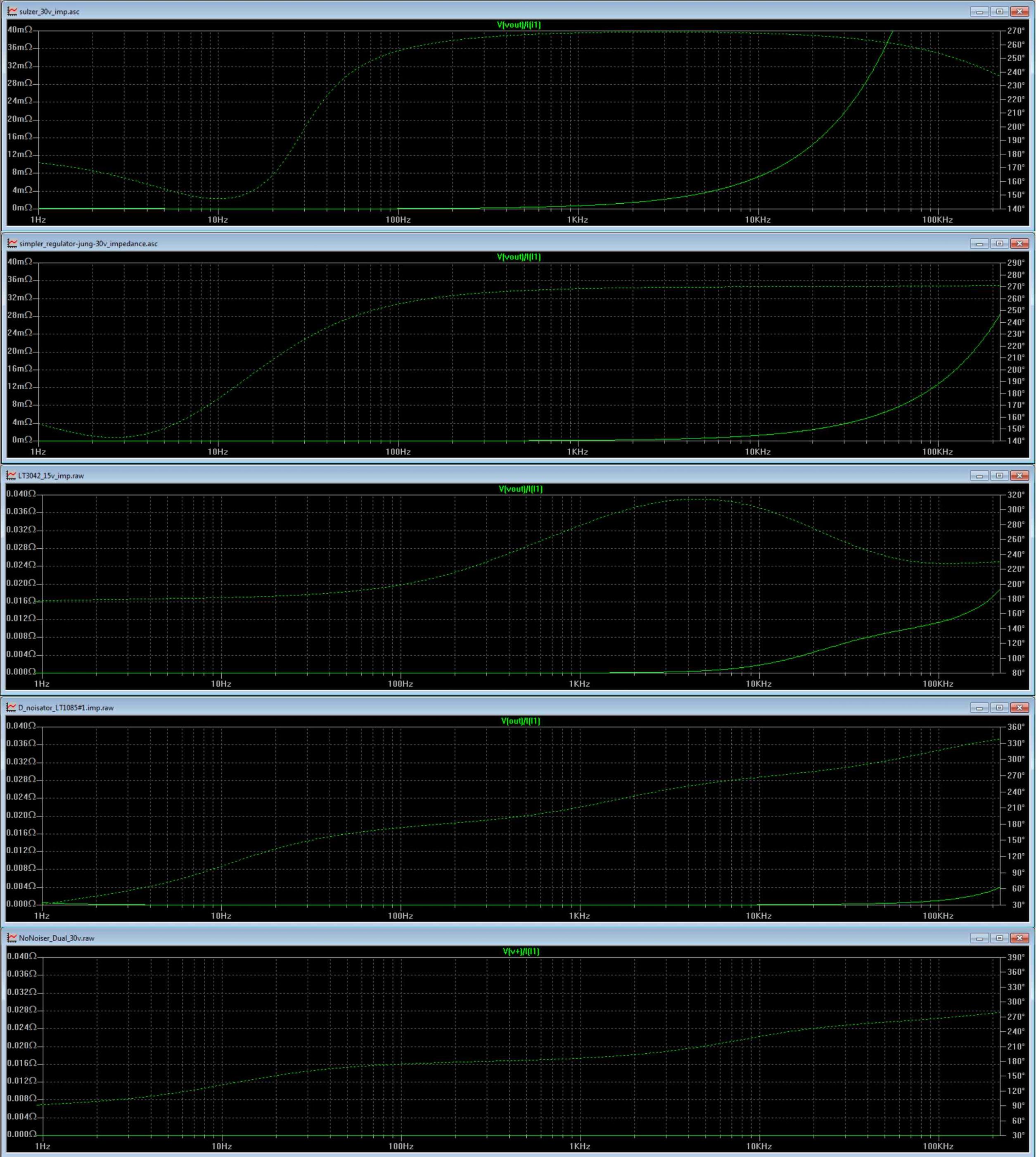

Simulated impedance competition.
I took the most remarkable impedance curve regulators, and put them one over the other too see how they compare.
Also added an LT3042 that I have been working with and I think also belongs on the "superregulator club".
Limits were set for bandwidth, 1Hz to 220KHz, and 40 miliohms was the vertical limit, which seems reasonable.
The Nonoiser was the best performer.
We can go further in the lower scale, but I wonder if that is necessary at such low results in practical terms.
Same thing goes for the PSRR comparison I made on the other thread.
To my surprise, at least for some of the simulations, the CRC filter turned in better results than using a pre-regulator. Can someone explain that to me?
You could also add the 12 discrete reg.
Not the highest performer, but relatively simple and cheap
If you use a log scale, this will make the comparison easier
There is no theoretical limit to what a passive LPF can achieve at high frequencies.
Regulators have various mechanisms limiting their performance, but in general they are flatter than passive filters.
OK, I will add it.
But the curves will have a different shape. I was trying to use the same parameters WJ had used on his measurements.
Maybe it's my implementation. What I did was add a regulator before an LT3042, which had an excellent PSRR response. The results with the pre-reg were awfully poor.
In any case I was surprised that at the simulation results of the LT3042 in impedance and PSRR. Pity it's SMD.
As I have a few "violet" LT3042 regs I had bought in eBay, I was thinking of adding the CRC before the pcb and see what happens. That is for the moment when I make the actual comparisons with the real boards.

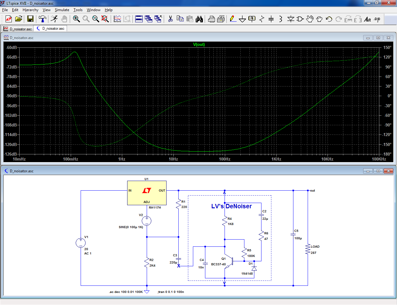

The denoiser in its latest version:
attachment.php

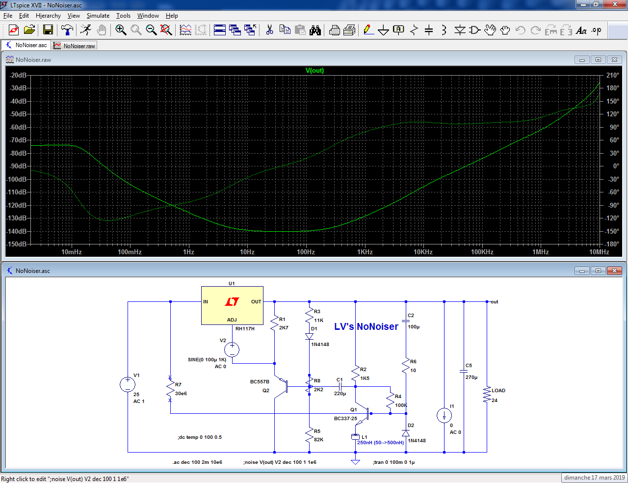

The nonoiser:
743626d1552823795-noizator-magic-active-noise-canceller-retrofit-upgrade-317-based-reg-nonoiser4-png
The sims are a bit optimistic compared to the reality as always, but you can expect >100dB rejection at 100Hz for the denoiser and 125dB for the nonoiser without the ripple compensating resistor.
With the resistor (that needs to be individually adjusted) you can gain an additional ~10dB at 100Hz

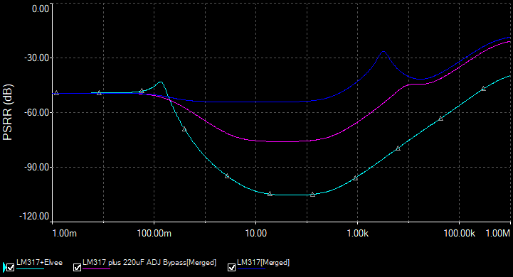

First of all, I know there's way, which I can't remember, where you load data so LTSpice can draw several curves so you compare them immediately.
One big improvement I noticed on all PSRR simulations was adding a CRC filter before the regulator, visible on the low frequency region and the lower range it could reach for the flat line. The question is whether it's worth, money wise and audio quality wise, to use that CRC. Comments are welcome.
It depends on what you want to do: if you need to see the effect of a component or parameter change, the .step command is the simplest way.
If you want to compare completely different circuits, there is certainly a way to use the .raw files of the different sims, but i never used or explored that possibility.
The most straightforward method is probably to put all the circuits you want to compare on single schematic, and plot the various nodes in the same graphic.

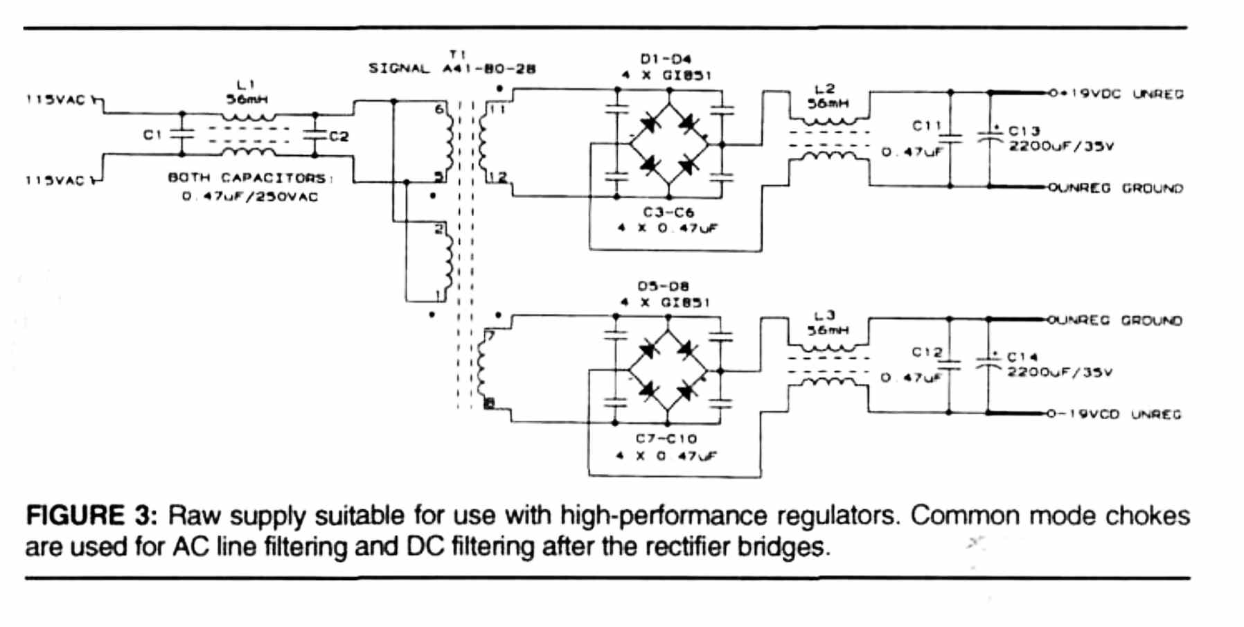

You say the CMC choke it won't work between capacitors or that it won't work at all?
This the supply suggested and used by Gary Galo for his raw supplies, following tests done by Rick Miller for The Audio Amateur.
They were later used as raw supplies for Gary Galo's superregulators.
As you can see, the 56mH CMC chokes were used before the transformer and after the diode bridge. Not between capacitors.
Those Panasonic types are not available anymore, but there other brands.
I didn't find any models for either the inductors you suggested or those CMC.
