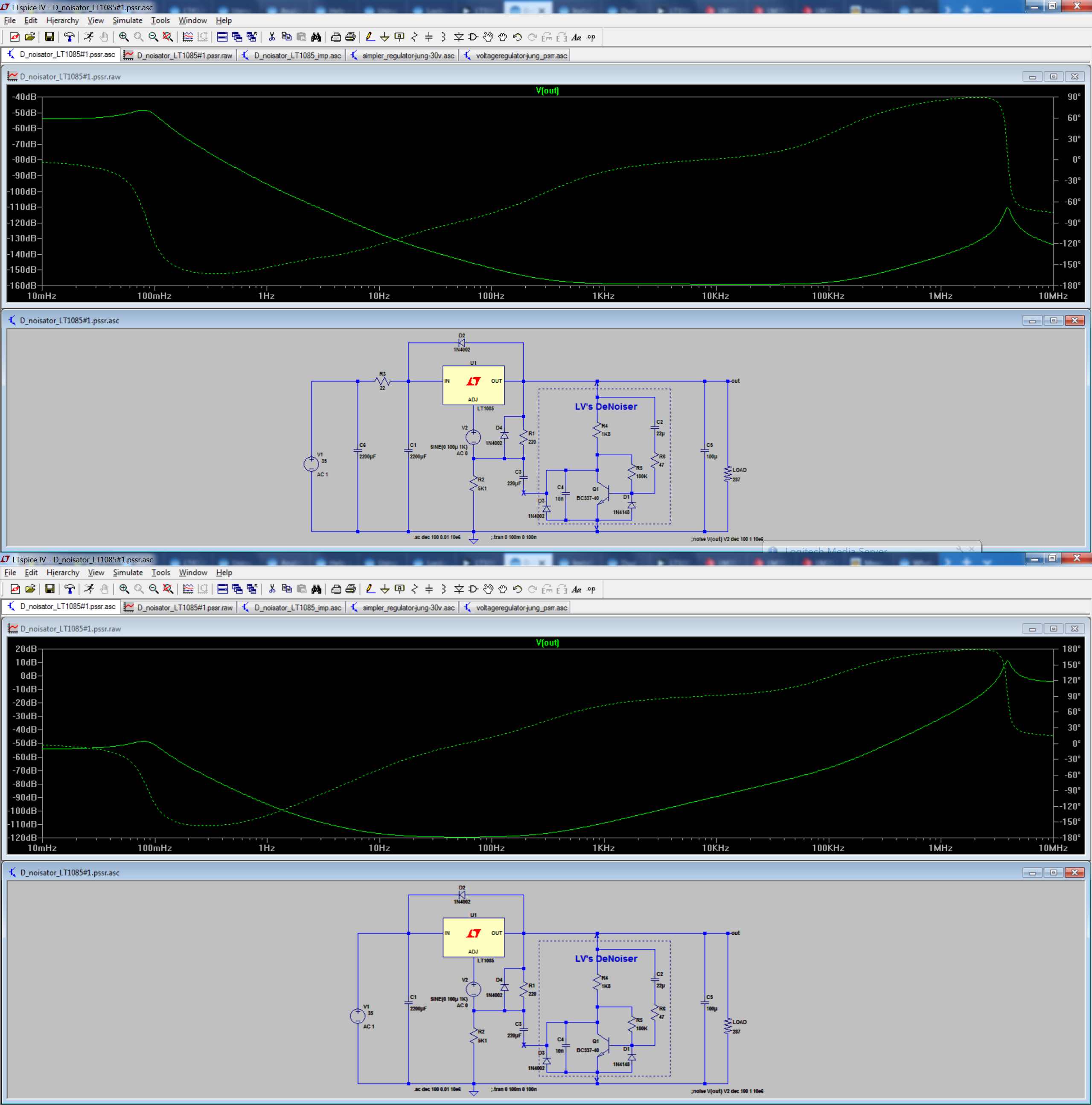

Of course you were right. Here's the DeNoiser later version's PSRR.
One with 100uF input filter cap, and the other with a CRC, increased capacitance filter.

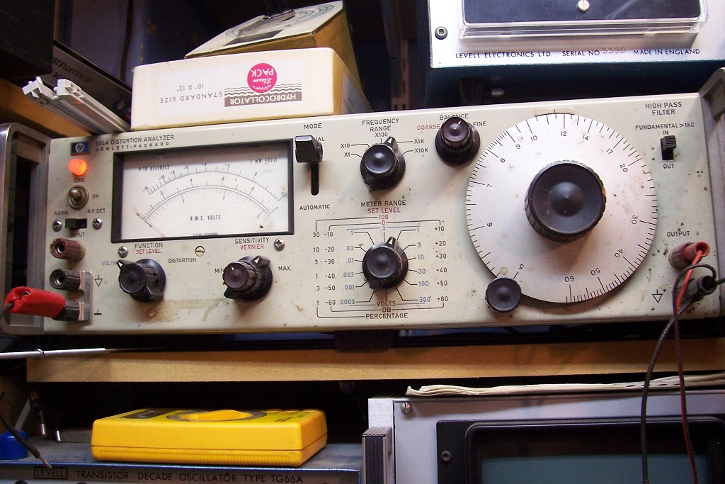

I dont have some sensitive voltmeter but i have HP334A that can measure up to 30uV full scale so i will see how much noise i get from my "version" of DN.
EDIT, no i won't connect to HP334A cause it doesn't have AC/DC switch... 😡
I guess i'll just have to trust that DN works as intended. I can ofc try check on oscilloscope(5mV/div) how it behaves when i connect different loads but that's it.

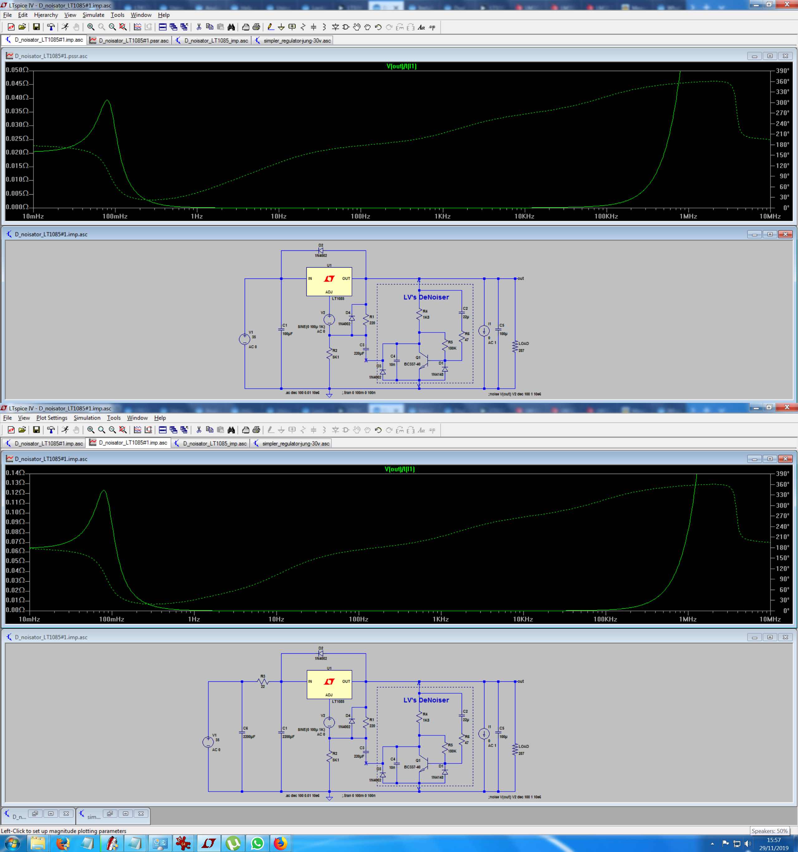

Denoiser's latest version impedance comparison.
The difference is only on the input filter: 100uF on one and CRC on the other.
Contrary to my expectations, the CRC version's impedance has a slight peak on the right, but the curve that really matters is less than 65 microohms from 3Hz to 10KHz. Which I think is great.
The CRC version had better PSRR response than the single cap filter version.
The first DeNoiser version's impedance was about the same.

Don't worry about the 334: like all similar instruments, it is AC-coupled by construction. I know, I also have one:I dont have some sensitive voltmeter but i have HP334A that can measure up to 30uV full scale so i will see how much noise i get from my "version" of DN.
That said, it won't tell you a lot: it would already reach its limits with a 317 without additional caps, and with caps or the denoiser, it will be practically useless.
You need a LNA in front of it to be able to see something.
It can be as simple as a good opamp wired as X10 amplifier. If you have nothing better, even a NE5534 will already let you see something, but a superopamp like the LM4562 or AD797 would be preferable
Are you sure the peak is on the right? I see a peak on the left for both, which is normal because the input and output poles are located a bit close.Contrary to my expectations, the CRC version's impedance has a slight peak on the right, but the curve that really matters is less than 65 microohms from 3Hz to 10KHz. Which I think is great.
It is a tradeoff, magnified by the linear scale and it does no actual harm, but if it is a problem for you, you can split them further apart by increasing C3 (this will also increase the startup time), or decreasing C2 (it will reduce the VLF response).
You are of course free to opt for another tradeoff

Of course it's on the left.
No problem for me. The frequency the peak is at it is inaudible.

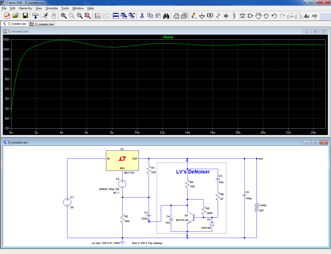

Though increasing the startup time seems interesting, anyway. What would be a good value for C3?

This has already been evoked earlier in the thread, but basically it is a matter of taste: personally, I already find the ~10s stabilization time of the current version borderline annoying, but other people differ.Though increasing the startup time seems interesting, anyway. What would be a good value for C3?
This is the startup of the present tradeoff, but seeing it in a sim and experiencing it in reality are two different things:
A lot also depends on what the supply is connected to: if your preamp takes a further 20s to settle after the supply has completely stabilized, it will feel like a long time.
Some circuits may already work quite well before the complete stabilization, making the startup time more or less irrelevant

Now I realize that what I was thinking would be better to achieve was exactly the opposite that I said.
What I would like to is to shorten the startup time, not to lengthen it.
OTOS I usually do not turn off low current equipment, I leave it on all the time. So in the end the only things that matter most is how audio quality is affected, and settling time is not important really.

Wire a 4562 in X100 mode, that will give you 3µV fsd, and use a 51 ohm resistor at the output, to cope with the capacitive load (put everything in a metal box with a separate supply)Btw about simple LNA,i couldn't find what's input impedance of 334A but i guess since it has 300uV range(i made mistake saying it's 30uV) i guess single OPamp wired as 10x amplifier without buffer is good enough?

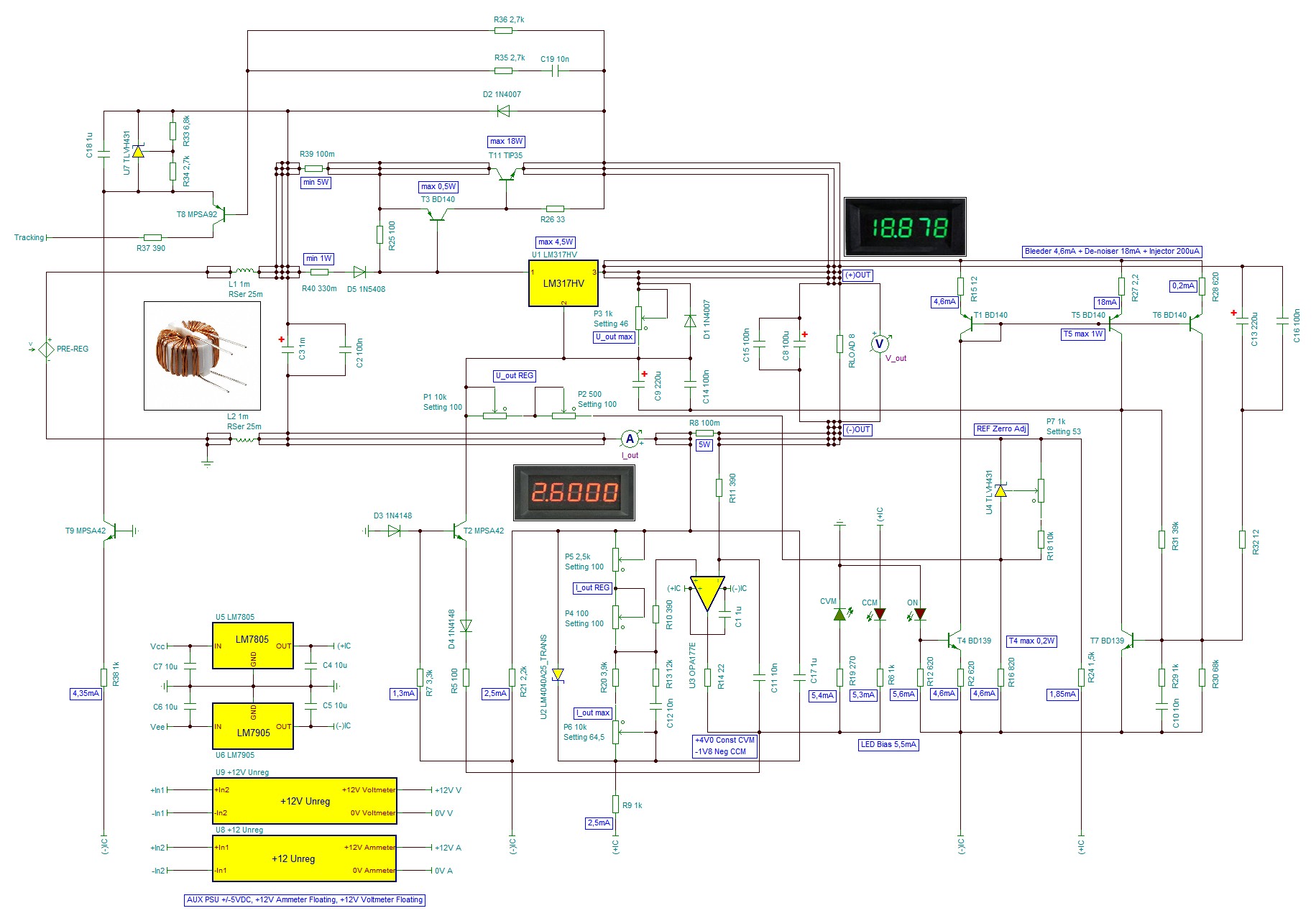

This are two schematics that member on our local forum simulated in TinaTI. Simpler one got current mirror and extra BJT for fast startup. Other one got same but has been modified to be lab supply.
Lab supply circuit has been made and tested on workbench and shows no sign of oscillations.
This is the forum LAB PSU 0-30VDC, 0-500mA/0-5A but it's kinda closed, you can see some topics and some you can't without signing up.
Btw i'm just messenger so if something goes wrong if you plan ti build it don't kill me. 😛

The second one is really a very complicated power supply.
I'd keep with the Jung superregulator.
Second one is meant to be fully functional workbench power supply.
First one is designed to it can work really good even on low output voltages where simple resistor biasing of denoiser BJT won't work very well,but needs some sort of negative aux voltage.
