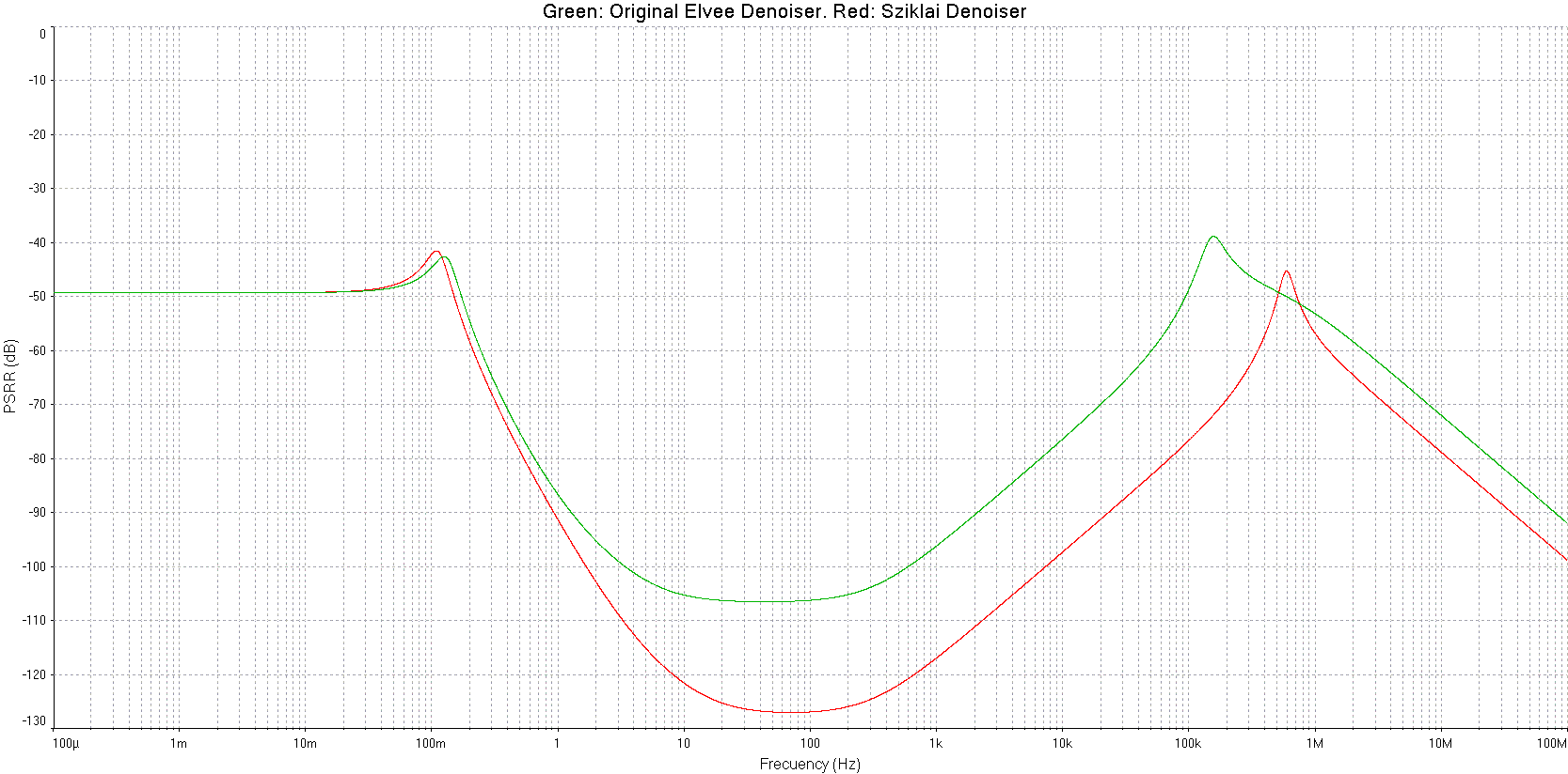

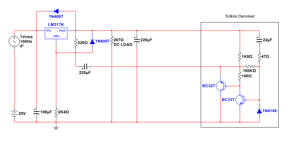

Hi Elvee !!!
Thank you very much for your great contribution!!!.

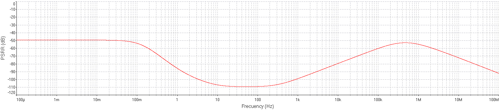

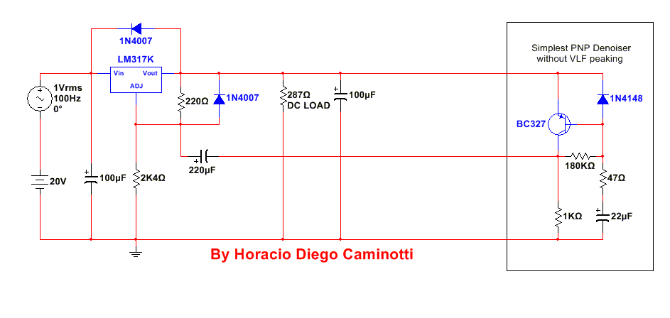

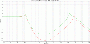

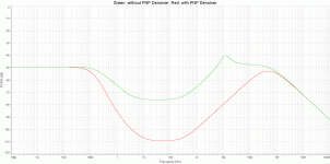

I add a modified option of your denoiser, which seems not to produce the peak at a very low frequency 😉. I have not tested it in my workbench (only in simulations).
Best regards

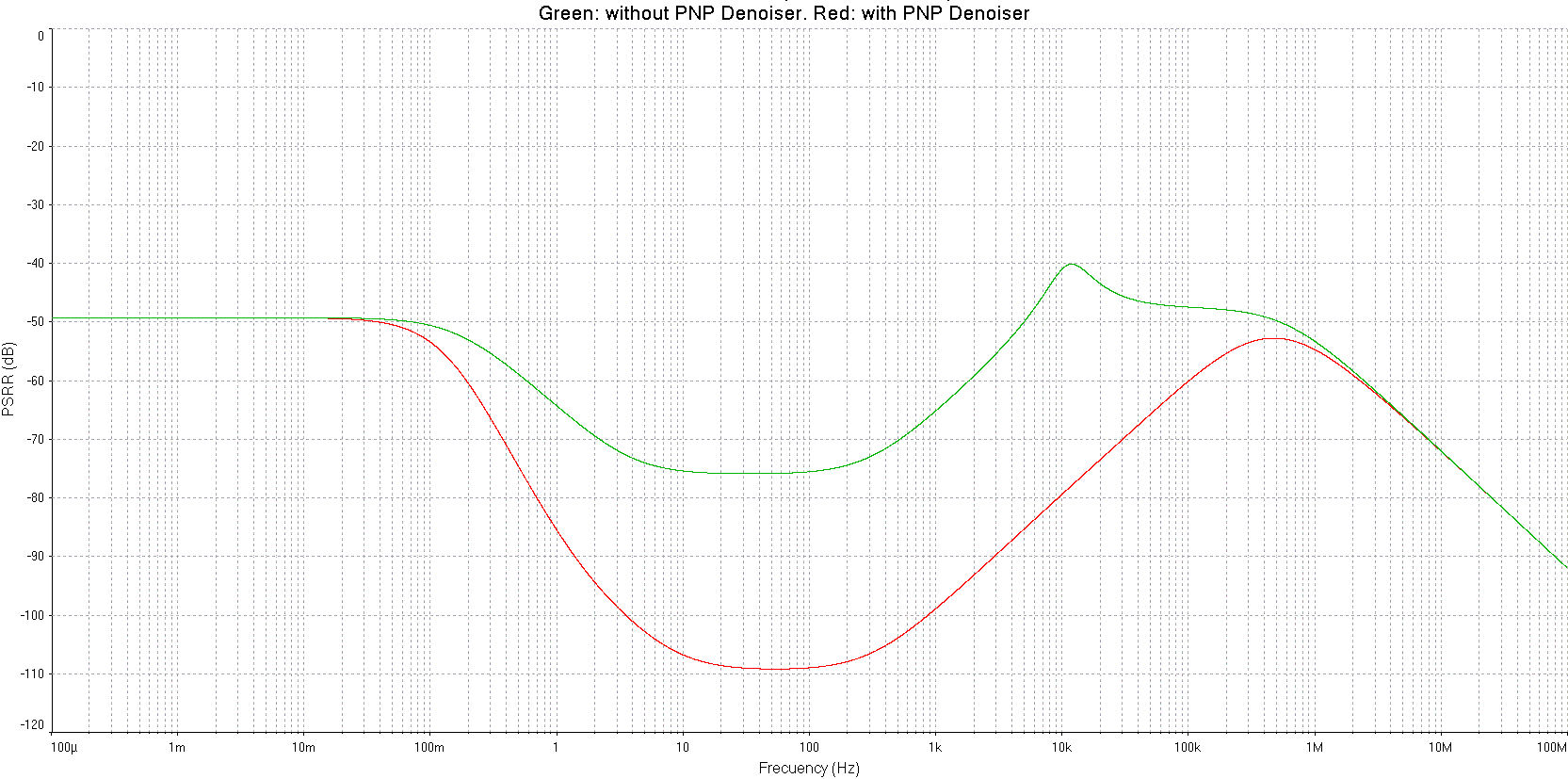

Simplest PNP Denoiser vs. traditional regulator configuration without PNP Denoiser:
attachment.php

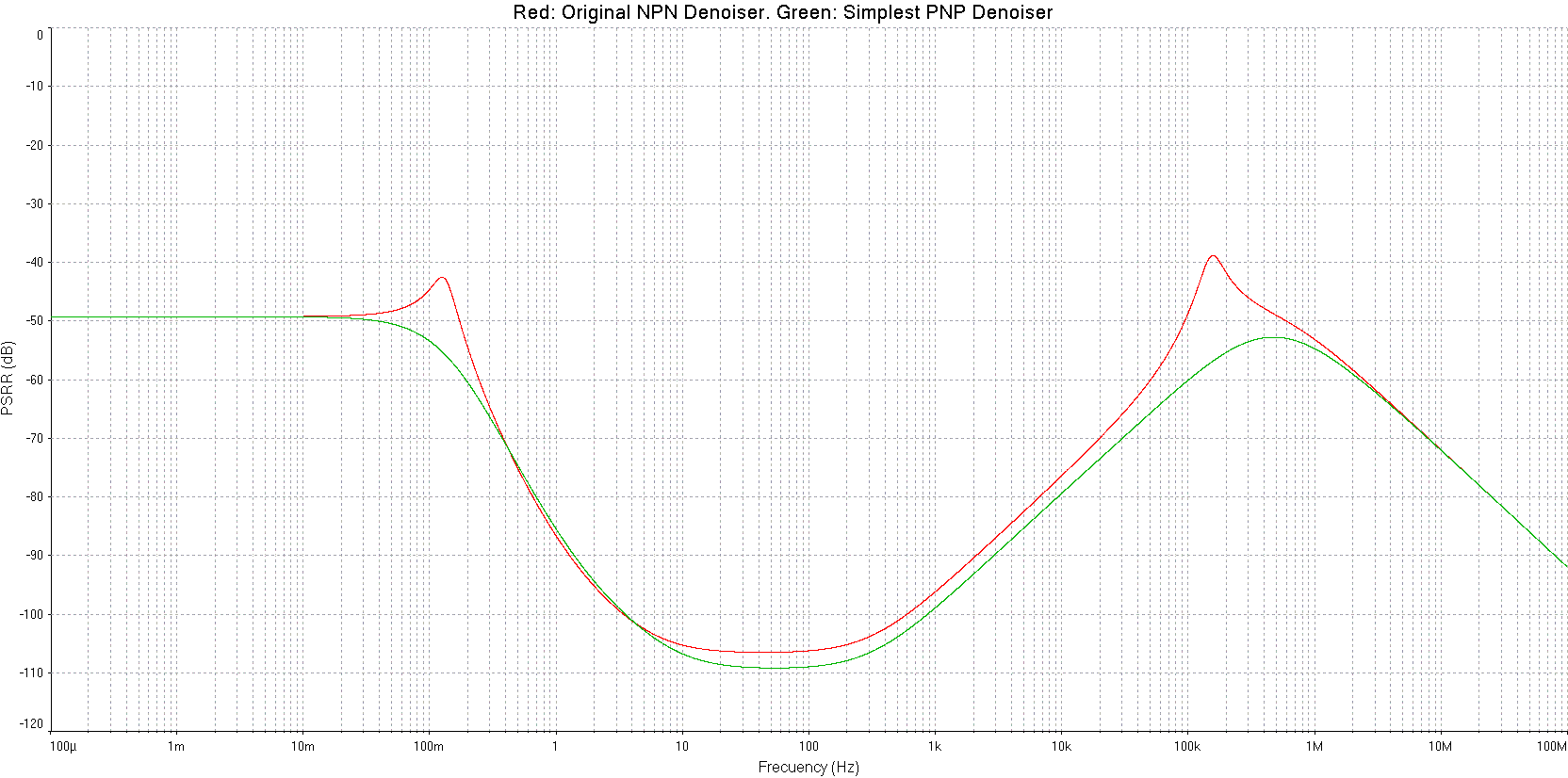

Original Elvee NPN Denoiser vs. Simplest PNP Denoiser:
attachment.php
Thanks Elvee. I must confess by inverting the configuration did not convince me at all, but I found some quite surprising attenuation simulations, although I had not yet done a transitory simulation. These last results make me forget this variant.
Best regards
AC analysis does not care about the polarity of the feedback, or even the functionality of the circuit you analyze.
Unless you are absolutely certain that your circuit is actually functional, you need to perform at least a basic sanity check with a transient analysis, otherwise you may find yourself lost in the fairy land or Santa Claus realm, where everything looks like candy and gingerbread, except they are just cardboard props and decorations...
