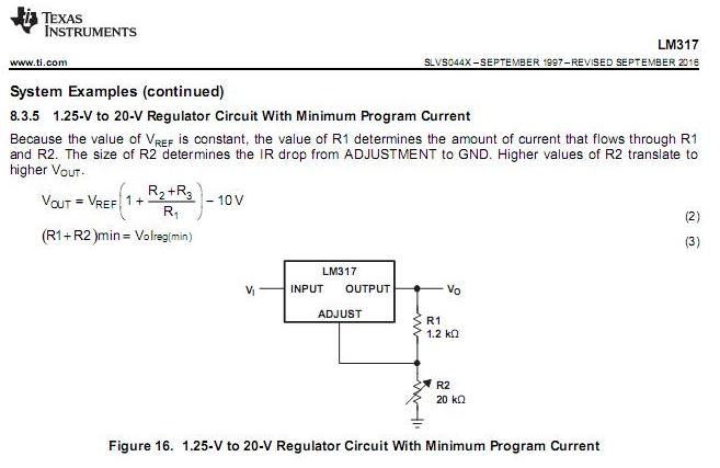

Texas Instr datasheet shows values from 120 to 1k2 als R1 . 1k2 as the minimum program current as they call it.

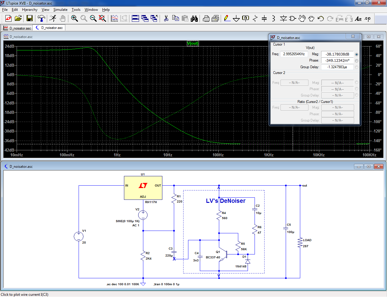

C2 diminishes as R4 goes to even 560 ohm . So If I want R4 more like 5k6 , R5 560k and C2 47u to 100uF ?
If you want to evaluate a particular type, it can be done in a matter of minutes on a breadboard
We can't evaluate without propper measuring equiment. That's why I depend on you.
In the TI datasheet (www.ti.com/lit/ds/symlink/lm117.pdf), I was unable to find a mention of R1 > 243 ohm (except in a special application using a LM329, but that is not a standard use).
I probably missed it.
Anyway, the 317 will still function with values much larger than 240 ohm, but it will not meet its datasheet specs, that's understood.

I found an earlier document where a regulator with a minimum program current example here, page 6:
https://www.sparkfun.com/datasheets/Components/LM317.pdf
No other details are given, which means that the normal specs are no more supported, just the functionality.
It has apparently been expurgated from later versions.

A good compromise will be 390 or 470 ohm for R1 and 3k3 to 3k9 for R4 leaving the rest as it is.

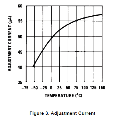

It is easy to compute, at least for temperature because a graph is provided in the DS:
attachment.php
Between 0 and 50°C, the variation is ~5µA.
If you use the maximum 1K2 resistor, that is 6mV, ~0.5% of 1.25V or 0.01%/°C of additional drift.

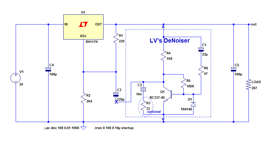

Here is an updated denoiser schematic, including the polarities of capacitors
attachment.php
The voltages of the capacitors have to match the output voltage (and input in the case of C4, which is optional: in principle, it should already be there).
The calculation of the output voltage is just like an ordinary 317 reg: use R1 and R2 in the formula provided in the datasheet (for 24V, R2 would need to be 4K1).

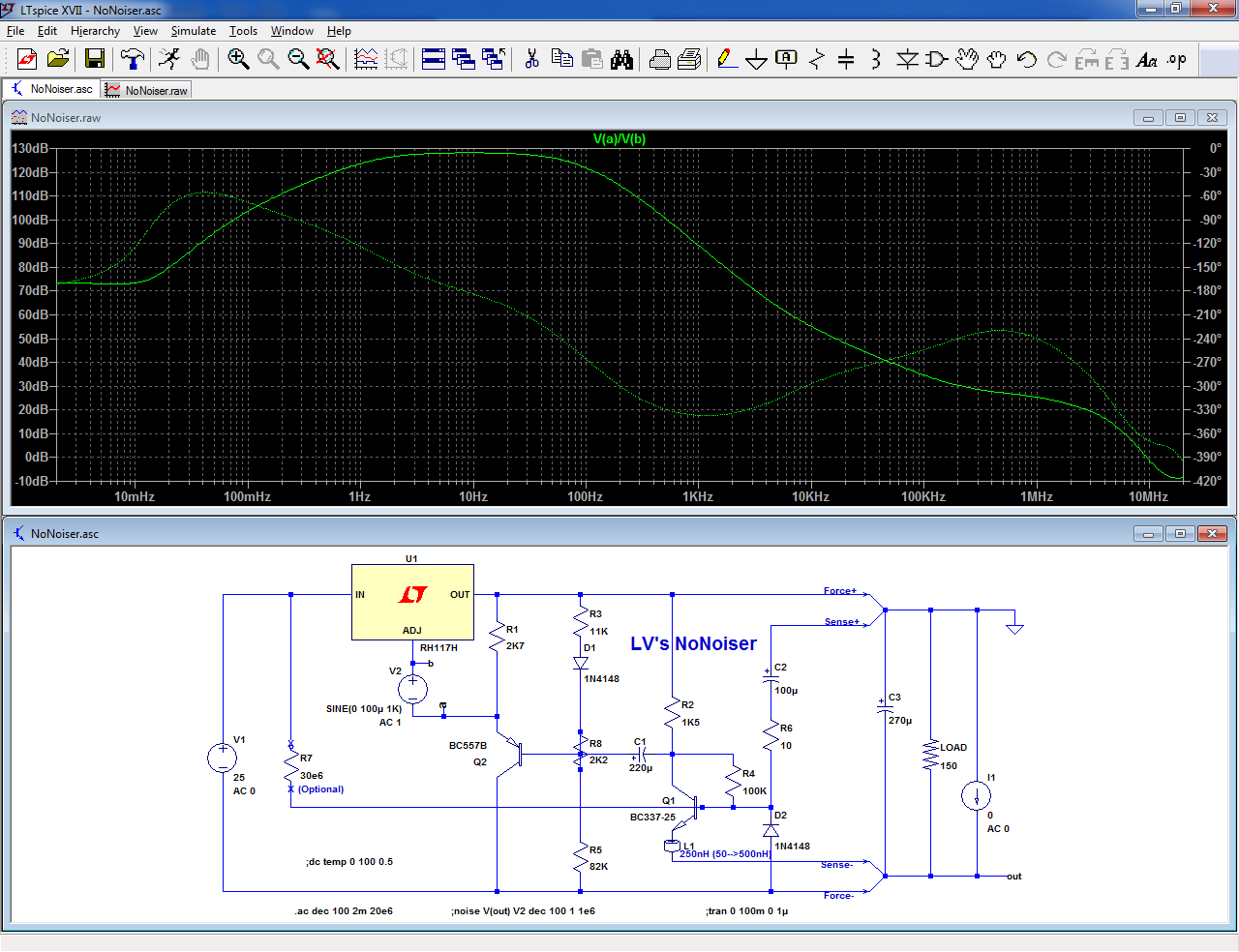

For the nonoiser, the adapted schematic is here:
773335d1565207397-noizator-magic-active-noise-canceller-retrofit-upgrade-317-based-reg-nonoiserd4-png
The base formula is no longer usable, but I provided exact and approximate alternatives here:
