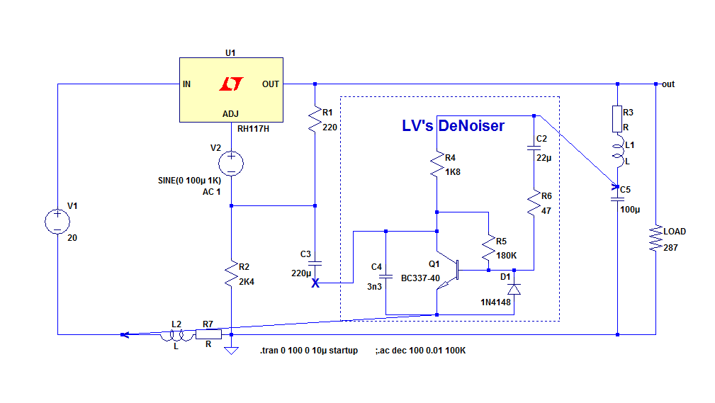

Here is an updated denoiser schematic, including the polarities of capacitors
778618d1567280403-noizator-magic-active-noise-canceller-retrofit-upgrade-317-based-reg-denoiserd5-png
The voltages of the capacitors have to match the output voltage (and input in the case of C4, which is optional: in principle, it should already be there).
The calculation of the output voltage is just like an ordinary 317 reg: use R1 and R2 in the formula provided in the datasheet (for 24V, R2 would need to be 4K1).

D-Noizator: a magic active noise canceller to retrofit & upgrade any 317-based V.Reg.
Thanks, now is more clear, but what is R8(2K2) in non noiser circuit?
Is it a variable resistor?

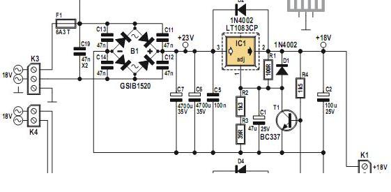

Here's a recent ,well 2010 , Elector circuit . Notice the 47nF over the diodes. Can 10n to 47 nF hurt much even if you don't need them ?
(I don't know how diyaudio regards copy rights with posting stuff from Elektor)
It is a trimpot. I drew it that way, to keep the drawing functional in sim.
If you don't need adjustment, simply short k-D1, b-Q2 and R5 (that's the configuration used by the sim)
They are probably going to do no harm: they might cause some relatively low frequency ringing on the AC side, but in principle it should be innocuous.
On the plus side, they will ensure a HF continuity between the DC and AC sides, which is desirable to avoid modulation effects from the rectifier diodes, but a value lower than 47nF will be as effective, and will result in a higher damping.
One could discuss the merits of a better damping vs. higher ringing frequency, but if you feel it's a concern, you can opt for Mark's bell-ringer solution.
Anyway, keeping ~4.7nF directly across each diode is advisable, to eliminate PIN-diode and similar effects: it will help eliminate buzzing in nearby radio receivers

The circuit is designed for highish Hfe transistors, like the BC337-40 or the ZTX.
However, because of the (feedback) mode of bias, and the fact that the correction amplifier should only operate on a small dynamic range*, practically any gain range will always work with any bias resistor (within reason, of course).
What is going to change is the performance: I have used a collector resistor as large as possible, whilst keeping the collector current as large as possible, to maximise the transconductance and the voltage gain.
Since these objectives are somewhat contradictory, the C-E voltage is kept to the minimum practical to remain in the fully linear range, and accept normal component deviations.
If you go outside the normal deviation, the circuit will continue to function, but with a penalty of perhaps 2~3dB, depending on the values.

What is the optimal C-E voltage for the DeNoiser ?
For a "normal" use, the lowest possible while remaining in the linear regime (out of the quasi-saturation region): on the right of the dotted line in this graph:
attachment.php
This will maximize the collector load and the voltage gain.
Numerically, this means >2*Vbe.
What is a normal use?
As a regulator for sensitive, low noise circuits.
If the load generates a strong, HF modulation current like a class B amplifier used to drive a HF magnetic loop, the correction transistor will need more C-E room to cope with the dynamic range, but that is normally exceptional.
In your original design , I measured about 4,55 V (at 15 V output and a BC817-25) .
That's perfectly OK, and increasing the collector resistor would only give very marginal improvements.
. So what is the ideal C-E voltage , and when/how does the noise of these high ohms resistors come in play ?
In principle, they have no effect on the noise because the gain provided by the transistor and the low impedance of the regulator output makes them irrelevant.
An exception could be the collector resistor, if you use a type (like carbon-composition) having a very large excess noise, but with all other types (including carbon-film), it is a non-problem

Somehow I managed to miss this thread before. Very neat, I must say. If in doubt, I'd rather be using an LM317, a BC337 and a few passives than some exotic specialty part (which have a habit of becoming unobtainium eventually). Not like any sanely-designed circuit should actually require regulator performance like that, but hey - at least the power won't be the bottleneck. The only thing I don't like is the overshoot, probably a result of the two poles (related to the two coupling caps) being too close together.
I have to wonder whether you couldn't upgrade a (Darlington or MOSFET) cap multiplier to "super" level with a DeNoiser. I don't see why not. The result would appear to be looking an awful lot like a basic voltage regulator, just all AC-coupled, and presumably perform similarly as well. Sometimes you just want a clean supply, but don't care what it is within certain limits (a zener can be included to avoid overvoltage).
I have rebuilt the setup and made the comparison: with the "regular" resistor values, I arrived at 0.55µV total noise (10Hz-10kHz); IIRC, it is a bit higher than the previous results, but the transistor is different, it is a BC337-25, and and I didn't take the utmost care in the grounding scheme, etc., and it is a breadboard.
I then increased all the resistors by a factor 5: 1K8-->9K1, etc. except for the input protection resistor.
I left all the caps identical.
To my surprise, the degradation was barely noticeable: the noise reached 0.6µV.
So, reducing quiescent current by a factor 5 has ~no impact on noise performance.
That's radical , a factor 5 , but good to know that 2 or 3 times as much , like I want, will do no harm. With 9k1 , did you measure the Vce with ... 5 x 180k = about a 1M base resistor ? Did you keep the 47 ohm resistor the same or also x5 ?
What is the input protection resistor ?
Did you mean also the LM317 bias setting R times 5 ? So going from the 220 ohm to 1k2 over the 1,252 V ref ?
I just did tests with an 1k8 resistor there (but without the DeNoiser) , to test a low quiescent current regulator for a logic IC circuit , and it still works , but without load the output voltage is a few 10's mV higher. I seems 1k2 is the highest you can go to keep it safe with low current loads as not-doing-anything CMOS logic IC's.
As the collector resistor was also scaled in the same proportion, there is no significant change, except those due to variations in Hfe; and as I said, the exact Vce is unimportant.

But how can you make Kelvin connections on the input? How can you separate the input ground from output ground?
The LT317 is basically a 3-terminal device, with a common ground for both input and output, so how can I "separate them" ?
It could, but it depends on what you want to achieve.
A prereg (without denoiser) will double the PSRR, but the output noise will remain the same.
Thus, the logical place to place a denoiser is at the last regulator.
Note that the denoiser alone improves the PSRR by 30~35dB. Would you need a prereg anyway?
The denoiser will beat the noise perf hands down, but it will not match the rejection.
However, with the Nonoiser, you will reach an even lower noise level, 125dB~130dB PSRR, plus one or two side benefits like stellar (µΩ-level) output impedance, simplicity (just one more transistor instead of a full regulator) and a dropout voltage halved....
Many kind thanks for your inputs. The reason I asked about that acoustica.org last picture schematic, is because I actually implemented it some time ago within some of my DIY audio devices (DAC, CD transport), and was very much impressed by the resulting SOUND. Spectacular improvements to my ears (sound-scene, holography, black background, et al).
So now I am wondering about bettering that small circuit, in hope of achieving even better sound.
The thing that worries me is the statement regarding "Kelvin Sensing". The modified CD Transport basically uses a common ground throughout.
Although, I could do the Kelvin Sensing within the independent low noise power source that I built for the off-board low jitter clock. Hmmm...
