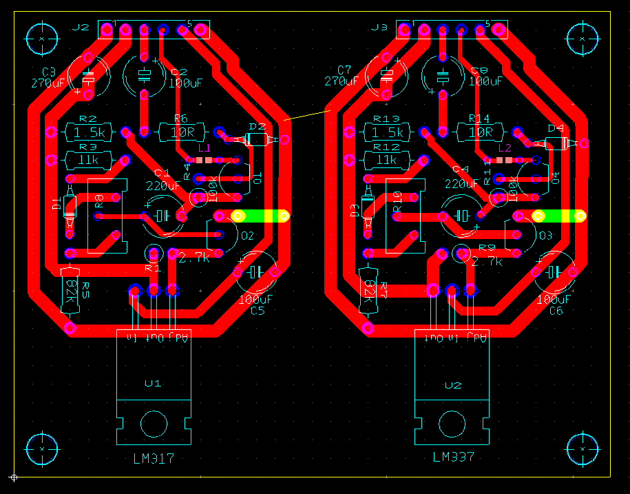

There's a simple little fix I thought of when having dinner with the XYL -- the IN and OUT pins of the 317 and 337 can be fixed up so that the board can be used with either device -- probably a very slight impedance bump with the vias. will work on tomorrow morning.
as Elvee stated pages ago, just reverse the direction of D1, D2 and the electrolytics and "bob's yer uncle"
It would be GREAT if someone would make up a PCB design for the denoizator (both polarities) that would fit on a typical LM317/337 bipolar regulator board. Maybe then make a bunch of boards and offer them for sale? I have at least a dozen different pieces of gear with these sort of supplies in them that would benefit greatly from this modification!
It would be even greater if that "someone" was you: you seem to have relatively large needs, which makes a largish batch production advantageous, and you could sell the surplus to other members.
Personally, I am not a commerce guy, even for the good cause, even for no profit, and I have built the two I needed on bits of perfboard in less than a hour, I see no advantage going the hassle of designing, ordering PCBs for such modest needs.
Of course, if someone designs and sells PCBs, I will probably buy a pair for future needs, and I don't mind paying a reasonable supplement for the work involved.
Note that unlike the nonoiser, the denoizator PCB is absolutely identical for both polarities: you simply need to reverse diodes, Ecaps and use a BC327 instead of a 337.
This means that you could make a panel of 12 pieces for example, and cleave them in pairs or singles and populate them according to your needs.
The cost per board, the one pictured below poz and neg -- about $6.60 for 100 produced in the US including shipping and sales tax. I am awaiting a quote from China.

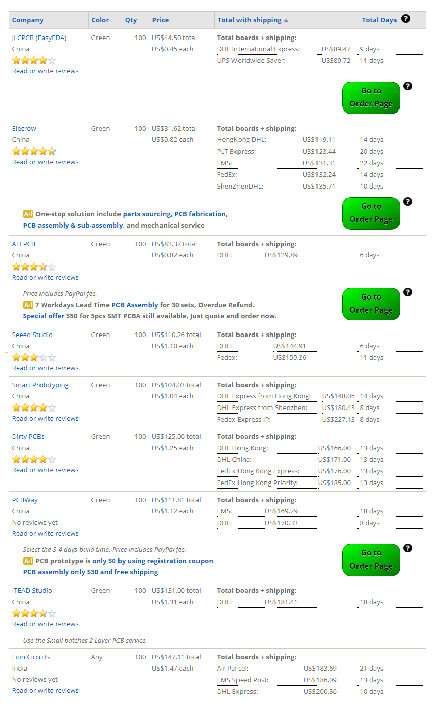

China PCB fab quotes $0.89 per board including shipping to New Jersey. DHL rings your doorbell with the delivery, 11 days after you upload the PCB CAD files. qty=100 price. I told them the board was 3.00" by 4.00" (a guess).
The website pcbshopper dot com is your friend.

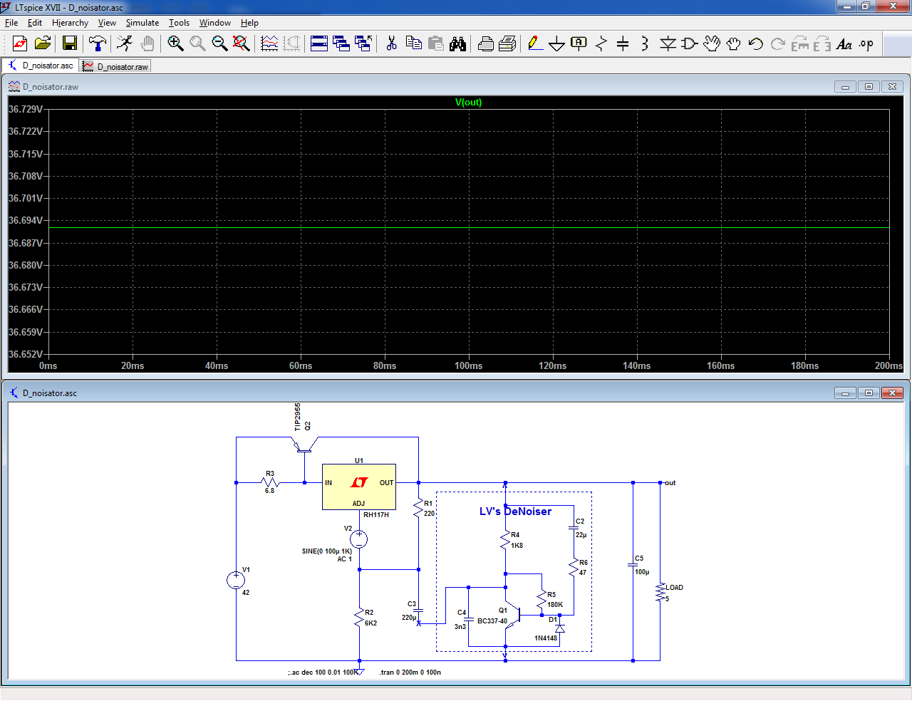

Any caveats to using the DeNoiser with a slightly higher voltage (37 volts) and much higher current (7 amps) regulator (uses external pass transistors)? Should I scale up the resistor values?
You mean something like this?
attachment.php
It seems to work in simulation, but since the transistor modifies the loop characteristics of the 317, the reality might be different.
In particular, it might be necessary to modify C4, and to add a small series resistor (0 to 100 ohm) with it.
BTW, I now recommend a larger value of C4 for any version: 10 to 22nF.
The HF noise reduction is slightly affected, but the stability is improved.
I do not recommend scaling up the resistors values: it will reduce the performances.
The only adaptation necessary is to use a powerful enough resistor type for R4: for 37V, 0.5W is sufficient (you can use 3/4W or 1W to have some margin)
