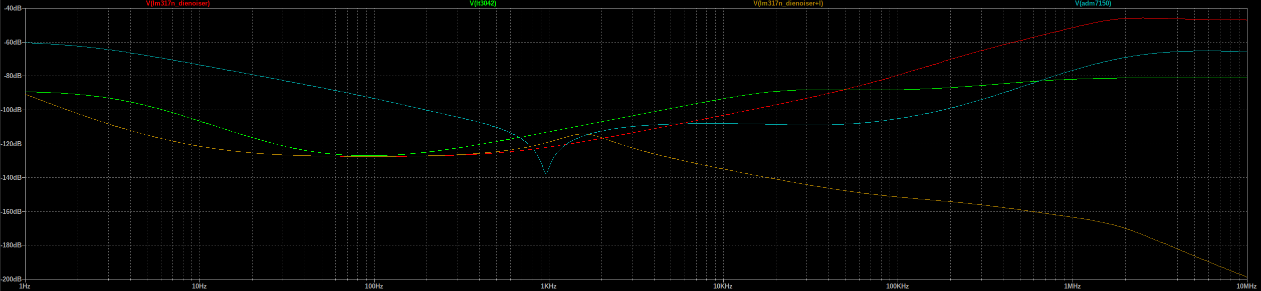

But simulation do indicate that LT3082 +dienoiser would have better PSRR than datasheet application of LT3042 to 5MHz. I won't be able to measure that sadly as I don't have the gear, I'm limited to audio only. But if the measurements match the simulation predictions I'd say it's a good indicative that it might offer better PSRR at higher frequencies as well.

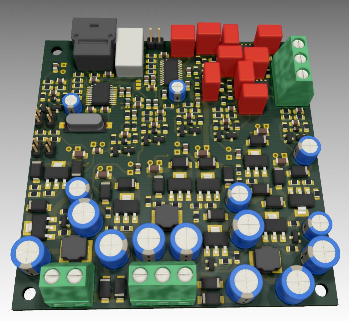

There's 6 dienoisers on this DAC board, +-12V for opamps, +5VACC/Vref, +5V analog for clock recovery, and two +3.3V digital for each WM8804 and CS4398. Being cheaper than LT3042 means I can easily use more.

The difference in PSRR vs LT3042 is not that big at higher frequencies, 30dB or so, but LM317+dienoiser seems to have lower output impedance at those higher frequencies. Side by side the end result might very well be identical as perception by most people. Considering the price and ease of solder it seems pretty easy choice.

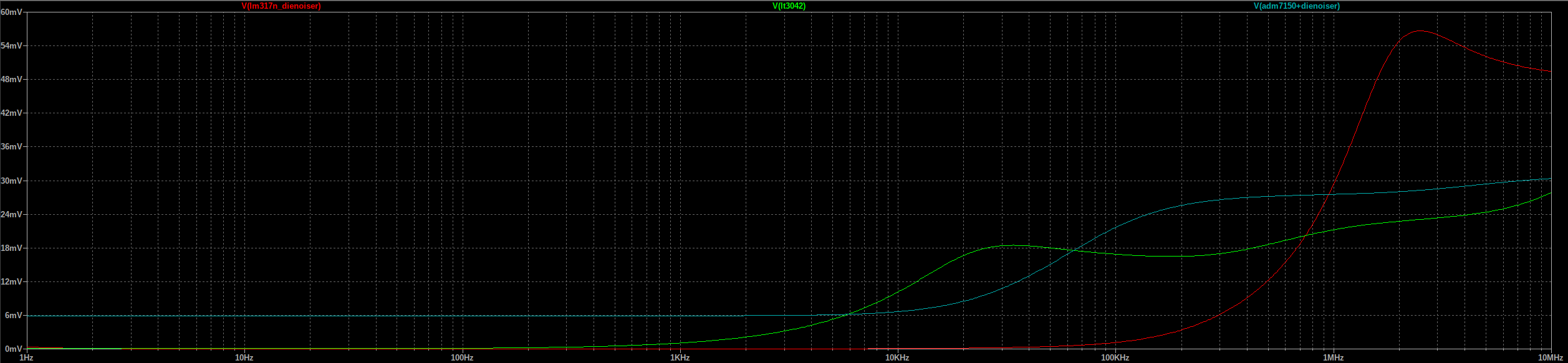

Adding 100uH in front of the LM317+dienoiser solves the PSRR at higher frequencies issue, and it gives very good performance, and still cheaper overall. Yes it is an extra part that takes extra space, not much tho. And it isn't to get to LT3042 performance, it goes way past it. Totally worth it.
Now we add ADM7150 into the mix, to see how the stock datasheet application stands between LT3042 and LM317+dienoiser and LM317+dienoiser with L in front. We also can have a look at the comparison between output impedances.
These are all simulations of-course and are no replacement for actual measurements. But if HF PSRR isn't an issue with the extra L, and LM317+dienoiser seems to have lower output impedance to 700KHz or so, what exactly is there that would outshine the LM317+dienoiser in digital? (edit: maybe low dropout? that is a good advantage indeed) We're also talking about sot223 package LM317.
