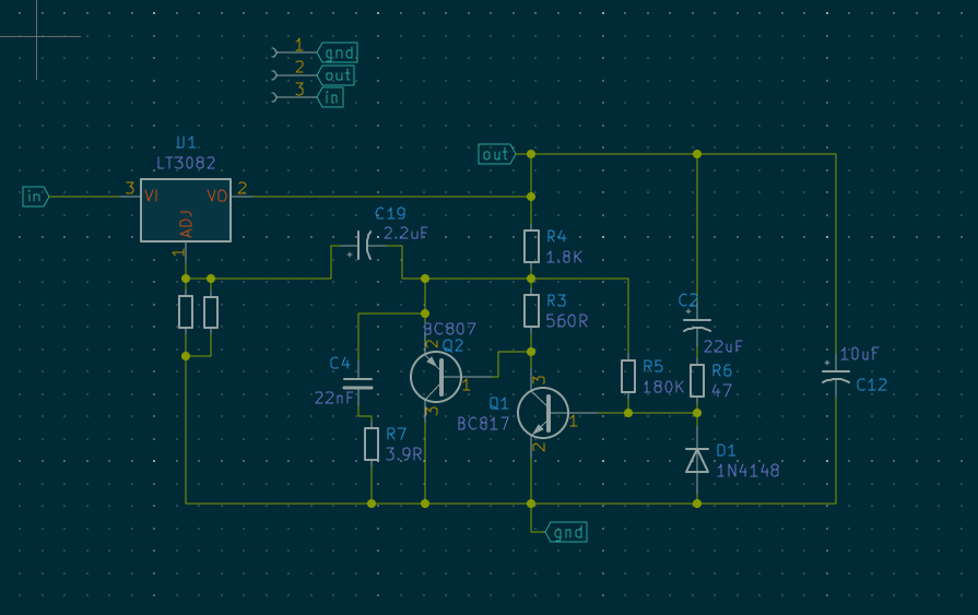

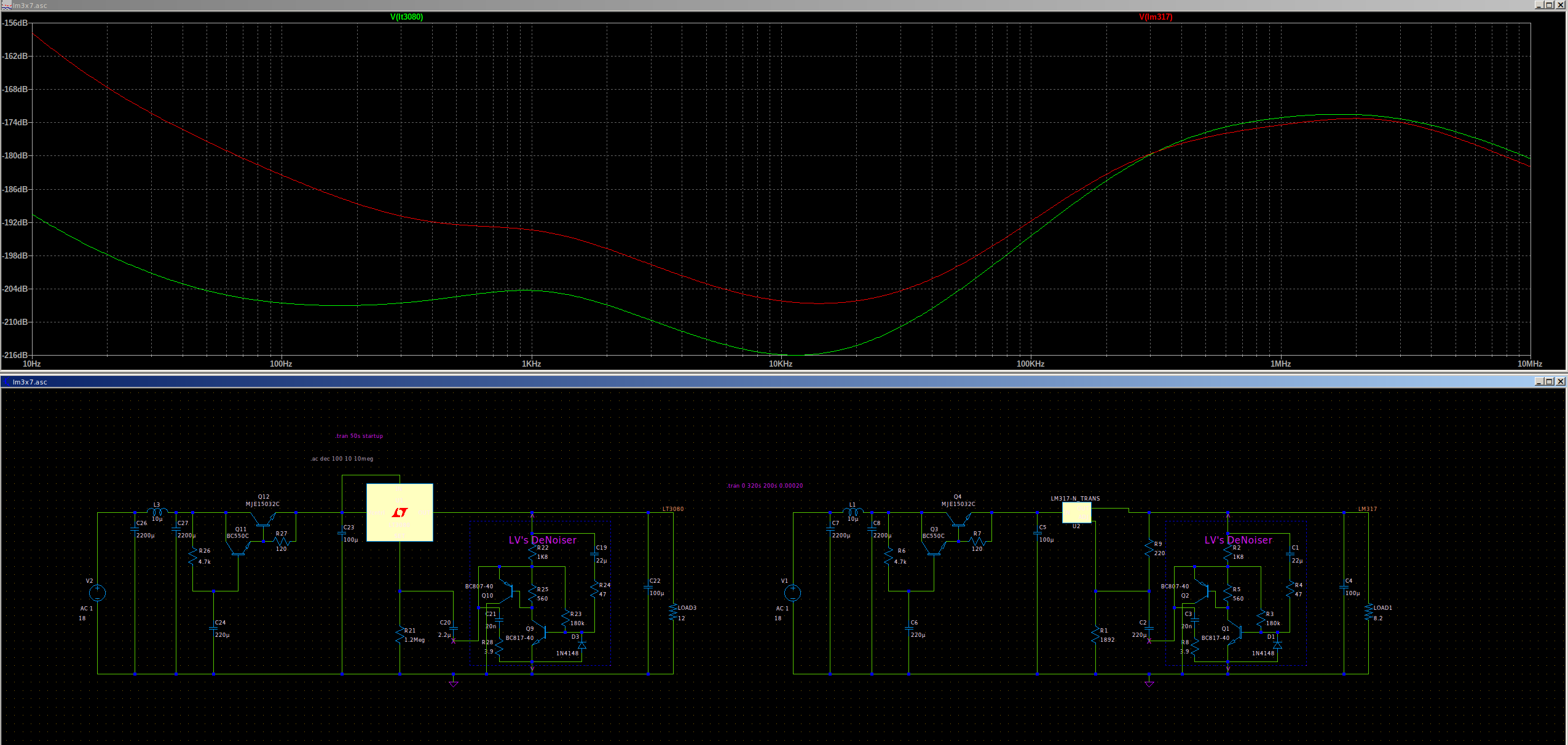

The settling time was related to the high 220uF capacitor from dienoiser. For LT3080/LT3082 it needs to be 2.2uF or so and the behavior is normal like a LM317 + dienoiser.
But I need to receive the LT3082 so I can test it and confirm this. But in simulation it looks ok.

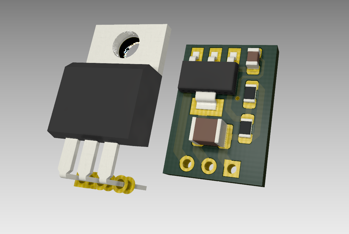

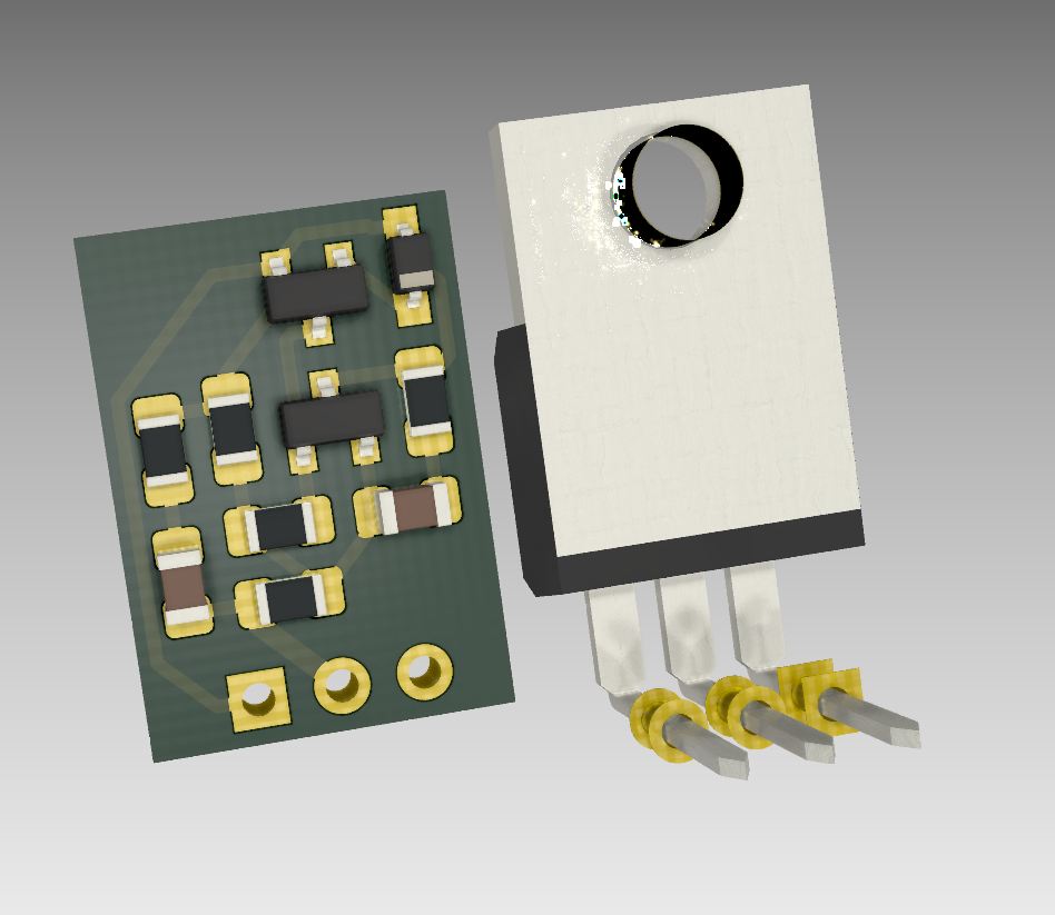

There's some advantages to LT3082 being SOT223 and also needing a small ADJ dienoiser cap of 2.2uF means all dienoiser circuit can be 0805 for passives. The 22uF one can be found in 0805 with 16V rating without issues and is not expensive.
Looks great thinking of your latest single LM317 board.
They should be the best performing, smallest and cheapest LM3x7 supplies. If anyone knows others (full 1.5A output) that are better performing (theoretically atm) and cheaper and smaller (at the same time) do link them, curious to see them. (edit: and also DIY-able )
The inductor should be the most expensive part at around 2$ I think. The 2200uF/35V Panasonic FR should be around 1.5$. I'd also use the LM3x7N versions. I got these as well in TO220 format and will be able to test them. Curious if they have lower noise than the classical LM3x7 versions.

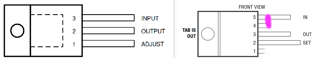

I attached the pinout for both LT3080 and LM317, and as you can see even if the LT3080 is a 5pin TO220 device, the pin order matches between them. You'd have to completely cut pin no1 from LT3080, and link 4 with 5. Also LT3080 uses only one voltage setting resistor, so you'd omit the 220R one, and use a 2.2uF coupling cap to dienoiser.
