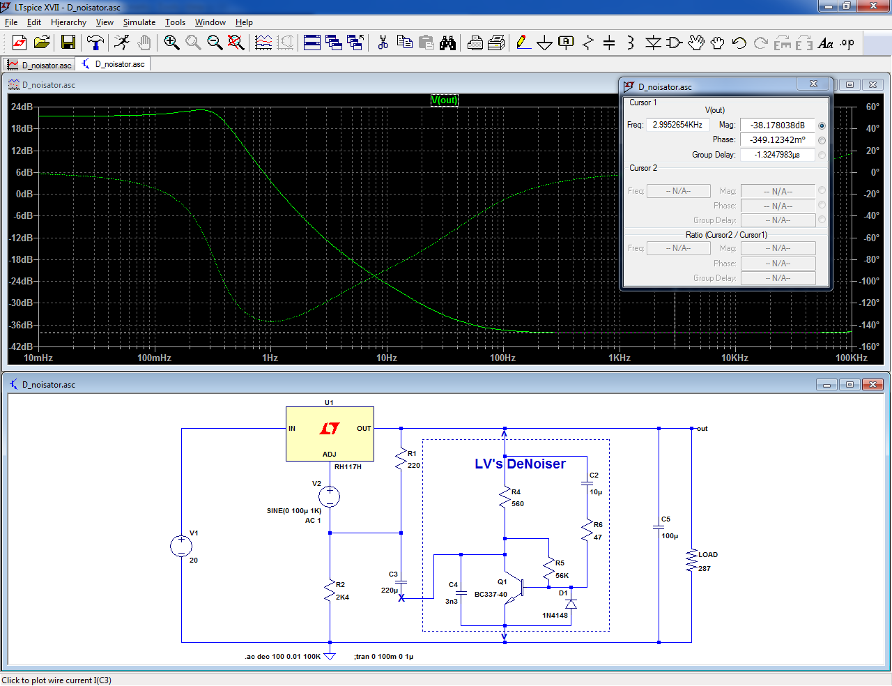

Let us start with the basic regulator (including the additional bypass cap, since we strive for the lowest noise).
An additional source symbolizing the noise is shown explicitly.
The bypass cap is effective down to ~10Hz, but the level does not fall below 0dB.
723585d1545415628-noizator-magic-active-noise-canceller-retrofit-upgrade-317-based-reg-dnoiz1-png

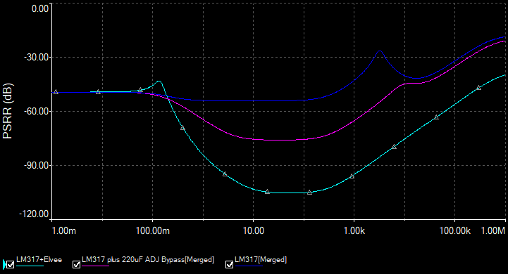

Now, let us add the D-Noizator piggy-back:
723586d1545415628-noizator-magic-active-noise-canceller-retrofit-upgrade-317-based-reg-dnoiz2-png
The floor drops by more than 30dB.
The circuit works by changing the output node into an AC virtual ground.
Therefore, benefits do not stop at internal noise reduction: all the performances benefit: PSRR, output impedance.
Ultimately, the performances are limited by the discrete transistor.
What about the reality?
I made a test with ST and ONsemi samples. They behave as perfect clones, both with and without the D-Noizator.
723587d1545415628-noizator-magic-active-noise-canceller-retrofit-upgrade-317-based-reg-dnoiz3-jpg
With just the cap, the noise is 16μV, as measured by a Levell TM3B.
With the D-Noizator, it falls to 2.5μV~3μV, which seems to indicate that the circuit doesnt deliver all of the promised improvement... except that the noise floor of the TM3 is also 2.5μV~3μV.
The TM3 is not a bad instrument, but it is very cheap, and very dated.
I would need to add a modern LNA to make meaningful measurements.
723588d1545415628-noizator-magic-active-noise-canceller-retrofit-upgrade-317-based-reg-dnoiz4-jpg
It is more than promising, anyway.
Of course you cannot throw a large gain into the regulator's loop without consequences: it is now forced to operate at a gain much lower than unity, and without precautions, it oscillates like mad, which comes as no surprise.
However, compensation seems to be easily achieved, and very tolerant: a capacitor larger than 2nF was sufficient to stop oscillations.
A VLF peaking is visible in the response; it could probably be polished off by increasing the splitting of the poles, or similar measures

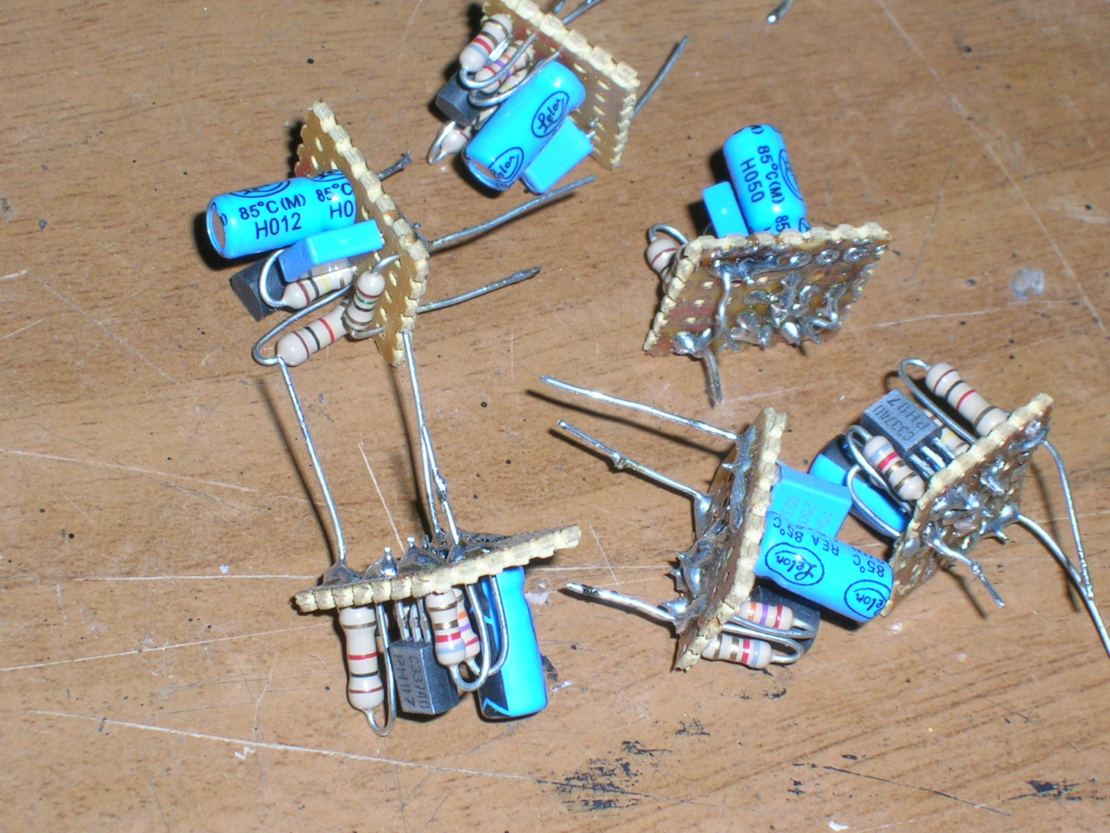

I have been able to refine the measurements: I remembered that one channel of one of my lab amplifiers is equipped with a OPA27.
This brought the noise floor of my test set-up to 0.75µV.
When measuring the D-noizator, I got 1.0µV.
This means that the actual noise is in the vicinity of 0.66µV.
Since the noise with the cap connected normally is still 16µV, the improvement ratio is 27.7dB, much closer to what the sim predicted.
Of course, the test is made on a breadboard, and the transistor is just an ordinary BC337-40 from Philips.
With a good PCB and a super low noise transistor, it would be possible to scrape a few tens of nV

Here is a slightly better tradeoff: the current consumption is increased, but the improvement factor is 38dB, and the VLF peak is mostly gone.
Going further probably makes little sense, since finding a transistor sufficiently good to capitalize on the gain is going to be difficult.

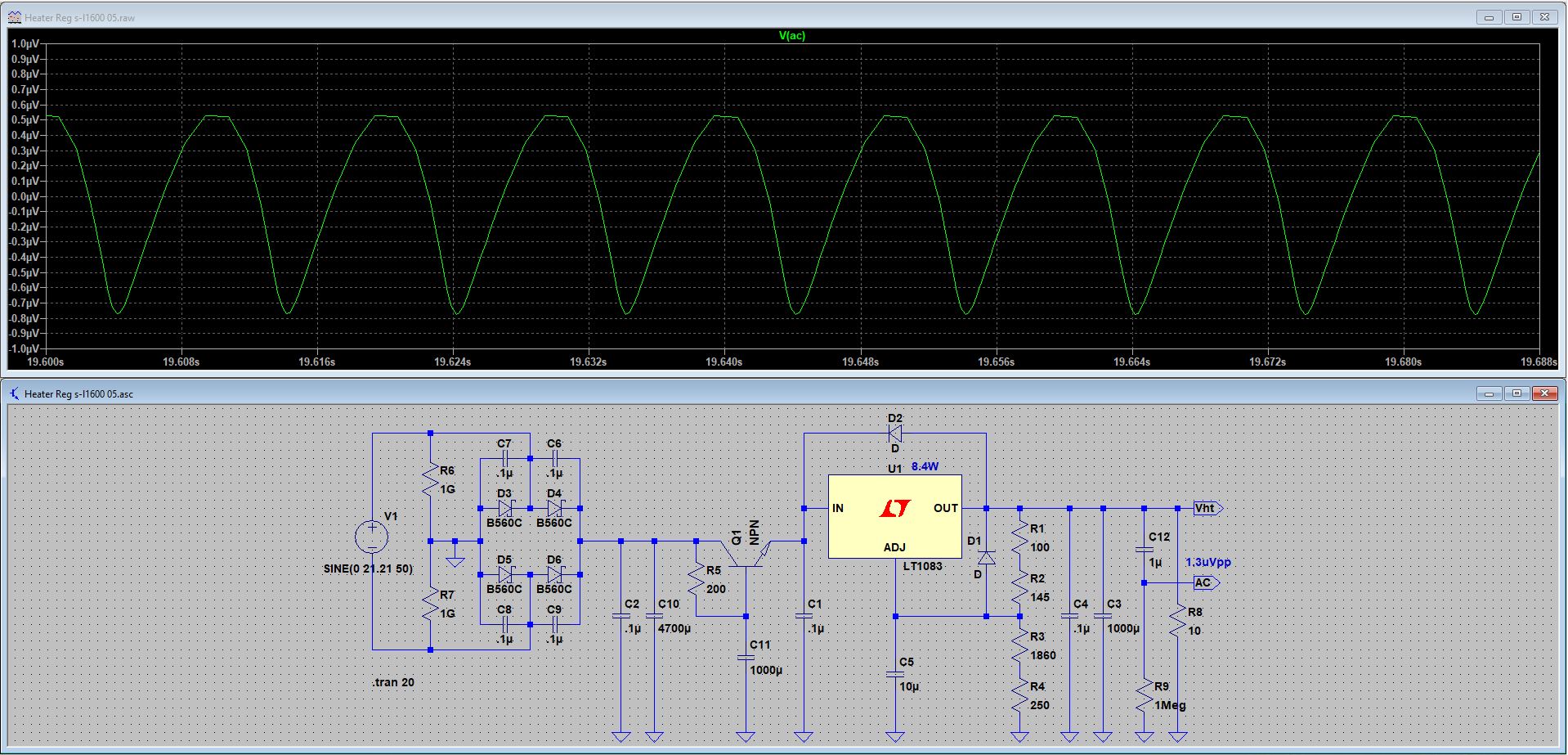

If low frequency steady state power supply rejection is your primary concern, you can cascade regulators. This is one of the options I considered (and rejected) for the heaters of the preamp I'm currently working on: a cap multiplier as a pre-filter for the regulator. Sim yields 1.3uVpp@100Hz, but it doesn't account for the random noise of the regulator itself.

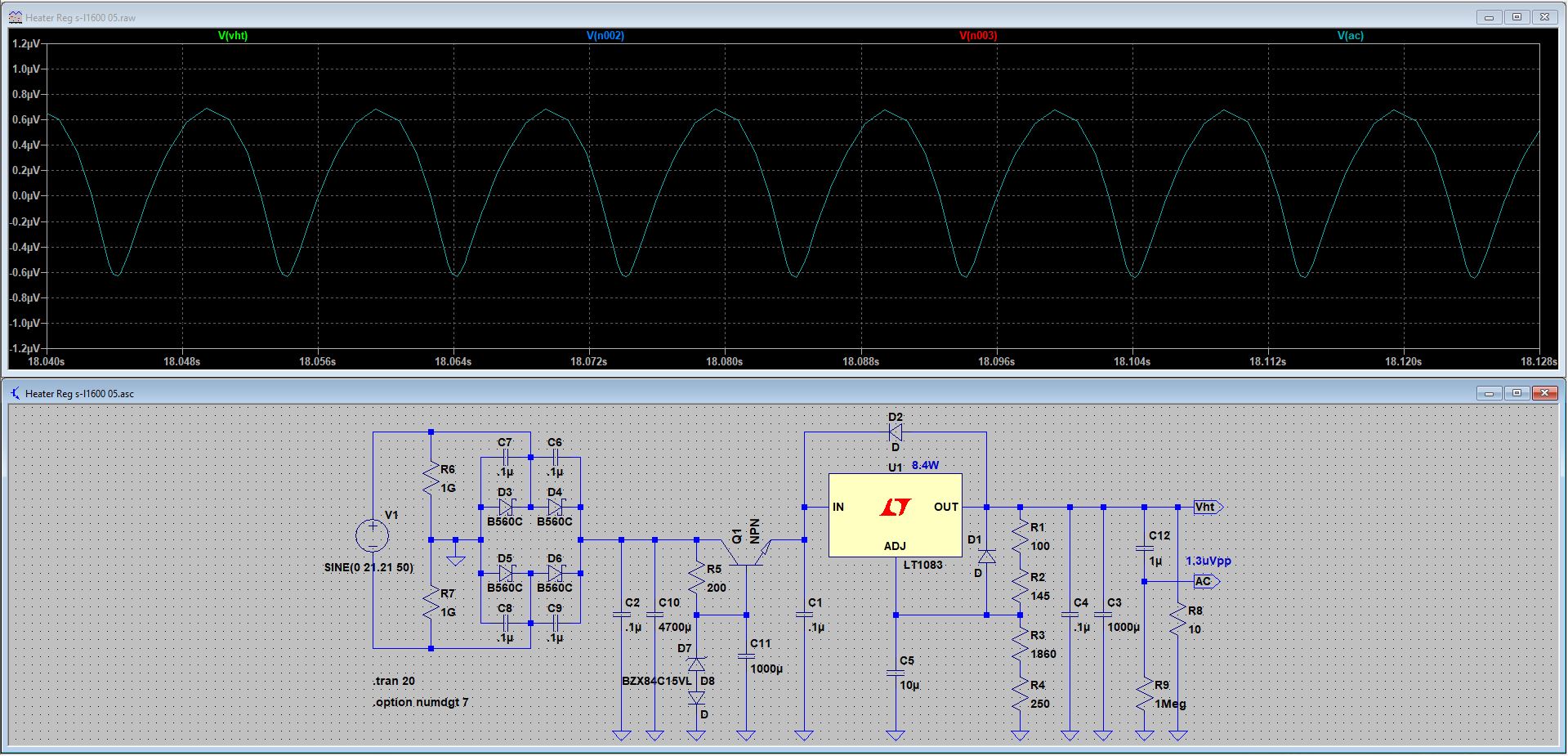

Why no Zener diode at the base of Q1? It will increase mains ripple rejection ("PSRR at low frequencies") by many decibels.
For no particular reason, it's just a proof of concept. But you got me curious, so here it goes: no change, even after I force double precision.
The explanation: the 1000uF cap is worth about 1.6 ohms at 100Hz, whereas the Zener typically is 7-15 ohms, so it's not very effective in this case.
