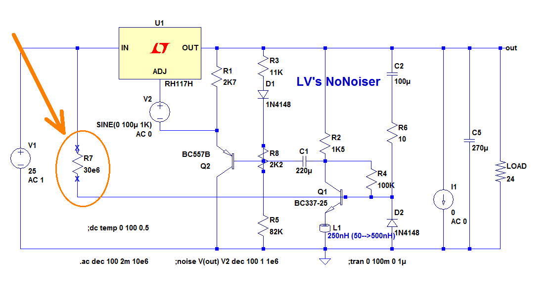

Do you mean this R7 (30 million ohms)?

Let us begin with the PSRR, which is the weakest aspect of the NoNoiser: the measured value @100Hz is 125dB, 1 to 2dB better than the best regulator of the survey (Salas reg, fig. 5).
If a ripple compensation resistor is added (R7), it is possible to gain an additional 5dB.
As said above, R7 is a minor tweak pushing the PSRR from 125dB to 130dB, and it needs to be adapted to your build, ie. you need means of discerning between 125 and 130dB, because sim, etc are of no help.
As a wrong value for R7 could as easily degrade the PSRR by several dB or even several tens of dB, it is probably safer to leave it out.
BTW if you need more than 125dB, you should first question the circuit you are providing a supply for
The high spread for L1 (50nH ... 500nH) seems rather suspect to me. Why not omitting this inductance and provide stability by paralleling R4 with a 47p ... 100p capacitor instead, like in a standard VAS of an audio amplifier? Same question is regarding C4 in your deNoiser circuit. Why not 47p ... 100p between base an collector of Q1 instead of C4?
In this same analogy to an audio amplifier stage: Did you simulate the effect of increasing beta of Q1 by adding an emitter follower, the way (e.g. same principle) Douglas Self does it in his blameless amplifier with TR4/12: /http://douglas-self.com/ampins/dipa/dpafig33.gif ? I am very aware that this would make your simple and elegant circuit more complex, which might be not wanted.
Last question: What is the exact purpose of R8? Fine-tune V_Out?

Compared to yours, the nonoisator has half the dropout, half the wasted power, a 15µΩ output impedance, and the 125dB PSRR is meaningful and useful, because its internal noise is commensurately low (down to 90pV), and does not drown the good PSRR.
It also supports Kelvin connections, which is essential at that level of performance.
The spread is in fact an advantage: it does not mean that you have to select a peculiar value in this range to suit each circuit, but exactly the opposite: locating the compensation there is so effective that it tolerates anything between 50n and 500n without adverse effects.
If you examine the schematic, you see that it would amount to put the capacitor in parallel with R2 (because of C2).
It would be a shunt compensation, doesn't work well and degrades the HF performance.
Same reason
For me, it is a dead link, but anyway an increase in beta is not what is needed: what is needed for an increased performance is a mu increase
Yes, it is a trimpot
Thank you for your explanations, I understand ... I overlooked some interactions!
... For me, it is a dead link, but anyway an increase in beta is not what is needed: what is needed for an increased performance is a mu increase ...
I understand ... but not everything: What is a "mu" increase. I do not understand "mu" and what it's related to.
And sorry for the dead link. My fault. Correct would have been without the "http://"-prefix. Correct: douglas-self.com/ampins/dipa/dpafig33.gif
Mu is the theoretical voltage gain, related to the transconductance, but the transconductance being linked to the collector current, it cannot be increased arbitrarily unless the collector load is active, which brings other types of problems and complications

R8 2k2 ... is this a potentiometer ? Or why is there a connection dot in the middle of the resistor ?
If it's a pot , then you have to tune it ?
It is a trimmer.
You could have to adjust it, because the DC output won't be as accurately defined as in a regular, or denoiser 317 circuit.
In the nonoiser, you have to compute the output voltage slightly differently, compared to a regular 317 circuit.
I will provide a formula, if you cannot compute it by yourself.
Is here too a slow output voltage rise at startup , since the 220 uF is not exactly where it is in regular designs.
