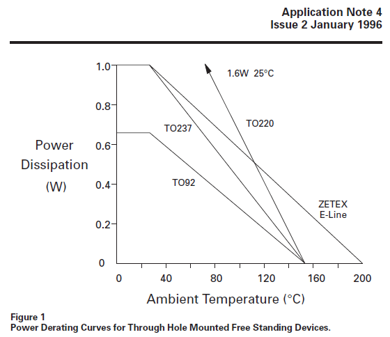

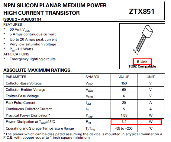

Here is some data from the manufacturer, about the ZTX851 transistor. I've also attached their Application Note 4 which discusses their proprietary, better-than-TO92 package, which they call "E Line", used on the ZTX851 and other Zetex devices.

Fun fact about the ZTX851 : 5 A in TO92 ....huh , what ?
BC337 800 mA.
Just one more request : BD139 , often used in amplifiers .
I have tested the BD's, but they don't perform particularly well (a bit better than the BC547 series, but not as good as the BC337).
The 2SC6043 and even a cheapo S8050 bought from Banggood for a cent or two did better (but didn't challenge the ZTX supremacy).
If you parallel a number of BC337 or S8050, you can also gain an improvement, 3dB for each doubling.
With 4 (preferably matched) 337, you could marginally outperform a ZTX
Luckily in the DeNoiser the ZTX851 only has to take a couple of mA , special E-line package or not. Too bad the BC550 types are not as good because they are readily available in SMD.

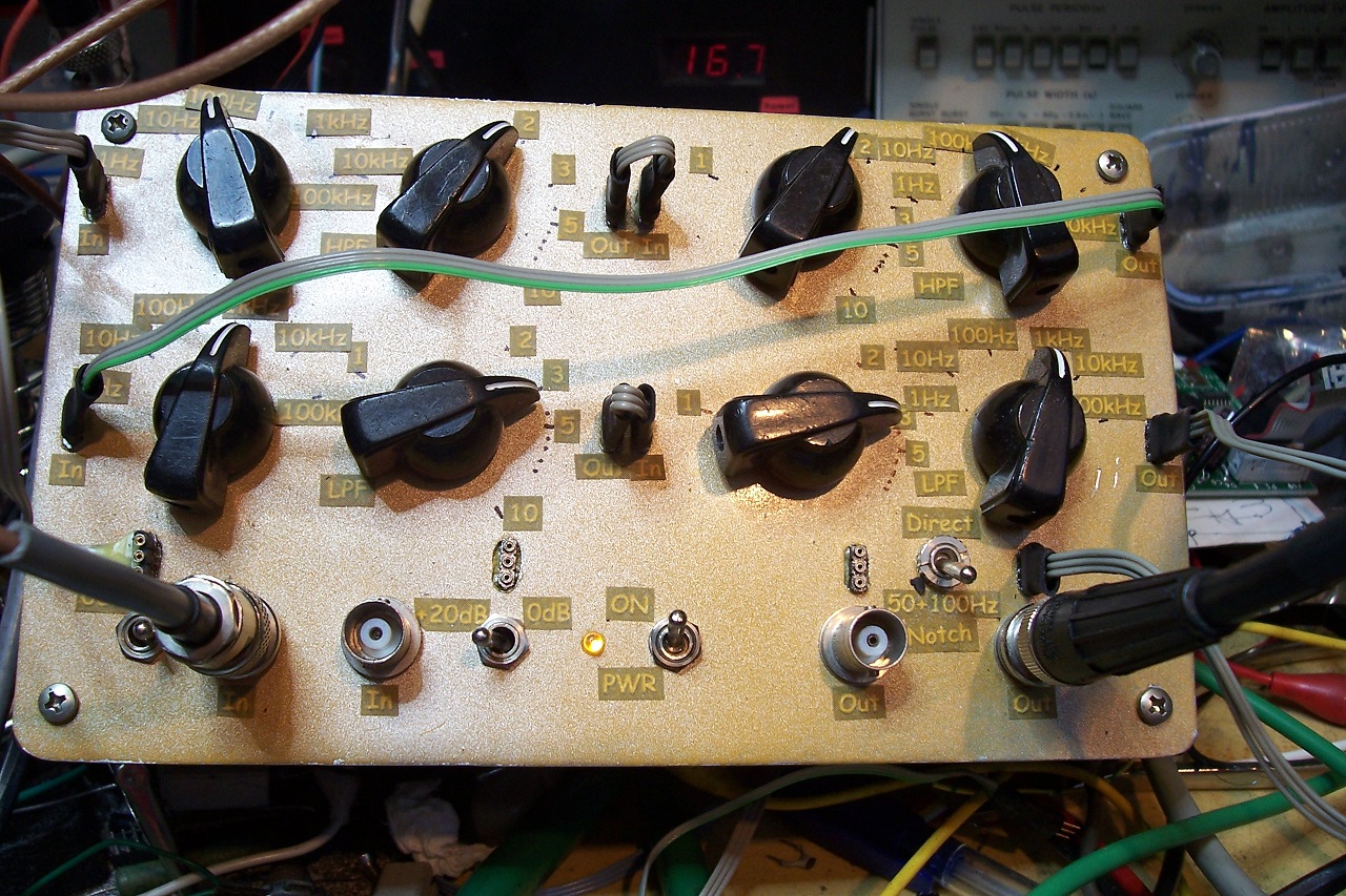

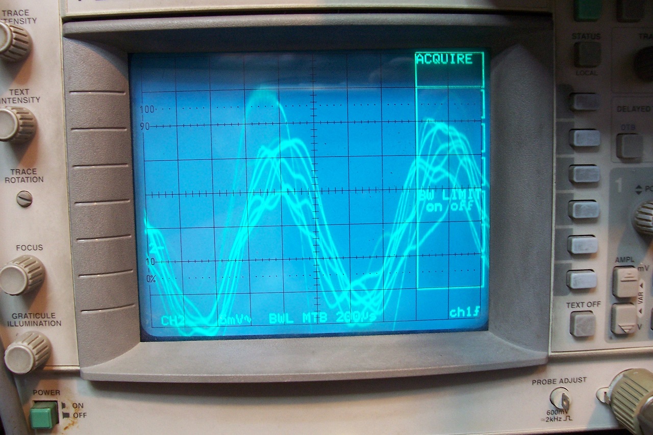

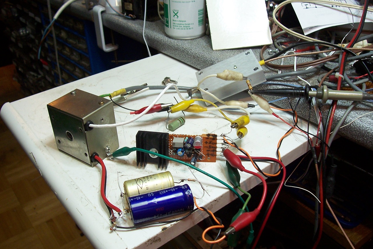

OK, here is the test setup:
attachment.php
The large 150 ohm resistor is the DC load, and the smaller 470 ohm is the stimulus injector (16mApp, 1KHz).
This is the measured output signal, amplified 100,000 times.
attachment.php
It is quite dirty and noisy, even after some LP and HP analog filtering to remove most of the crud:
attachment.php

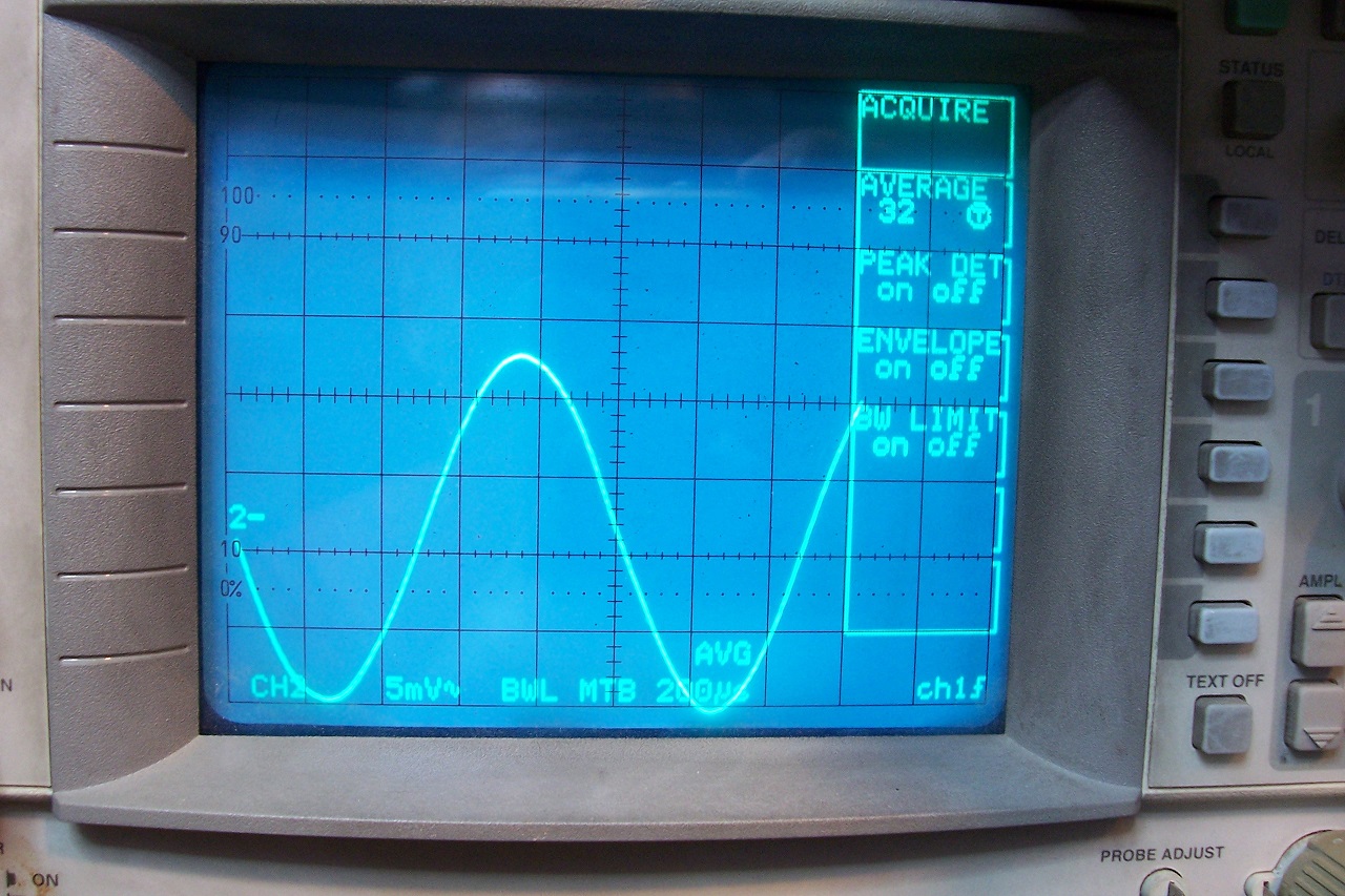

Fortunately, it is possible to get a clean waveform using the averaging function of the scope synchronized directly on the signal source:
attachment.php
The amplitude is thus 4.5div x 5mV =22.5mV
When the amplification is factored in, the amplitude is 225nVpp.
Thus, the impedance is 225/0.016=14,000nΩ=14µΩ
The value is lower than that measured with 500mA output, but I suspect it has to with the ambient temperature, which is now 33°C.
The nonoiser makes the performances mostly independent from the regulator it is attached to.

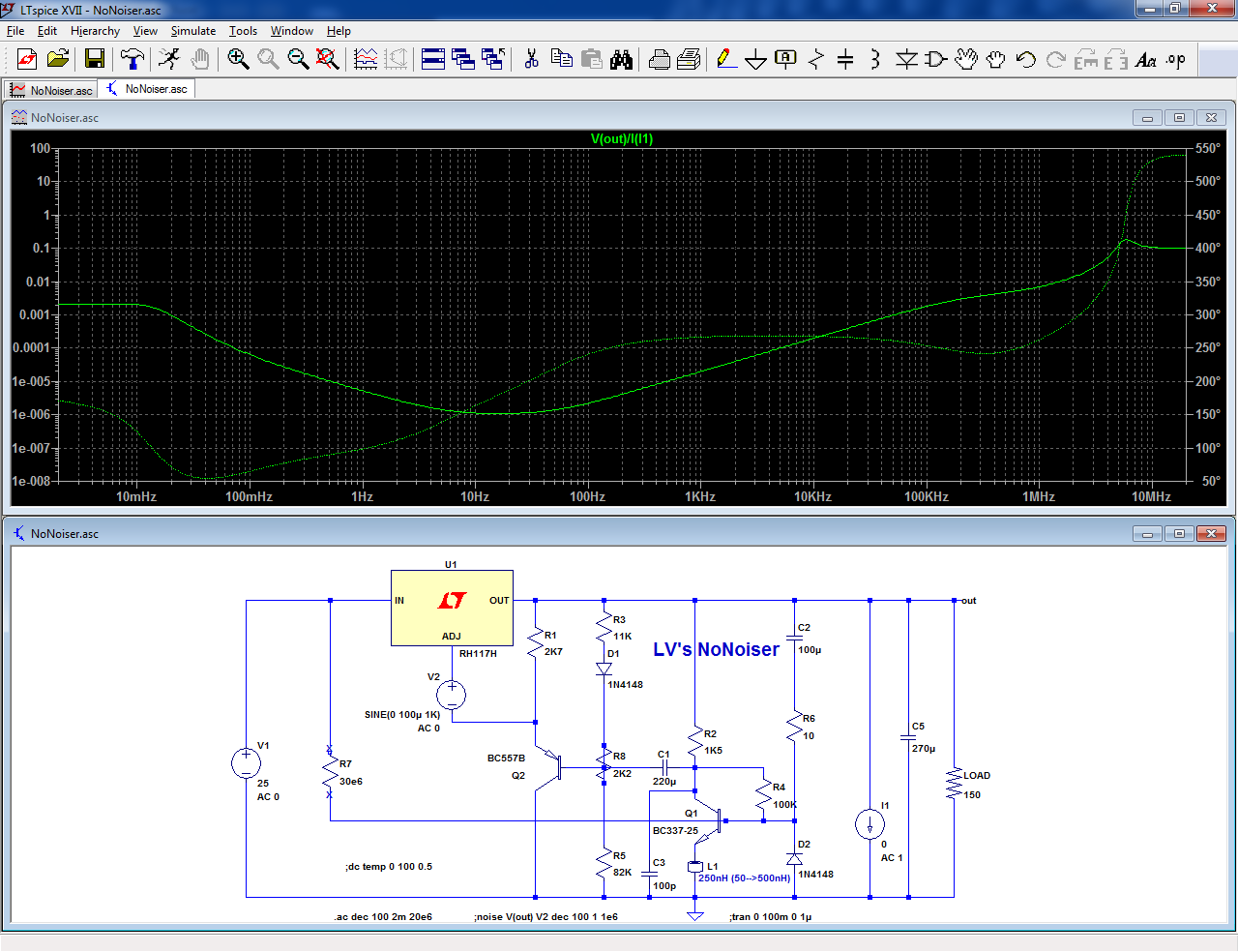

Remarkable invention, I have an application in mind right now!

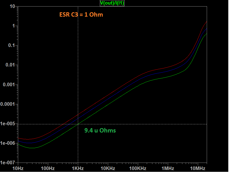

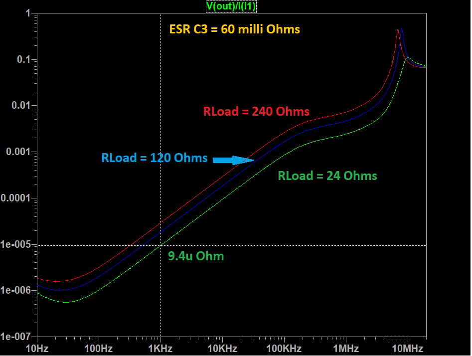

I just ran some simulations of output impedance, stepping the load resistor 24, 120 and 240 Ohms, using only 10uA AC load current (rather than AC=1).
The ESR of C3 might need a little bit of help with some external resistance, i.e. additional snubber resistor (the Panasonic FC I use are around 83 milli Ohm). Not a spot in which to use a Silmic or Muse.)
AFAIK, small signal is small signal, even if you decide to use AC=10kA, and the circuit is biased in the µA level (but I could be wrong, or there might be some unexpected LTspice quirk).
This means that the scales or units might change, but the effective result should remain unaltered.
Things are completely different for DC sources, of course.
In the real world, I used a reasonably low stimulus, because at higher levels non-linear effects would begin to kick in.
Edit -- I wish that WJ had taken pix of his impedance measuring test setup.

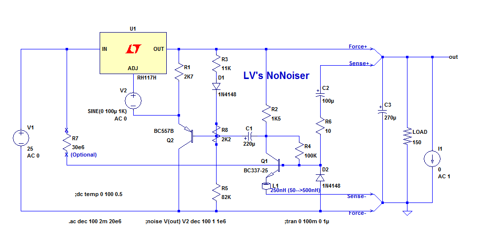

I see the designator C3 only in the bootstrapped version of the nonoiser -which has not been physically tested- , and it seems that ESR there would have very little effect unless it is really excessive.
If you mean C5 (output cap), the one I used in the sim has 0.1 ohm series resistance, and the physical one is an organic polymer having a measured ESR of just 20mΩ @10kHz.
Of course, when you arrive at this level everything counts: the actual losses of the compensating ferrite bead, the layout (including the all-important mutual inductance effects between "tracks", or conductors in the case of my proto), the exact components used, etc.

I have made a sweep between 0 and 20MHz.
Under small-signal conditions (20mApp), I noticed some impedance quirks in the MHz range, but nothing comparable to the sim.
Upon closer examination, I realized that the output layout was not optimized for high frequencies: in particular, the stimulus injection was made 2~3cm away from the output bypass cap.
When the injection point was moved directly to the cap, all the oddities disappeared.
There was a steady increase of the impedance with frequency, but it was completely uniform, and beyond ~10MHz, the behavior was dictated solely by the bypass cap and the layout: it remained identical with or without power applied.
I also made a test for large signal conditions: Ipp~=Iout DC.
When the frequency reached ~400kHz, the error amplifier began to saturate and lose the control, resulting in a DC shift of the output and residues appearing.
This behavior could be mostly eliminated by connecting a 100pF cap between the collector of Q1 and the GND:
attachment.php
This very slightly increased the high-frequency impedance (between 100kHz and 10MHz).
In practice, for audio applications it is not necessary to do anything unless the supply is used for very special purposes, like a class B amplifier for HF magnetic loop systems (used in simultaneous translation) for example.

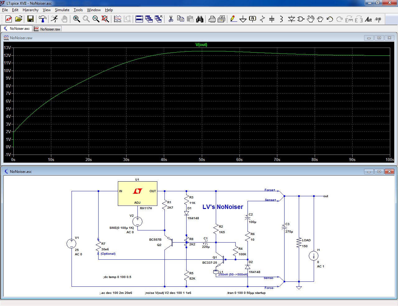

I have a question about nonoiser. I have made TinaTI simulation and startup time is quite long. Output voltage slowly rises.It takes around 25 secs, then it goes overshot(1V above set value), then falls down and after 110 secs it reaches set value. One my friend got same results and he's really expert in TinaTI and knowledge of electronics. Is circuit supposed to work like this or in reality startup time is faster?
FWIW -- I am seeing the same result -- very slow startup time.

Yes, that issue (or feature: some people would be ready to kill beloved ones just to get a slow-start!) has already been mentionned: it is part and parcel of the nonoiser and to a lesser extent of the denoiser.
It is caused by the large time constants required to eliminate noise well below the subsonic frequencies.
The overshoot is caused by the (relative) proximity of the poles of the correcting amplifier.
Opting for different values of C1 and C2 could alleviate this particular aspect, but as always there would be other tradeoffs: even longer settling time, or reduced VLF rejection.
A 1V overshoot seems tolerable (to me).
If the startup time is an issue, it can be sped up by adding non-linear components to force initial conditions, but the task is not going as simple as it seems.
The overshoot could also be eliminated by strategically locating a zero in the response, but given the time constants involved, it is probably not going to be as simple as it sounds..
I will think about it anyway
