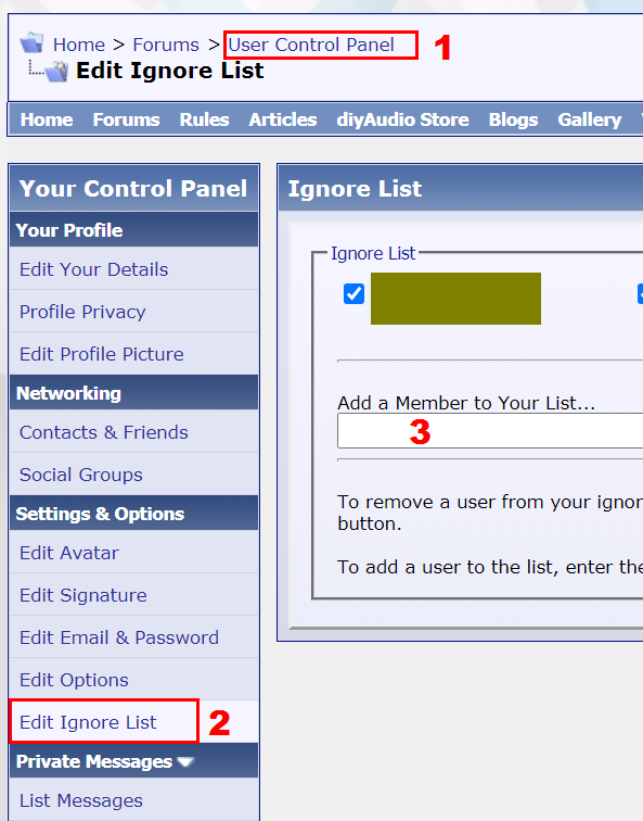

This might be a good time to remind members about a Forum software feature called Ignore List. Here is how you access it from the User Control Panel -- that's a link marked "User CP" at the center top of this page and every Forum page.

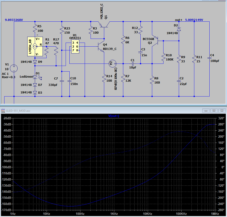

This design brings improvement in PSRR, operating voltage range, load range, dropout voltage and denoiser circuit efficiency, according to the simulation results.
  • PSRR is 175 dB. Probably you have the same with LM317 + denoiser?
  • Operating voltage range is 10 to 60V or even to 100V
  • It operates at dropout voltage from 0,25 V or less, and works at full PSRR @ 0,5 V
  • It can supply at least 5 A
  • Single Bjt denoiser circuit here brings >50 dB of improvement, compared to usual 30 dB
  • Even without denoiser, this design provides 110 dB PSRR
Do you spot any difference to the LM 317 with denoiser?

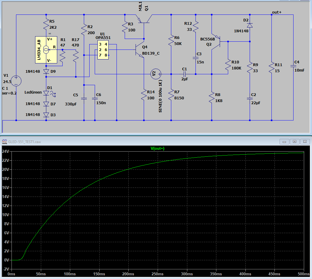

hi tombo56, have you tried simulate the startup behaviour of this circuit?
Not till now, as it was taking eternity. With some value changes it is working fast. It helps to add some internal resistance to the voltage source. C1 was too big and was shorting voltage divider, consequently preventing proper startup. It is a “relict” and can be as small as 1 uF. With values from 1 to 3,3 uF we can even adjust how soft is startup. PSSR in low frequency range is still good.

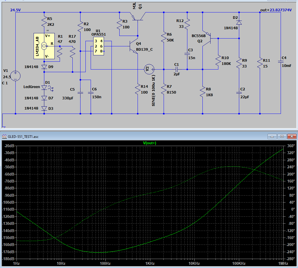

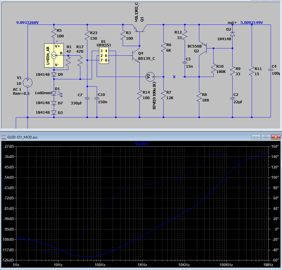

Minimal input voltage is 10V as that is min. opamp supply voltage, but min. output is < 5V. If LTSpice is to be believed, it works almost equally good at 5V as at 25V or 50V. I like fact that, even without denoiser circuit, it delivers very good PSRR, output impedance and transient response.
