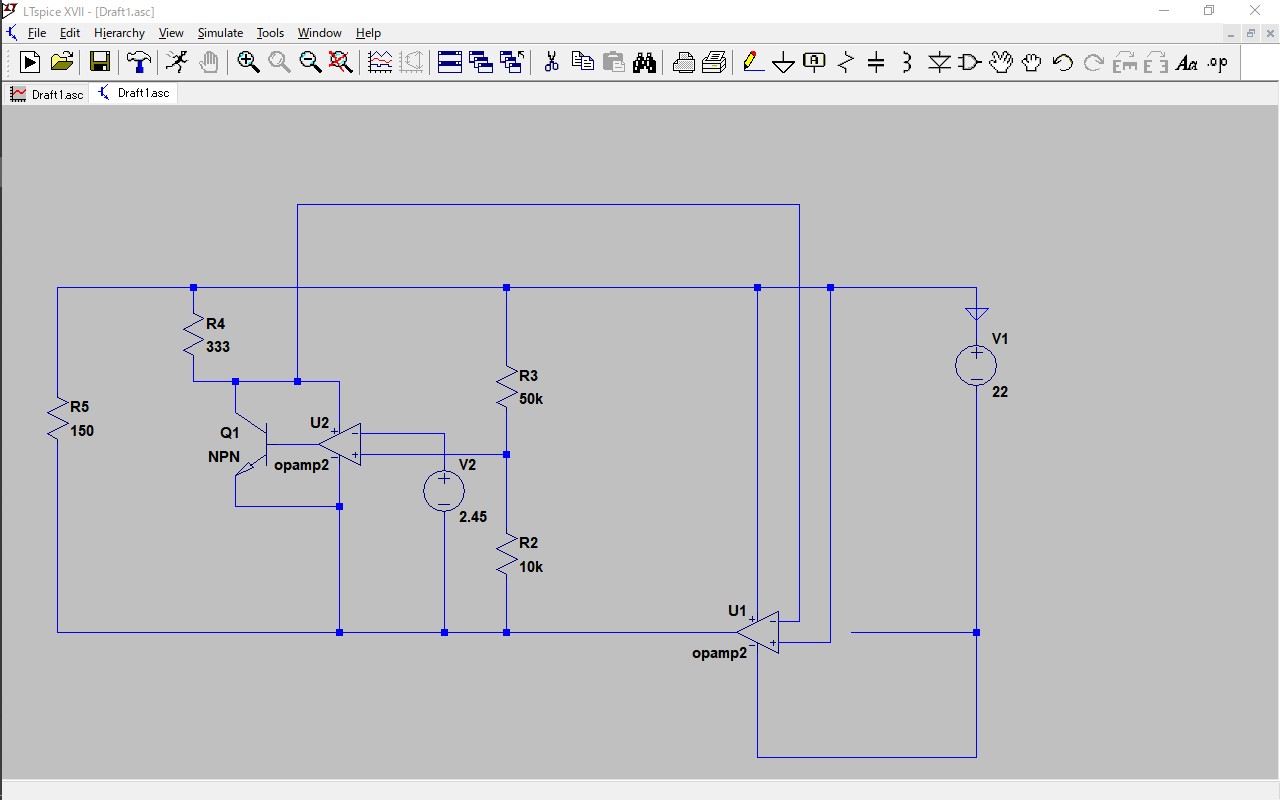

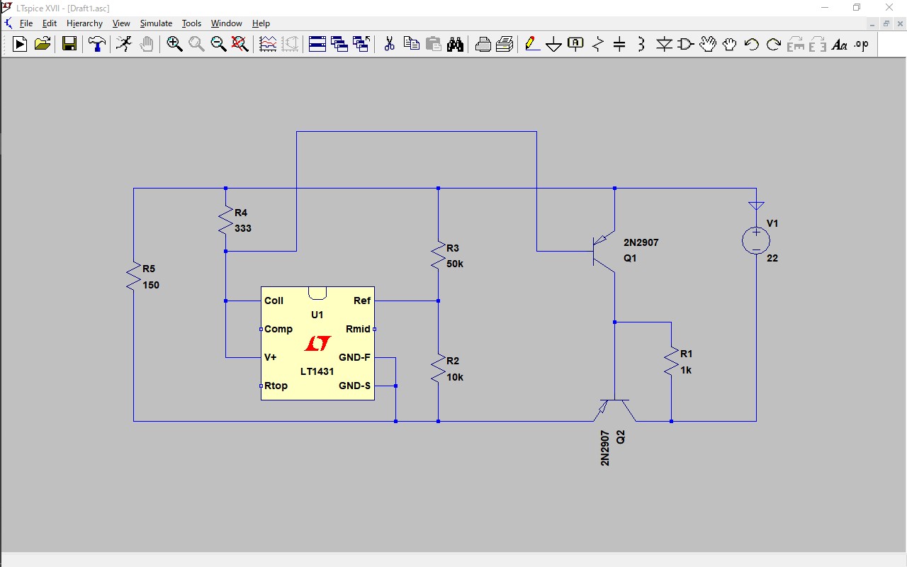

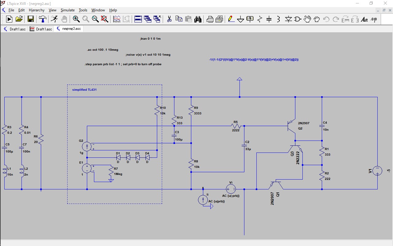

Hi, I had posted negative regulator circuits but got no attention, it might be explaining the theory of operation was not enough. Thus I post basic DC topological circuit first.
The first picture is it. LT1431 has extra pins compared to TL431 but the operation is not so different, I used it just as TL431. So, the anode is tied to the output, cathode goes to the noninverting input of error amplifier / pass transistor. The ref pin goes to a voltage divider, remember, the voltage between ref pin to anode pin is about2.5V, so the voltage between R2 is 2.5V then R3 will be 12.5V, totally 15.0V which is the output voltage.
How is this possible? Well, in the TL431's datasheet you might see an equivalent circuit diagram comprised of a opamp and a NPN transistor. In the second picture, TL431 is replaced to that model. You can now clearly see this circuit has 2 stage feedback loop, negative and positive feedback. Negative feedback has no divider thus feedback ratio is 1, positive feedback has a divider to set the output voltage. This topology is very similar to LM317 and LM337, output voltage is set by equation Vref*(1+R3/R2).
The third figure is an example of an error amplifier / pass transistor. You need to add compensation for stability because this circuit has at 2 HF roll off in TL431 and 2 or more in the discrete stage.

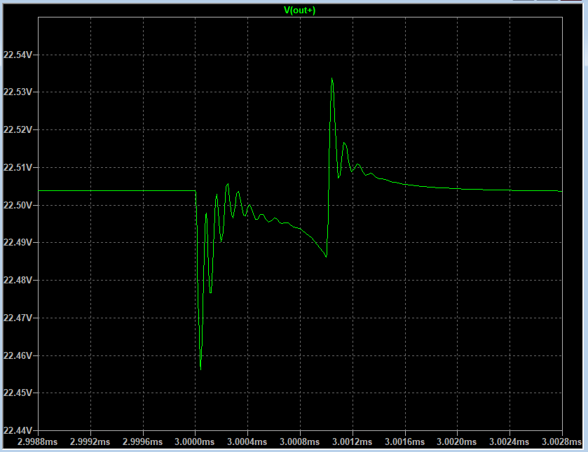

Indeed, fast transient loads are dreadful, especially at unloading, this is where I see stability troubles.
Can you look at stability of the positive regulator in post #1092 with the upper resistor moved from cathode to output.

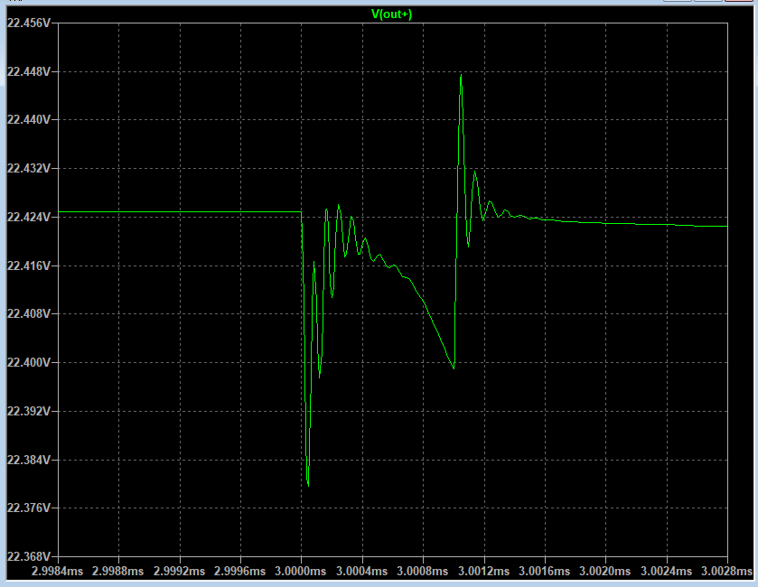

Regulator stability is generally the same for voltage divider connected to the input or output. Here is transient response while loading regulator with 1 kHz square wave 2A load with 1uS Trise & Tfall + 1 A constant load, shown at loading point. Unloading point is the same, with larger voltage swing.
First two pictures are for voltage divider (R2 & R3) connected to the output (Q3 collector) and with different R19 values, displaying damping effect. Second two are for voltage divider connected to the input or TL431 cathode.

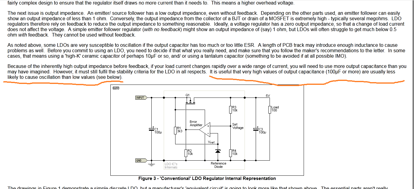

As to high values of output capacitors there's a BUT outlined by ESP and although it looks like a very different issue it's basically the same issue as with loading some MC carts.Their manual advise for maybe 1nF loading, 2nf will sound like s...t and when you load them with a 22nf capacitor they suddenly sound better than the manufacturer's recommended value.
You can't maybe use an LDO with a 10uf low esr cap but you can safely use it with a 10 000uf low frequency ripple, high esr capacitor most of the time...
For more information: LDO Regulators

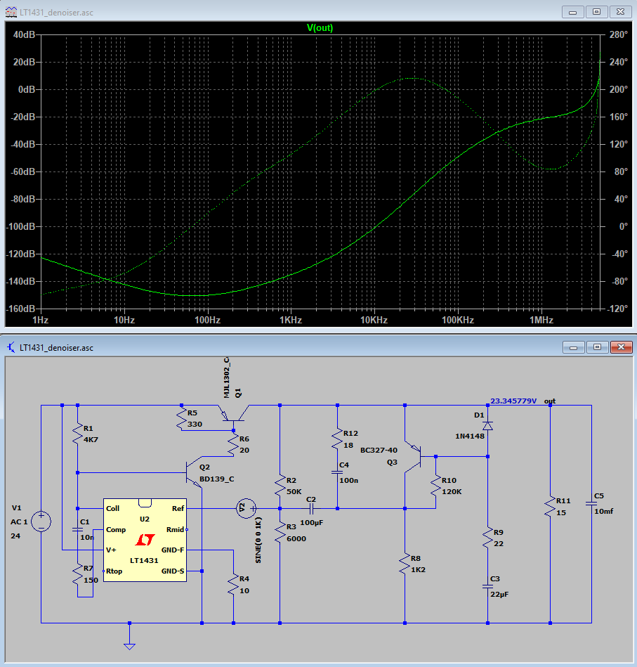

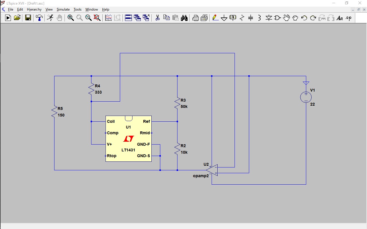

Thank you Shinja very much for pointing out at LT1431, and especially for the negative voltage variant. This opens new interesting possibilities. With denoiser circuit, which positively affects stability, it is about the same stable as version with the TL431. We will se about negative version.

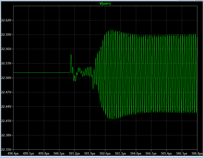

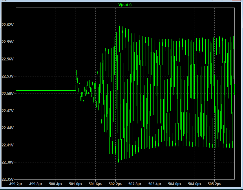

Here is transient response while loading regulator with 1 kHz square wave 2A load with 1uS Trise & Tfall + 1 A constant load, shown at loading point. Unloading point is the same, with larger voltage.
Doing about the same, I had something strange. With some output capacitor ESR ( presumably bad values ) a spike occurs when unloading but not when loading.
This using Trise & Tfall 1uS. Then I discovered the spike doesn't occur when using Trise & Tfall 0.1uS.
With steeper edges, the system looks more stable.
I cannot explain this weird behavior, it doesn't make sense, I am loosing faith in evaluating stability with .tran simulation.
I better count on open loop plot and phase margin.
I had a look to the LT1431 datasheet. It has all the same characteristics as the TL431.
It is the same with more pins, it can do the same ( it even has a 3 pin version pin compatible to TL431) and it can do more. More pricey, too.
