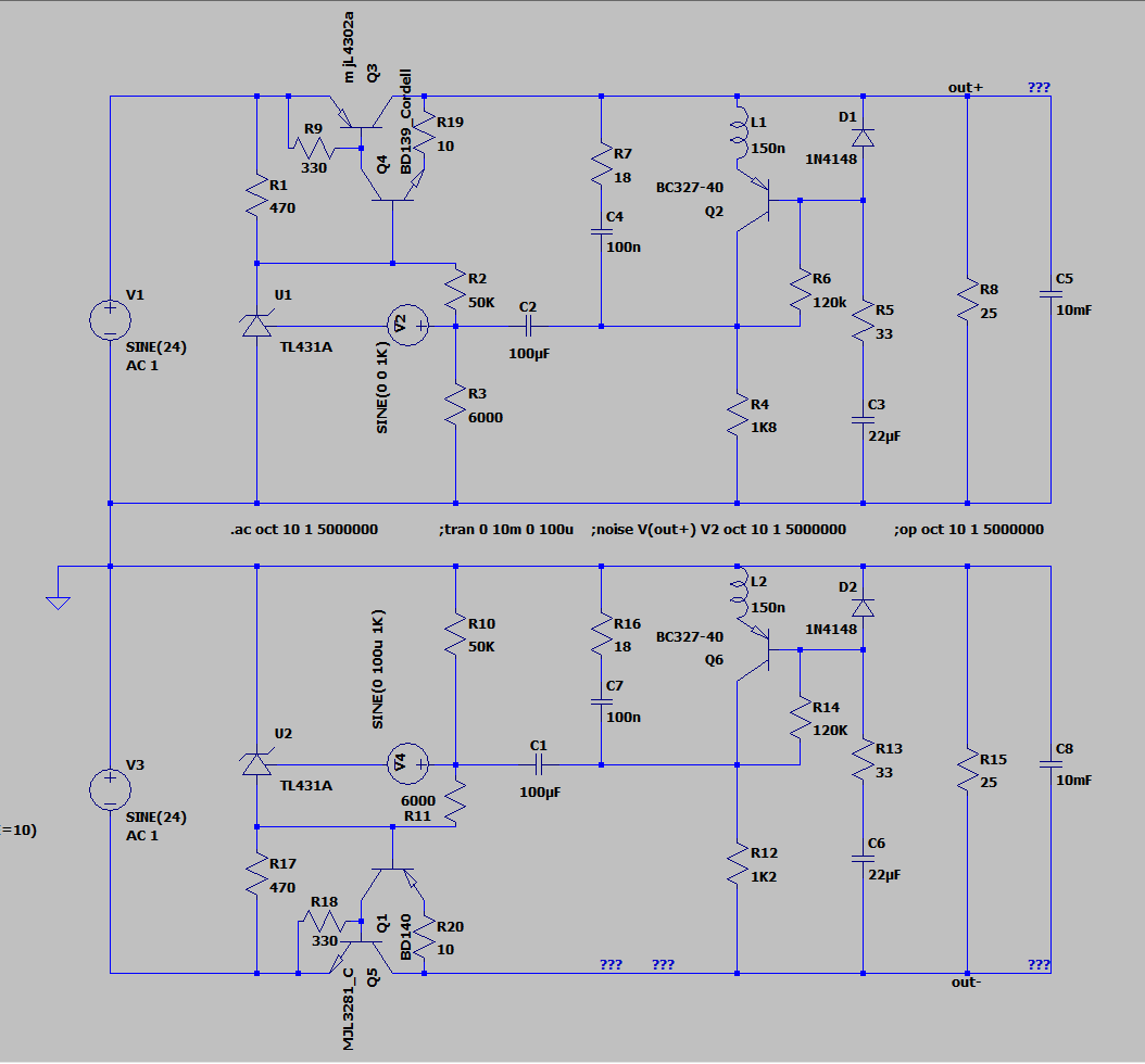

D-Noizator: a magic active noise canceller to retrofit & upgrade any 317-based V.Reg.
My goal is explained in the post #1092. Based on the actual chosen semiconductors, some part values may differ and schematics may be altered. As said, it is close enough.
With schematic in the post #1092 the load regulation is lost when compared to the positive regulator. From this schematic load regulation is better by moving the lower resistor of the resistor divider to the anode of the TL431 ( instead of the PSU output ). This is proved in the posts where I give the equations for the output voltages in these different solutions, post #1093 #1094. Why it is better is clear in the equations.
Moving this resistor gives no loss about the benefits from the denoiser.
As for the current mirror, unanswered question is why to use this implementation? What are the benefits, how is load and voltage regulation? In my intended usage scenario with 1,5 V headroom this works weird.
In the attached simulation, positive and negative regulator results are well matched.
The current mirror has the potential to give a negative regulator that has exactly the same behavior as the positive regulator. This is true assuming an ideal current mirror. This result is confirmed in simulation using a 2 transistors current mirror, where I get very near the same results about load and voltage regulation, PSRR, Zout, noise.
Stability from simulations is highly questionable, whatever solution. Fiddling with component values to get stability can be misleading.

You are using the TL431 as a zener in both regulators.
Then load and voltage regulation is governed by the Vbe + 10 ohm of the driver transistor. Why you added this 10 ohm ? ( re is proportional to Ic, 26 ohm at Ic = 1mA).
Have you looked at the max current and power at the TL431 that occurs in the case of: No load on the PSU and max mains voltage ( +10% ). Life is easier for the TL431 at max load that gives a max of unregulated voltage droop.
You added an inductor at the transistor of the denoiser, a bead I presume, isn't redundant with the compensation at the collector, do they add ?
It helps prevent oscillation and ringging if regulator is "smacked" with high and fast transient load.
It works together with RC compensation in the same direction achieving slightly better result.
