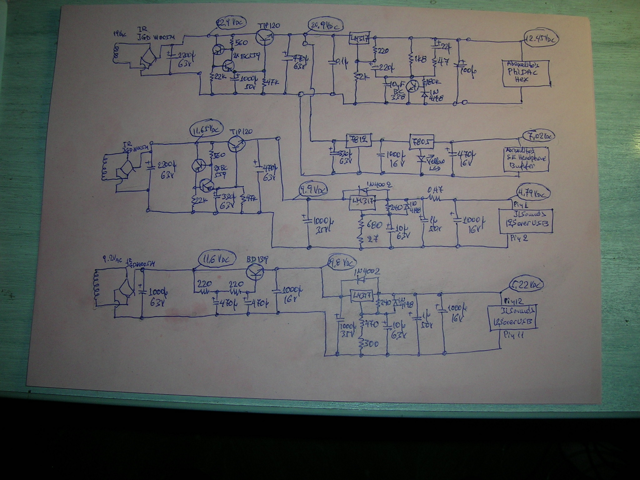

At the moment I'm thinking of using AK4458
Have no experience with that DAC. But according to datasheet AVDD in this case should be separate from DVDD. If it works similar to AK4490 then the VREF supplies are critical. So you could use LT3042 on VREF and e.g. NCP703 on other supply pins.
I'm from Europe so I'm tied to Farnell or TME and neither have the lt3042/5 in stock.
I was thinking of using this circuit for Vref:
Seems to measure very good and Vref total draw is around 1mA, should be no problem. I can take the voltage from +5V reg, the filter cleans it up, and I can put the sense line directly on the Vref pin.
I found the circuit here: Capcitor type for Vref

Thing is, they'll pile up. I need +-15V for opamps, +-5V for pga2311 volume control, +5VDC and +3.3VDC for the digital side of things.
Of course they pile up if you keep using mediocre parts you will have to keep building newer stuff again and again The shortest way to go from A to B is a straight line in general. Aim for the highest, choose the best available at that moment that you can afford and design your DAC accordingly.

In my opinion Elvee's original idea is great. I have simulated, built and tested several versions of the LM317/337 denoisers as originally intended: add-ons to existing LM317/337 power supplies. However I have not really understood the craving to use these to build new LM317/337-based power supplies as better alternatives exist.
I have also found out that denoisers are prone to oscillate depending on e.g. output capacitance and ESR. Due to this building & using these denoisers without proper measuring equipment does not guarantee expected results.
It has been stated many times, and I also knew this 6 years ago when I built my first lm317/338 power supply. The output cap needs to not be low ESR type. This is typical to lm317 not to Elvee's circuit. Any normal lm317 circuit requires a normal (higher by today's standards) esr output cap.
