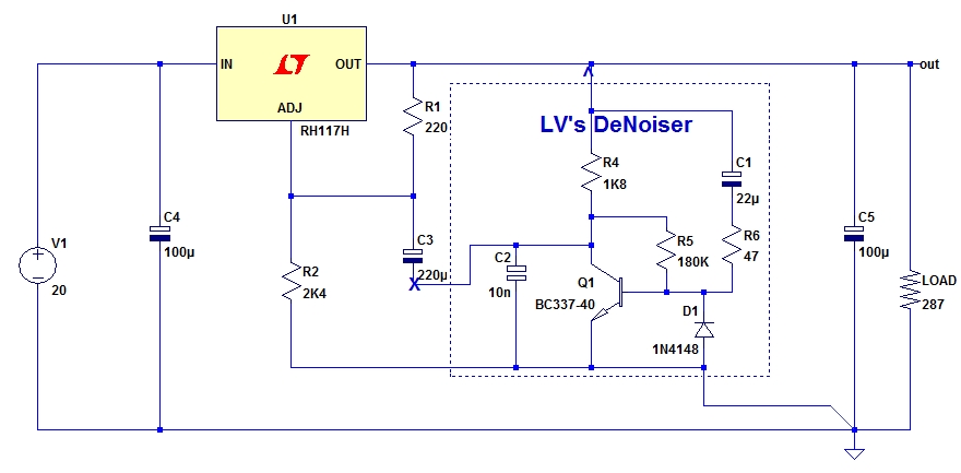

D-Noizator: a magic active noise canceller to retrofit & upgrade any 317-based V.Reg.

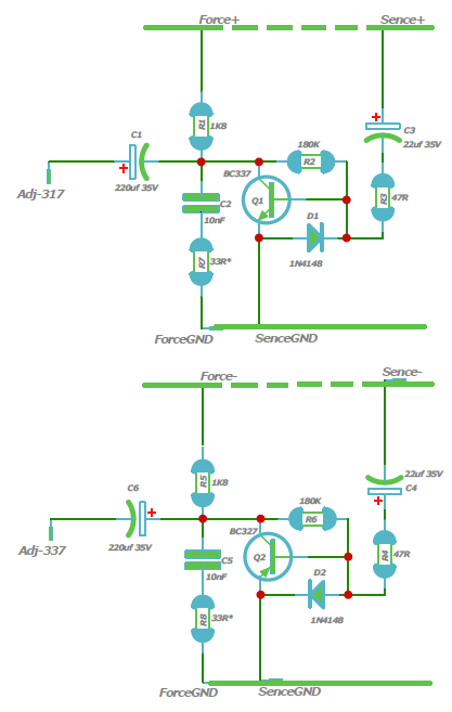

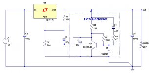

My mistake, i followed the LV No-Noise schematic for the Kelvin connections...please correct me if this one is not suitable
In fact, the add-on denoiser does not have force terminals: all the power is handled by the 317/337 and the GND coming from the supply, they provide the "force".
Thus, you only have sense terminals to deal with, and to mimic a Kelvin-like connection, you just have to connect them as close as possible to the point of load.
This is the corrected version: on the GND side, a direct, local connection between the compensation network and the emitter of the transistor is compulsory for stability.

On the "hot" side, the so-called "force" and "sense" (none is force in reality) terminals could be separated: it does cause problems, and having the 1K8 resistor connected to the regulator could give a microscopic advantage in terms of VLF impedance, but it is so tiny that I don't think it is worth adding a connection: just 3 connections will give an excellent performance and reduce the risk of confusion.

I had forgotten that "magic" 33R resistor. I imagine it was abandoned because it didn't really improve things much.
I just simmed it, and the only thing it seems to affect a little is the impedance curve, but for the worst.
Is there something else it's supposed to do?

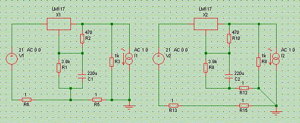

Another thing that using the Denoisator external board could bring an improvement, according to TNT audio excellent series on power supplies, is separating the parts connected to the 317/337 adjustment pin, that can now go to a ground point separate from the input ground, a principle that was also used on the Jung regulator.

I was just noticing that to fulfill the separate grounds principle mentioned above, the adj pin to ground resistor would have to be connected to the Denoisator ground too.
A simple thing to do, and a good way to further improve most 3x7 regulators you will find, where that resistor is usually connected to the "common" and only ground, sometimes even a ground plane.
Am I exaggerating?
Am I exaggerating?
Yes and no: in AC, the correct connection of the denoiser (as downstream as possible) will swamp any effect of the resistor connection.
If DC is also important (generally not in audio), moving the resistor downstream too will improve matters, but on the "hot" side, there is nothing you can do: moving R10 downstream will degrade things, not improve them meaning you are stuck with a 50% DC improvement.

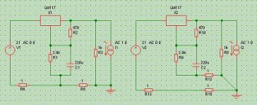

Sorry, but what R10 are you talking about?
The resistor I suggested to connect to the Denoiser board was R2, and the arrangement to ground is the one I'm enclosing.

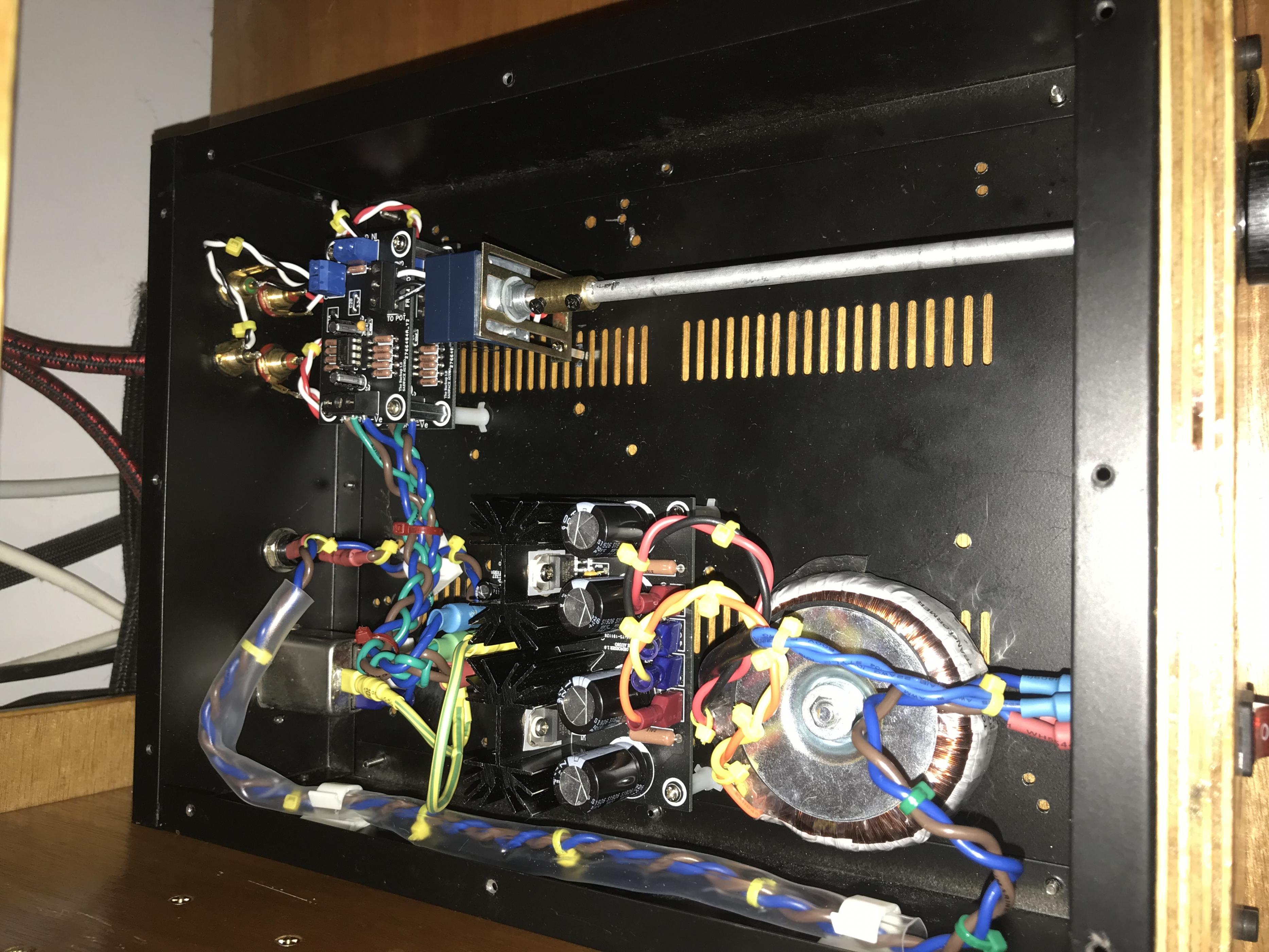

G'day guys,
From the feedback it seems as though Hicoco's board meets all of the necessary criteria so I won't attempt to duplicate the work. A very nice and tidy layout too. I doubt I could do better.
I will be very interested to see what feedback comes from the those who ordered boards off my gerbers.

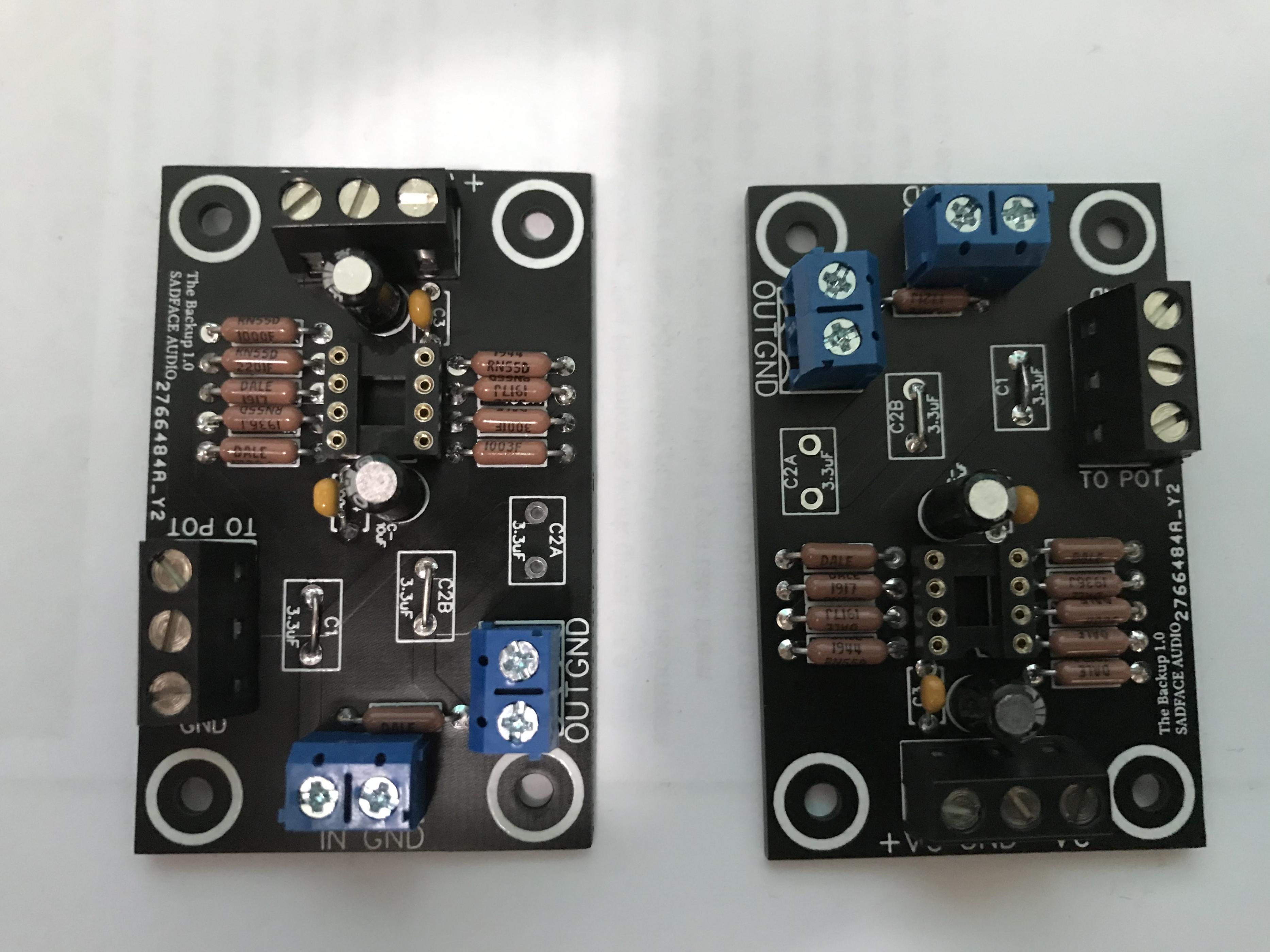

I've had this guy making sweet noises for a month or so now with no issues. I however, lack any test equipment other than my 30 year old Fluke 25 and my ears.
If somebody has more appropriate gear like a good scope to poke around and check for instability I would be quite appreciative. Real world noise measurements would be fascinating.
Sadface,
Can you describe what is the regulator is powering on your photo?
A line preamp? Can you provide more info?

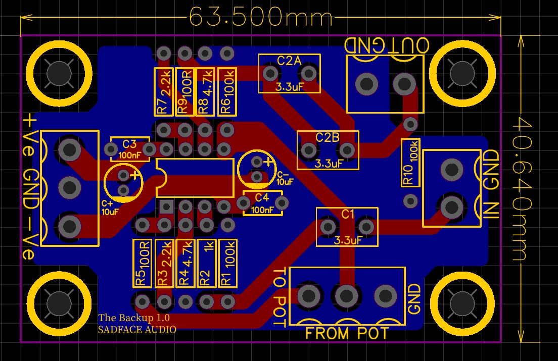

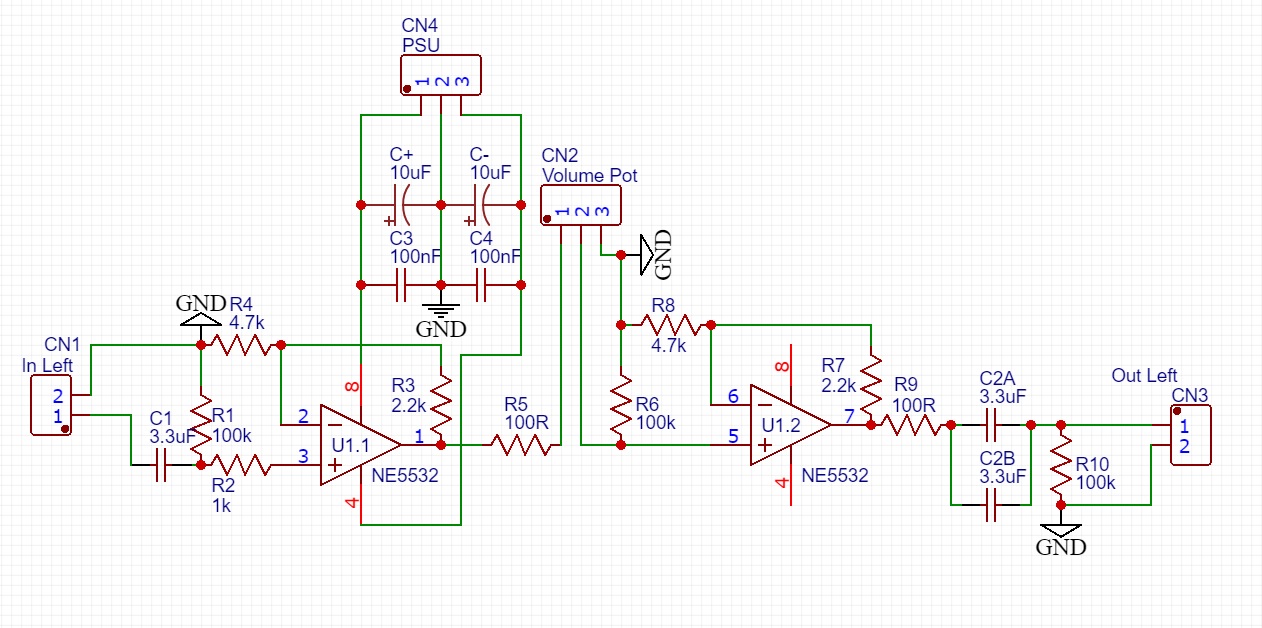

Hi Carlmart,
Bang on. Its a line preamp. I wanted a simple solid state backup preamp that I can throw into my system while my tube preamp is on my bench for modification.
I wanted a nice small footprint as this old chassis is not large so I designed a single channel preamp board to stack on top of one another.
Nothing too fancy. A single LME49720 using both halves of the opamp.
Gain for both stages is set to 1.733x for a total gain of 3x minus the loss in the volume pot nested in between the 2 stages.

I originally designed the board to use an NE5532. However due to the use of the LME49720 I was able to omit the coupling caps.
I also found it necessary add a low pass filter on the input by soldering an extra 330pF ceramic cap on the underside of the board.
Eventually I will redesign the board to properly accommodate the input low pass filter. It has also been suggested that I add some E-562 constant current diodes across the supply rail and output pins to force the outputs into class A.
