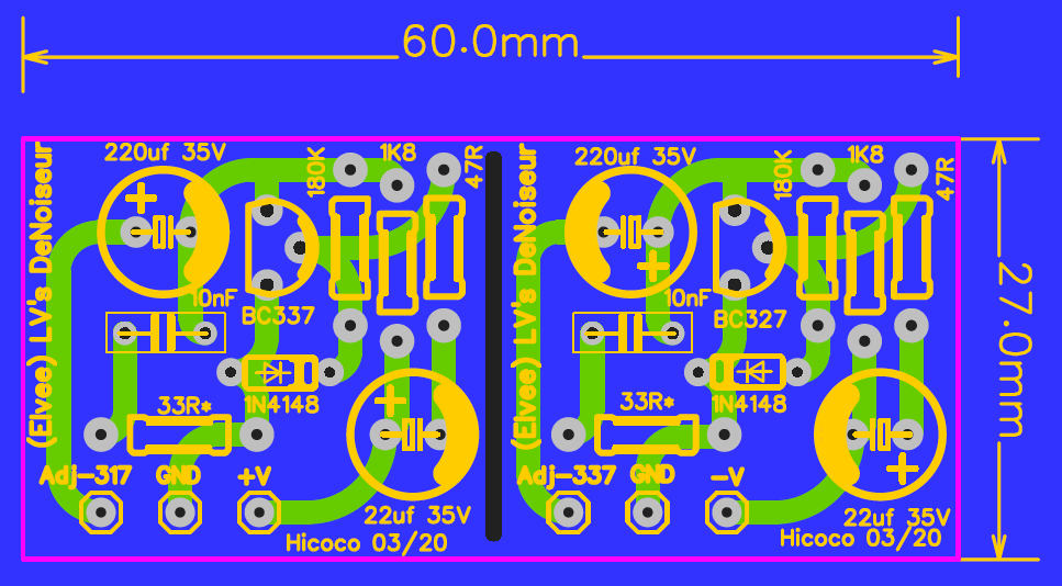

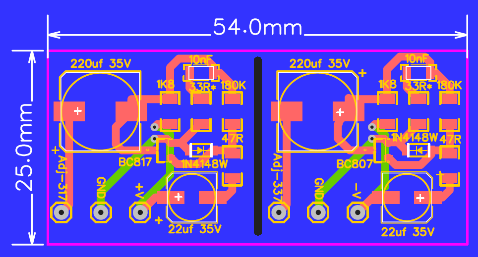

YEAH!! Thanks!! Post the gerber files and I'll be the guinea.Smaller TH
Perhaps...Hicoco, if you don't have the gerber files for the smaller (60 x 27mm) retrofit denoiser PC, perhaps we can get Sadface to generate them?
I will order PCB and test it before any post
Excellent! Thanks again for your efforts!....I will order PCB and test it before any post
I received my Elvee/Sadface boards (for the whole LM317/337-with-denoiser circuit) from jlcpb today. Hooray! They appear to be very well-made. I will gather parts and assemble this week, and report back on their performance as best I can; I lack the ability to test for -100 db noise, however. But I can scope the output.

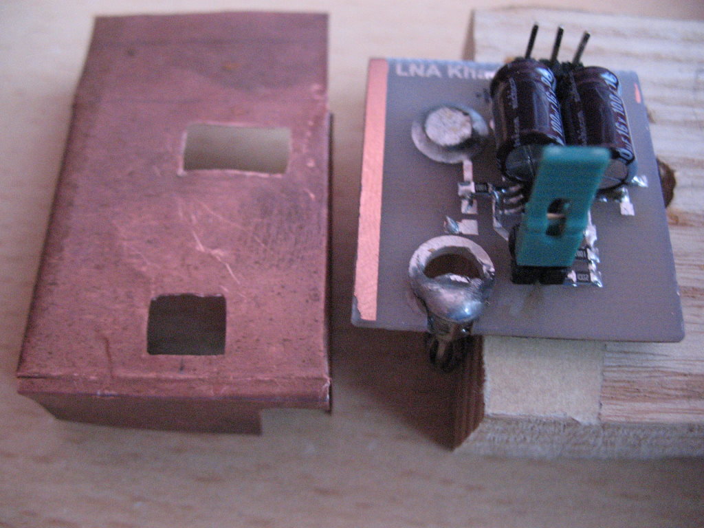

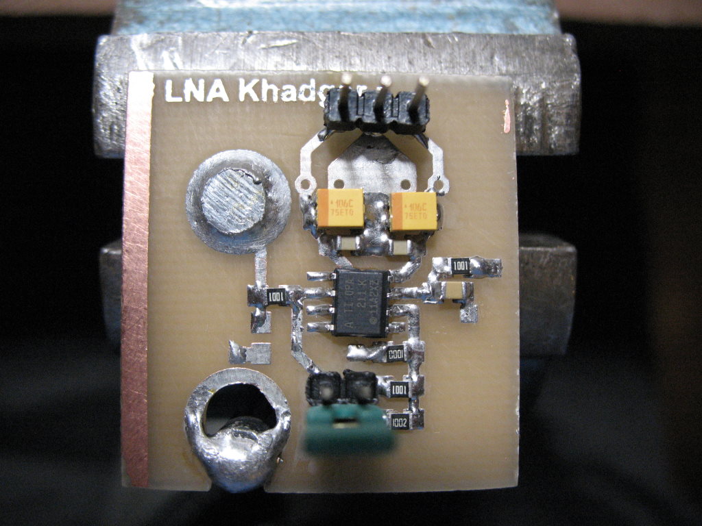

You can build some simple LNA like Elvee suggested to me some time ago, it will help you a bit to see what's going on even on oscilloscope with 5mV/div and if you have 2 or 1mV/div then you should really see what's going on. I builded this one some time ago and i even mentioned it in this topic. Pretty simple design, noise is around 24,5uV, in simulation it should be 21uV. I used OPA211 cause i had it at home, it's SMD so tracers can be really short, i made it x10 and x100 that is selectable with jumper. OPamp decoupling capacitors are 100n//10u//100u.
LNA is powered by 2x9V battery in separate box and there is 100uF decoupling in that box as well.
Thanks for the tip! But...that's a $7 opamp! Do you think it would work OK with an LM4562?You can build some simple LNA like Elvee suggested to me some time ago, it will help you a bit to see what's going on..... I builded this one some time ago and i even mentioned it in this topic....... I used OPA211 cause i had it at home.
Did you make that pcb yourself? What technique did you use to make it? Traces seem quite clean, not ragged.
LM4562 has around 2.5x more voltage noise then OPA211 i would probably used some other OPamp but i had few of these in my stash when you could get free samples from Texas Instruments.
